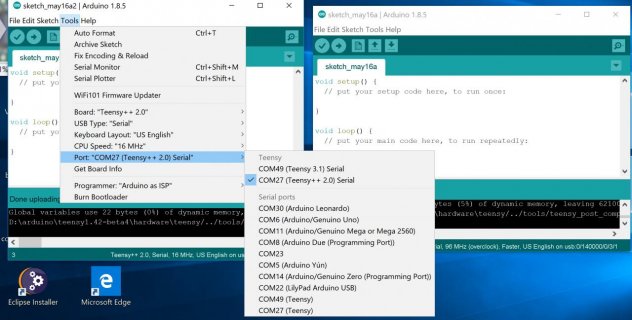

For some reason I thought this version supported multiple teensy's connected to the same pc. So I tried that and came to some "unexpected behaviour".
I wanted to do the following setup in windows 10:
Run teensyduino 2 times. one for my teensy 3.1 and for for my teensy2++
Compile both then run upload in on and then upload in the second. This simply didn't work. The Teensy loader nearly always want to upload to the wrong board. It did succeed once but then it turned of automode due to to fast answer.
This may all be me just doing the wrong things, but if so a pointer to the right way would be appreciated.
When testing I noticed some strange behaviour that may be as designed but is not compliant with the Arduino way. (Edit: I stand corrected it is the Arduino IDE way :-s )
When I change the board from teensy2++ to teensy 3.1 (or the other way around) in one window all window instances are changed to this board. Arduino IDE has a boardsetup per window.
This probably did not help me in doing the right actions for uploading :-s

Each Teensy must have a separate IDE instance open, must not be of the same instance!
If you have 2 or more teensies with the same hardware version (3.5 and 3.5 for example), it's preferred to do COMPILE only in the IDE, and when compile is done, push the program button on the one you want programmed.
if all instances change at same time, you have only a single instance, not multiple, thats where the problem is.
On your taskbar, try clicking the Arduino icon
You should have 2 separate IDE windows open in taskbar, (NOT COMBINED), then it should work

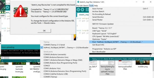

Indeed that was part of the issue.
When starting 2 teensyduino's I could upload to the 3.1 but the upload to teensy2++ fails because it tries to upload to 3.1
I had to unplug the 3.1 (I also closed teensy loader) to get the upload to work
Strange, now it is working fine. It lookes like the teensyloader missed the teensy2++ at startup and did not recover.
I only have one loader open.
It seems to work but it is unstable. Sometimes I have to unplug the teensy that works so the teensy that didn't work starts working.
The correct 'Tools / Port' has to be selected in each IDE - and both should be one under the 'Teensy' section. That ideally lets the TLoader know where to send the code.
@defragster
That is what I do.
My test may seem simple but I'm kind of on the extreme with 12 arduino's connected at my system at the same time as I'm doing upload tests.
I see windows making a mess of the com ports (assigning the same com port to 2 different devices) and sometimes I see a teensy in bootloader mode in the teensyduino list.
My current understanding is that is works but it is unreliable in windows 10. unplugging the "working" teensy makes it work again.
Here you can see the bootloader issue I see quite often and the failure to teensy2++.

From the discussion here I learned that there is now a requirement to have the com port set correctly. IMHO not explicitly needed in this test case (2 different teensy types) but very needed when uploading to multiple teensies of the same type.
If you are working with teensyduino and do not mess with the com ports; teensyduino sets things right. Even if you upload a different sketch with a different usb type resulting in a different com port.
But...I messed with the com ports after the upload. And then things start going wrong. See image with strange port name.
I also added a image where you can not see the teensytype in the port list which added to my confusion.

May I suggest to change following in the error dialogue: "you must configure the correct board type" to "you must configure the correct board type and com port" and "to change the board configuration in the arduino IDE use tools->boards menu" to "Changing the board configuration in the arduino IDE using tools->boards menu will do so"
Sounds good. I'm putting this into beta5, except for "com" which is Windows specific. This message is the same for all 3 systems. Hopefully just "port" will do?
