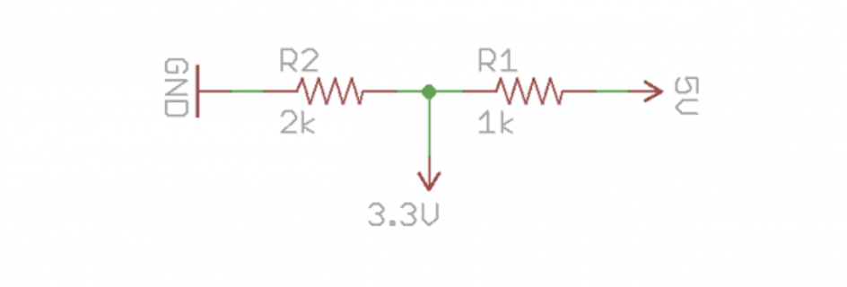

However, when I stripped down my basic working encoder code to test with Teensy 4.0, I'm not registering any changed when I spin. The one issue I may be having is the addition of two simple separate voltage dividers at each of the encoder digital pins to bring the 5V signal down to 3.3V for the Teensy inputs (using a basic 2k/1k divider). Image attached for reference. Ultimately, I'm planning to use a TXS0108E level conversion module, thinking this will help the speed. But I thought I could at least prove out my prototype with a simple voltage divider. Could this be why I'm not registering any changes when I spin the encoder?
Again, I'm A/B testing here with an UNO, and the circuit/code works with the UNO (without the voltage divider), but when I wire the encoder output through the voltage divders, I can't get the Teensy to register any change with the encoder.

Are the encoder outputs open-drain and the microcontroller's inputs intended to have active pullups? If so the pinMode calls should be using INPUT_PULLUP, and you can safely connect them without the voltage divider resistors.
(This would explain why you're not reading anything - the voltage divider resistors are much lower than the Teensy's pullup values, so they're effectively grounding the inputs.)

If the encoder is powered from 5V and open-collector, you only need a single pull-up to the Teensy 3.3V supply.
It it's output is push-pull you will need a divider from the encoder output to the Teensy - I can't tell from your diagram where things are connected - can you clarify this?

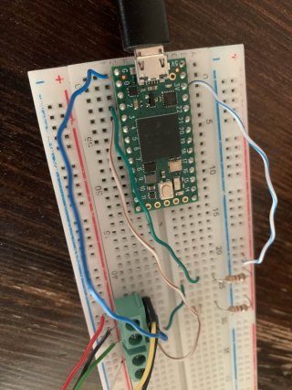

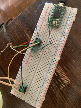

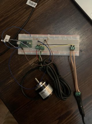

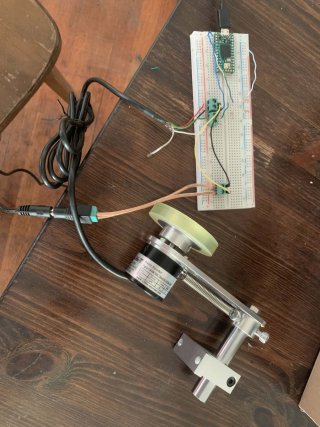

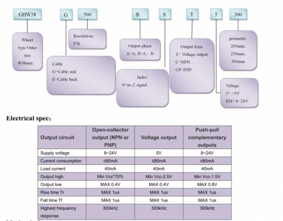

Hello all, thanks so much to everyone for their responses. I am an artist, and will often get a kludgey thing working, and then use it over and over and never look back. Yes, I didn't know about the "input_pullup", I had been under the impression from projects past that writing the digital pin to "HIGH" did a similar thing as engaging the internal pull-up resistor. I've updated my working code to use this (as well as the encoder library...). Also, having always used UNO's and MEGA's I clearly didn't understand how to level shift...! So @jmarsh was right, I was simply grounding the data lines.
I have everything working now on the Teensy 4.0, incorporating everyone's feedback. I'm using 1K resistors between Teensy's 3.3V source and the 2x data lines coming out of encoder before connecting to pins 2 and 3. I'm including some images and my working code for other seekers, included at the end of this post. I do have a couple of question remaining, if anyone feels inclined to humor me...
Question #1: What's happening with the voltage in the rotary encoder?

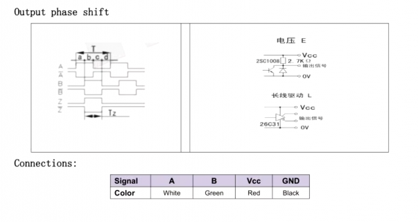

So the rotary encoder model is GHW38G200BSC824-200. It's a cheap one I bought several years ago online. I don't have the data sheet, but took some screenshots from the online seller's listing. It is an NPN open collector type, and needs 8-24V for power. The "data sheet" states the output High is "Min Vcc * 70%", which I took to mean 8v*.7 or ~5.6v. However when I connect the encoder to 12V DC (completely disconnected from the Teensy circuit) and meter the outputs, the maximum voltage I read on either output is 0.53v. I've also tested with a 9v supply, and the highest reading is 0.48v. So slightly lower, but perhaps negligible? Can anyone shed light on what's happening here? Since everything works as expected when I connect everything to the Teensy using the pull-up resister between these encoder outputs and Teensy's 3.3v, I'm assuming this is intentional. I just feel like I'm missing one conceptual piece of the puzzle...

I'm using the Teensy 4.0 to read 4x of these rotary encoders along with 4x IR photoresistors. Each encoder will have around 10' of AWG24 CAT5e cable between the encoder and the Teensy 4.0. Would anyone recommend considering additional components at either end of the cable run for stability?
Open collector means it never drives the outputs high, only low. When the encoder wants to output a "high" it just leaves the output open, disconnected from anything - so what you're measuring with the meter at that time is just a floating line. This has the advantage that the encoder can be used with any voltage IO by using pull-ups.
You don't actually need the physical pull-up resistors; if the Teensy's pins are configured for INPUT_PULLUP mode they will use internal pullups instead.
