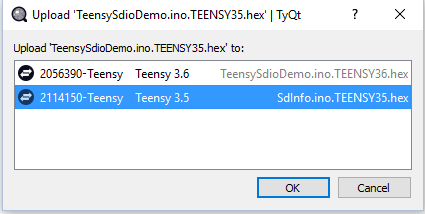

SdFat-beta now supports SDHC for the Teensy 3.5/3.6 on-board microSD.
Try the TeensySdioDemo example.
The bench, SdFormatter, and SdInfo examples can be run on Teensy 3.6 by defining the symbol USE_SDIO to be non-zero.
Many other examples will work if you use the SdFatSdio class in place of the Sdfat class and call begin() with no parameters.
