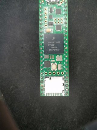

On Teensy or pretty much any circuit board, if you have a large current flowing an unknown path, one thing you can do is measure voltage drop along the power and ground. You'll need a multimeter with sensitive mV scale. Then just touch any 2 GND points. If you get 0, you can conclude little or no current is flowing between those 2 points. But if you get several mV, that implies a substantial current. Repeat all over the PCB to get an idea of where the current is really flowing.
This is a really strange case. Normally when a board goes badly and consumes too much current for things to get really hot, either the 5V power or the 3.3V power measures low. But you said you measured 4.7V and 3.3V. Normally when a large current flows, at least a few mV drops along the PCB. But you measured 0.0mV.
You also said the red LED doesn't respond in any way when you press the pushbutton. That too doesn't make much sense. If the U2 chip has 3.3V power, it really should respond somehow.
I really wish I had an idea for you, but so far everything you've reported sounds so far from anything I can understand.

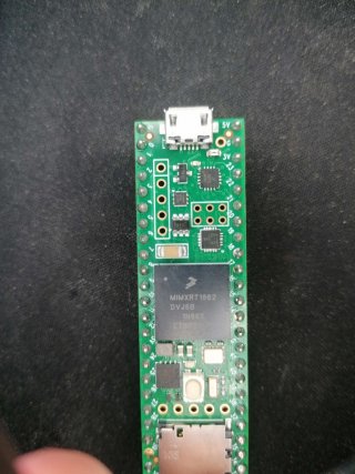

Maybe if you get someone to assist with a camera (even most cell phones can do this if you have a bright light) to get photos of the way you're actually measuring and hopefully good close ups of the hardware, perhaps something in the pictures will stir up some ideas? Just try to imagine everyone reading this thread. It's words only that just don't add up to any understandable scenario. Photos often work wonders on this forum, especially when the problem has some sort of misunderstanding where words always say the correct thing but a photo lets us see what really happened. If you do shoot photos, please try to have someone else work the camera (phone?) while you made the measurements and small details like where the wires touched so we can see how you measured and what was really appearing on the multimeter. But even that seems like a long-shot at this point.

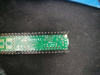

I attached some images of my teensy 4.1
I also cleaned the board with some chemical pcb cleaner to make sure no dirt shorts somewhere.
I measured again and still have a voltage drop of 0.0mV over all GND pins together and/or the 3.3v pins together.
Measuring from 3.3v to GND results in 0.0mV. And also I saw 16-19.5Ω from 3.3v to GND regarding on how hot the pcb is when turned OFF! When turned ON it drops to 0Ω.
Yes I know some header pins are not soldered on properly

You can't measure resistance when the circuit is powered up. Measure the _voltage_ when a circuit is powered.
19 ohms is not a hard short, suggests a failed semiconductor, not a metal-to-metal short circuit.
Hey Unhappyman, are you still unhappyWithoutU4?
That U4 would be the first one I would unsolder to see if the 3v3 short disappears.

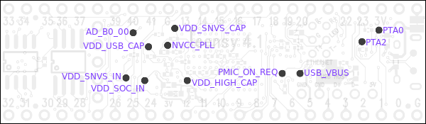

The bootloader chip is not involved in the software startup process. It does not function the same way as a traditional software-only bootloader, which runs first and then jumps to your program. When Teensy starts up, the bootloader does NOT run any code on the main RT1062 chip. Software startup doesn't depend on U2.
However, the bootloader chip does participate in the hardware power supply startup process. It is described in the "Power Up Sequence" on this page (scroll down if needed)
Look for step #7 for the U2 chip's role. That page has little Javascript buttons that highlight each of the power supply startup steps on the schematic. Hopefully that help you to understand the U2 chip's role in power supply startp.
You can measure the VDD_SOC_IN test point to confirm whether the DCDC hardware turned on.

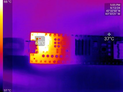

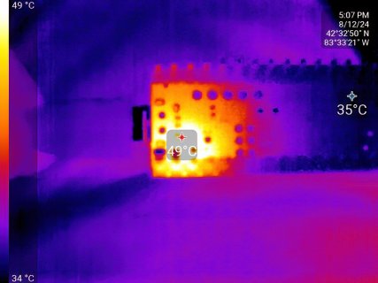

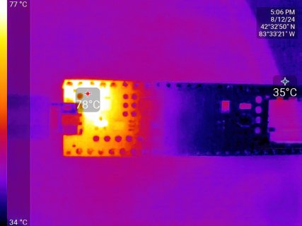

I was curious if you happened to have found the solution to this issue? I'm having the exact same issue and have now toasted two boards. I've attached IR images of the two boards under USB power and the majority of the heat seems to be going through the component just to the right of the USB port near the 3.3V pin (still trying to figure out what it is).
Both of these boards were working completely fine until one day they just weren't. One was installed in a telescope controller, which the design has been proven, and the other one died on a breadboard without anything connected to it but USB.

Upon further inspection, including an IR video that is too large to post, it appears that the MOSFET Q1 has failed and is shorting to ground. The hottest point on the board is F1, which I now know is a fuse, and the remaining hottest components appear to be Q1 and L2. So it appears that current is flowing through from USB-in to through the F1, L2, Q1, and then to ground.
I guess I'll try removing and then bypassing Q1 and see if that fixes the problem. I know its there for reasons, but it should be able to function without it as long as I don't do anything stupid.
