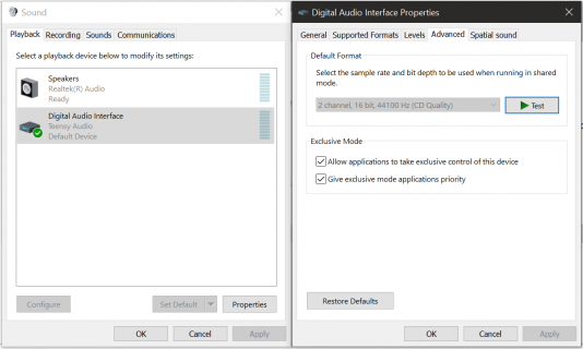

1. the Sound control panel looked like this:
Notice that the "Default Format" still shows "2 channel, 16 bit,
44100 Hz (CD Quality)". I expected 48000 Hz.

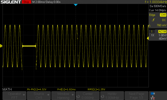

2. The sine wave is now corrupted:
Is this perhaps caused by what Jonr mentioned in his
post above?
