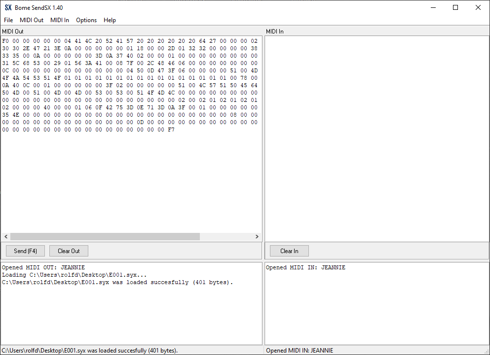

Hello Paul. Thank you for your time to solve the Midi reception problem in Teensy.
I have similar problem receiving Midi SysEx data on a Teensy 4.1.
I am using current Win10. For the USB transmission of SysEx data I use MIDI-OX, Bome SendSX and MIOS Studio.
My SysEx data block consists of 401 bytes. All apps have transmission errors because the Midi buffer in the Teensyduino Core Library is too small. I changed the buffer value for my synthesizer project ( https://forum.pjrc.com/threads/63255-New-Teensy-4-1-DIY-Synthesizer?p=326038&viewfull=1#post326038 ) to 512 bytes and everything works very well.
Attached is a SysEx file with a size of 401 bytes
Bome SendSX
Link: https://www.bome.com/products/sendsx#downloads
Great Thanks for your help :) Rolf from germany

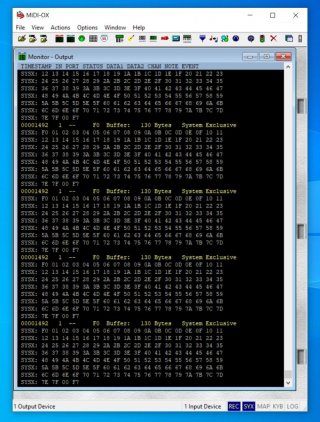

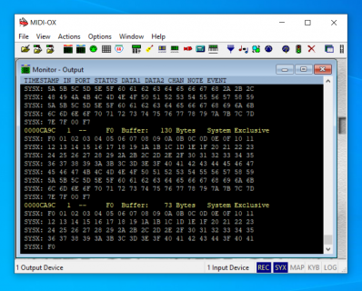

I programmed a Teensy 4.1 with the code from msg #30 and plugged it into a Windows 10 machine, then ran MIDIOX.
This is the result when I press a pushbutton connected to Teensy.
I scrolled up and it seems to be the exact same 130 byte message repeated many times. I can't see any which differ. Is this the expected result? What is the error?
MIDIOX doesn't seem to let me highlight the data and copy to clipboard. Is there any way to export?
I deleted "delay(delayAmt);" from the test program.
MIDIOX was complaining about lack of memory when Teensy reconnected. I rebooted the Windows machine and tried again. This time I got something that looks wrong. Is this similar to the results you're seeing?

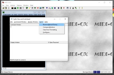

MIDI-OX is not stable under Win10 (its an very old midi tool).
Bome SendSX is easier and better than Midi Ox.
Receive and copy an SysEx File in MIDI-OX:
View -> SysEx -> SysEx -> Receive Manual Dump
then press the Teensy button to send SysEx, wait a second, and then press Done. Now you can copy sysex to save.

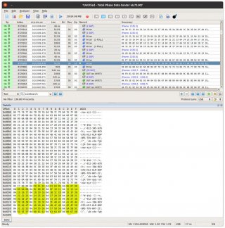

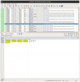

Ran more tests with MIDI-OX while watching the USB packets with Total Phase Beagle 480 logged with a separate Linux machine. Will try SendSX late tonight or tomorrow. For now, I'm out of time for testing and might not even get this message fully written, but wanted to at least quickly share the results.
First, I can't reproduce the problem at all with the code of msg #30 as-is. But I can get corrupted receive in MIDI-OX if I delete the 1ms delay, causing Teensy 4.1 to transmit as fast as possible.
Everything I can see in the USB packets shows Teensy really did transmit all the sysex data correctly.

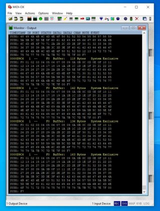

This is the wrong info I saw in MIDI-OX on my last test. It heard only 73 bytes in the last receive, and it's obviously fragments of data from 2 of the messages Teensy tried to send.
Here are the last 2 USB packets Teensy transmitted. The USB packets are all 512 bytes, except for the last one. Multiple sysex messages get packed into the same packet. I've highlighted the actual sysex data bytes.
As nearly as I can tell, Teensy is properly transmitting all the data its high-level code said to send. Something is going wrong on the PC side. Maybe something about the software just can't handle data coming in this quickly?

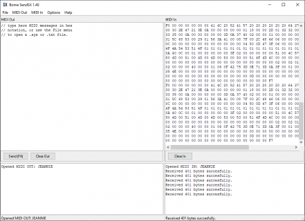

Tried Bome SendSX briefly. It does much better than MIDI-OX. But ultimately looks like the same problem. Teensy definitely is transmitting all the sysex messages in the USB packets. Every packet does get an ACK by the PC's USB host controller. But not all the data gets received and shown in SendSX.
Again, I can't see any difference by having or deleting usb_midi_flush_output() in usb.c.
Everything I'm seeing so far looks like Teensy is transmitting correct and the problem is software on the Windows side can't keep up and handles that scenario quite badly.
I really don't see any possible solution other than adding code to throttle the output rate.

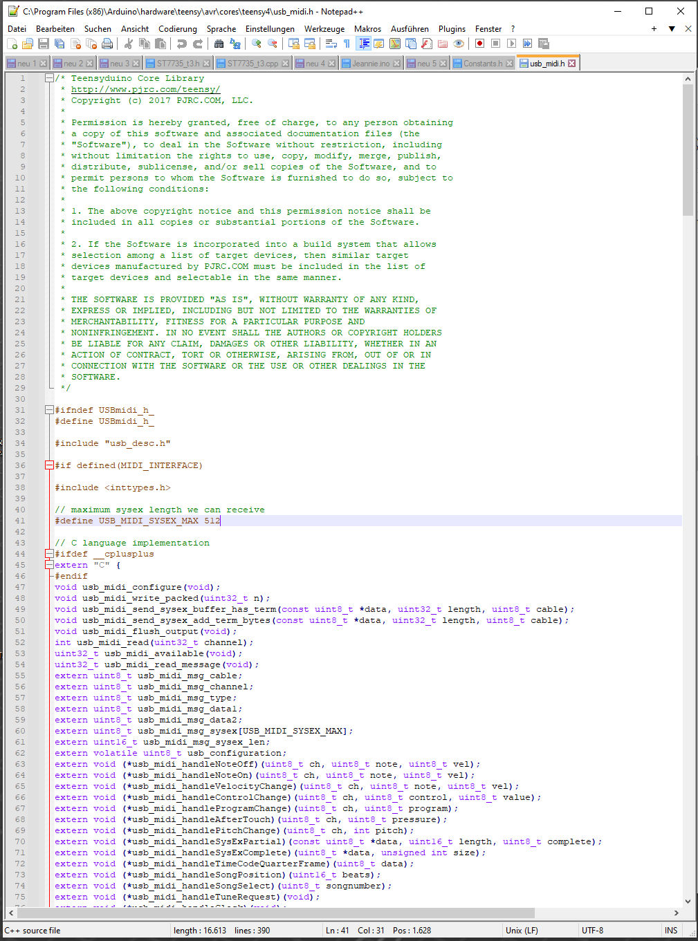

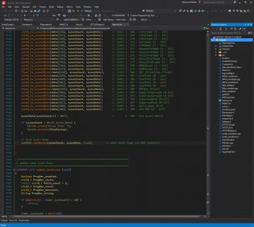

I can't remember exactly what I was doing in Arduino core library for send SysEx Datas to my PC :confused:
But.. I changed the midi buffer in Arduino core/teensy4/usb_midi.h form 290 to 512 Byte for receive SysEx Data from PC.
I can transfer 401 byte blocks from Teensy 4.1 to my PC without errors ( usbMIDI.sendSysEx(lenght, buffer, true); )
System Info:
Windows 10 Home 22H2 Core i5 4.1GHz 32GB Ram
Arduino Version 1.6/1.8 Teensy 4.1
Microchip Studio 7 with vMicro
