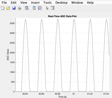

What could be my problem, is it the ADC code, MATLAB code or the functional generator settings
New_bee
I tried to connect the function generator probe to the ADC, A0 of the teensy4.1 with setting the input frequency to 10kHz. because I am planning to connect an analog accelerometer ADXL1002 to the ADC A0 pin. Even when I twerk the input frequency , I couldn't get a pure sine wave.
I also got a funny output at the Arduino monitor, click on the attached images to see the fluatuations.
I have attached the codes and images

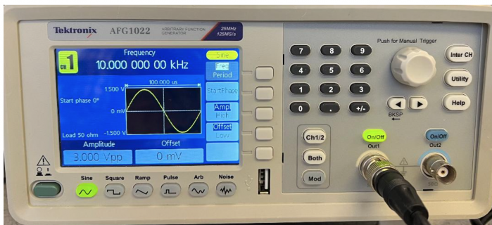

I can only assume here:
Your function gen is generating a sine wave that goes from +3v to -3v
The teensy ADC cannot read negative voltages, the pin can go as low is -0.5v from what I recall.
You need some conditioning circuit on the input of A0 - an offset voltage of 1.65v and a DC blocking capacitor.
You will then offset your ADC output by half of your ADC resolution (I believe the T4.1 support a max 12bits but only 10bits are usable)

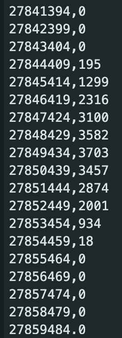

Thanks for your response.
Using the same code and without the function gen and MATLAB , I got the below output from the Arduino. I can see that the ADC values are just two digits and never goes to zero unlike when the function is connected. Even at that ,I think the ADC values are wrong.
31455320,21
31456325,16
31457330,18
31458335,22
31459340,21
31460345,19
31461350,19
31462355,31
31463360,37
31464365,31
31465370,20
Your generator picture says it all. You have 3Vpp, which is good, but offset is 0V.
Try putting 1.5V-1.65V as an offset directly on your generator.
Angelo
Angelo

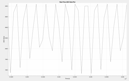

Many thanks Paul but it seems not working as expected. I just need to see a clean signal or waveform. After I adjusted the FG as suggested , I got the following on serial monitor and using MATLAB to plot the timestamp versus data.
21541086,4095
21542102,3235
21543118,1206
21544134,4095
21545150,3619
21546166,908
21547182,4069
21548198,3898
21549214,783
21550230,3923
21551246,4058
21552262,877
21553278,3659
21554294,4095
21555310,1152
21556326,3295
21557342,4095
Your sine wave is 10 kHz but you are sampling at only about 1 kHz. Try reducing the frequency of the sine wave to 100 Hz or even 10 Hz and I think you will see something that looks more like a sine wave.
Thanks
Please, what do I do to keep the sine wave at 10kHz and see more like a sine wave at the output.
Thanks
You would have to sample much faster. In your loop() function, you have delay(1), which is 1 millisecond, so loop() will execute at a little less than 1 kHz. If you replace delay(1) with delayMicroseconds(10), you will get ~100 kHz sampling, but you will also have a lot more data to handle. I suggest you start slow. Reduce your function generator sine wave frequency to 10 Hz and confirm that you can get a good sine wave with 1 kHz sampling. When you have that working, you can increase the sine wave frequency and the sample frequency and see where you begin to find other issues.
keep your sampling frequency at least twice (Nyquist theorem) or better 3 to 4 times the frequency of the signal generator.
20kHz means 50us. You probably should implement timer triggered aquisition, to ensure software will not insert some jitter.
Reading all the values by the PC should be faster than the acquisition rate.
Angelo
Angelo

I got this when the function generator was set to 1kHz
271676818,3702
271708221,3692
271739623,3700
271771026,3698
271802429,3693
271833831,3702
271865234,3691
271896637,3700
271928039,3698
271959442,3694
271990845,3702
and this when it was set to 10kHz
9444162,4039
9475565,4039
9506967,4039
9538370,4039
9569773,4039
9601175,4039
9632578,4039
9663981,4039
You have 31402 to 31403 microseconds between each timestamps. It is 31.4 milliseconds.
It means your loop executes at about 31.8Hz. Something wrong somewhere.
Angelo
It seems your main loop runs when the buffer of 1600 is full. But the ADC is set to make 8 acquisitions and averages them. And makes a continous acquisition, not through a timer.
So 1600x8= 12800 conversions.
Then you compute the average of the 1600 values and send it.
But I could be wrong, I am not familiar with the ADC and DMA of the Teensy.
Angelo

I tried this code and got the output below even when the FG was set to 10kHz, offset 1.65V and Amplitude 3Vpp
#include <ADC.h>

24323183,3968
24323183,3961
24323183,4082
24323183,4095
24323184,4091
24323184,3976
24323184,3953
24323184,4076
24323184,4095
24323184,4093
24323184,3991
24323184,3947
24323184,4067
24323184,4095
24323184,4095
24323184,4004
24323184,3942
24323185,4057
24323185,4095
24323185,4095
24323185,4020
24323185,3938
24323185,4044
24323185,4095
24323185,4095
24323185,4033
24323185,3937
24323185,4033
24323185,4095
24323185,4095
24323185,4047
24323186,3937
24323186,4019
24323186,4095
24323186,4095
WITH THIS , CAN THE DATA BE COLLECTED AND PLOT IN REAL-TIME?
Let's be clear: You CAN NOT collect and plot data faster than about 300 samples per second and plot it in real time. Neither the IDE plotting routines nor the human visual system can respond to more than about 30 data frames per second. You can receive and store a few hundred samples and plot those samples thirty times per second. The display will be useless to the observer.
The teensy can collect and store to SD card up to about 1 million samples per second. The human visual system (our highest-bandwidth input source) cannot process signals at that rate. Real-time sine wave plots of signals above a few tens of Hz. must be captured and stored for later analysis. Real-time display is not possible. With some real-time processing (and the T4.X can do a LOT of analysis of high-bandwidth signals in 1/30-th of a second), you can display the average characteristics of an input signal fast enough to bewilder an observer.
Very sophisticated analysis of signals collected by the Teensy ADC is possible. Just be aware, that with 1MSample collection you are going to collect about 2 to 6MB per second (depending on your time stamp interval and resolution) A thorough analysis of 1 hour of data will require you to write a program that can analyze a file of at least 7.2GB of data. Even on a fast PC, Matlab might take a few minutes to sort out that much data!
Rather than concentrate on the speed of data collection and display, you should be deciding what you want to learn from the data and how quickly you need to see the results. If the data is part of a real-time control system, you need to define how quickly the system must respond to anomalies and what should be done to control the system. For this you definitely do not want a human in the loop looking at a plot generated by the Arduino IDE unless your system has a time constant in the tens of seconds! A more appropriate response might be: "ERRROR ERROR, REACTOR OVER TEMPERATURE LIMIT. SYSTEM SCRAMMED TO AVOID MELTDOWN!" accompanied a large, red flashing light.
