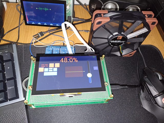

Implemented the control on a teensy 4.1 and a 5" 800x480 FT813 TFT

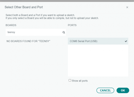

Click Tools > Board to check which board you have selected. It's probably not Teensy, because the analogWriteFrequency() function isn't displayed with orange test. When you select any Teensy board, the color of analogWriteFrequency() will be orange, and the code should compile without any error.

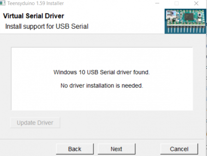

I have a PC with windows 10 and one with 11 , the 2.3.4 IDE doesn't work on the windows 10 PC so I went back to 1.8 IDE on that one. The windows 11 PC has the 2.3.4 IDE which works but doesn't acknowledge Teensy. I tried to install Teensyduino on both as the screenshot shows, it says no driver needed The teensy doesn't show up on either PC. It is an old 3.2 but the little led comes on. Suggestions?

Maybe this helps? Can't tell from screen shots:
For IDE 2.x: use the Board Manager installer
For IDE 1.8.x use only TeensyDuino after pointing it to the Arduino 1.8.x install location - it does the work of the Board Mgr install.

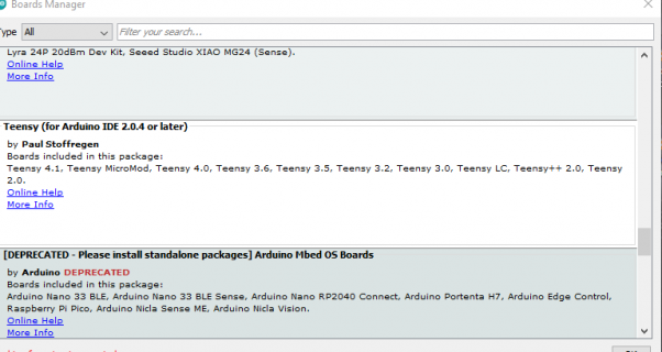

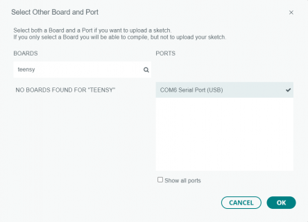

I tried both those things, the Board Manager installer for IDE 2.x has no knowledge of a Teensy and the !.8 shows it but says only works with 2.0 or later.
Two important points.
First, the most common problem is power-only USB cables. If Teensy powers up (orange LED blinks, stops blinking when you press the pushbutton), but your PC never detects any USB device, you almost certainly have a power only cable. Most Windows computers make a chime sound when any new USB device connects. If yours does not, search for how to configure the chime sound (sorry, I mostly use Linux so I don't know Windows config stuff). Test by plugging in some other USB device. If you hear the chime with other devices but not with Teensy, you need a proper USB cable. No amount of installing software can make Teensy communicate if you use a cable that has only wires for power and lacks the wires for data!
Second, by default Teensy uses HID protocol, not Serial. If you only look for COM ports on Windows, you will miss finding Teensy when it is using HID communication.
You need to add the Teensy URL using File > Preferences. Details here:
But again, if you have a power only cable, which you can test using only the Windows chime sound for connecting USB devices, nothing you install can solve the missing wires problem. Those power only cables are sold with very cheap products that have USB for power only. They are made with the 2 wires for power, but lack wires for data. Those power only cables are by far the most common problem and have been discussed over and over on this forum. Check that you get the Windows chime sound before wasting a lot of time installing software!
