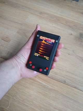

I think this is already quite compact.
The enclosure is quite thick (36mm) but if you want a display and some controls you will probably get something like this size. The 68mm width is perfect for the Teensy and the display.
There is some free space in the enclosure so you could make it even thinner is you want.
The only thing I do not like so much are the "high" encoder knobs but we do need some way to have control over the unit.
This is a standard enclosure (not 3d printed)
I juist built this one for a German batfan, who kind of "lost" the first one to his son.
Kind regards,
Edwin

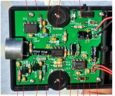

Tony uses the same frequency division detector concept in Manu of his designs. A double lm386 as amplifier for the UST and a 4024 IC as devider.
I have been unwanted oscillations in the audioamplifier. I suggest you add 10nF and 10ohms resistor as found in the data sheets.
Using the UST this will work best on 40 KHz, the MEMS element we use gives better frequency response over a broad range. Ik have no Idea how that works with the double lm386.

You basically have two options if you want to build something simple.
Frequency division, this does not require any tuning, it works by amplifying the received signal until it makes a square wave which is than divided by a counter IC or something like that.
Heterodyne, this is like a radio receiver, mixing the high frequency to an audible signal. This requires tuning and allows you to hear only as small portion of the ultrasound spectrum. The received signal is usually considered better quality.
Tony does not have the complete circuit on his website for the batscanner, there is something missing in the display pinout. I hope my schematic is complete but I do not have my pcb's yet so I can not test.

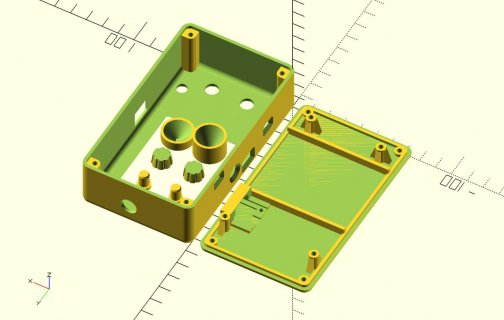

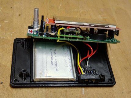

I finally built my detector, using Edwin's board and MEMS mic PCBs. Truly an amazing project. I'm so grateful to all involved.
I added a tiny LiPo charger from Adafruit to handle the battery charging. I also made a 3D-printed enclosure using OpenSCAD so it should be easy for others to modify to suit their needs. I'll put complete info on my website in the next week and provide a link. Lots of 23kHz noise but I'm sure I can improve it.
Teensy_Bat_box_OpenSCAD_with_knobs.jpgTeensy_Bat_box_OpenSCAD.pngTeensy_Bat_with_charger.jpg

Nice to see that you are adding something to this project by opensourcing your design for an enclosure. THe noise on 23Khz is something Edwin and I also have been exposed to. Having an TFT near a microphone setup does seem to give some problems when trying to isolate. Thats why we shut down most of the TFT when recording sounds, that helps a great deal.
