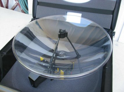

Anyone try the Bat detector with a parabolic dish to find powerline noise? I just wonder if would be sensitive enough to detect the weak discharges on powerline insulators.
I am trying to track down some leaky powerline insulators?
An acoustic camera would be one approach - although not cheap! An ultrasonic acoustic camera, there's a bat project!
I guess you should be able to hear discharge sounds, MFJ is selling the 5008 as device to detect ultrasonic discharge sounds with a parabolic dish.
MFJ is normally producing HAM radio equipment, apparently they use this to locate arcing insulator that also have impact on receiving radio signals.
I have no idea what technique is used but since it is presented as a ultrasonic receiver you should probably also hear these sounds on our detector.
My best guess is that MFJ is using Frequency Division because there does not seems to be a way to tune it.
If you only need this detector for finding arcing power lines a simple FD bat detector with a dish will probably work fine.
I have no Idea how well the MFJ dish is formed, a good dish normally costs quite a bit of money.
Oh, and building the detector form this tread would probably cost around 100-150 euro's where an FD detector only uses about 10-20 euro's of materials.
Cheap wok lid is worth trying as a dish (!)

Hi Edwin
I believe that the MFJ is a 40khz FD detector. In relative terms its expensive for a such a simple device.
I believe that a detector with broader frequency response that is not so frequency selectivey might be a better option especially if it has sensitivity. A tunable design will do however the Teensy with its waterfall will be much more informative to understand how these insulators arc. Thats my own personal technical interest not an "experts" view.
I think I will build the Teensy just out of technical interest and see how well it works, i see the Teensy project more as a"ultrasonic accurate level measuring instrument" that would have more value and also add a technical dimension to understanding whats going on. So the cost is reasonable rather than just copying a cheap circuit while learning nothing!
Thanks for the information, I just thought i would ask before starting the build.

Hi Mark
Good thinking there however the weight might be a issue. I am sure I can find a cheap "wok like object" made out out of cheap pot metal that melts in the rain for expirmentation. The local Asian grocery shop has all sorts of plastic bowls that are close to parabolic in shape. If I cant find something suitable I will just get something 3D printed in one of the 3D printing shops that make things like this more economical to print. All part of the fun of learning, its not only about the cost. I have boxes full of experiments that i dont want know how much it really "cost"
This is what a professional Ultrasonic dish looks like, just out of interest. I believe it costs about 5000 US Dollars!
It would be nice if something as simply as an oriental frying pan or lid could work, unfortunately the higher te pitch the shorter the wavelength and the lager the chance that the sounds are reflected are not in phase. If you have a 40kHz soundwave the wavelenth is just over 8mm. I you imagine two waves bouncing off a dish that is 2mm off, the sound travels 4mm longer on one part compared to the other which creates 180degree of fase difference. The negative pressure counteracts the positive pressure of the other wave. The result is 0 and you don't hear a single thing.
There where it could have worked for speech, for ultrasound it is not of much use. Or at least not nearly as good as a perfectly made parabolic reflector. Please try it and prove me wrong. I would love to know the model of that piece of cookware.
