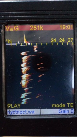

What is that with the display Cor?
It looks much different compared to the v1.0 software...

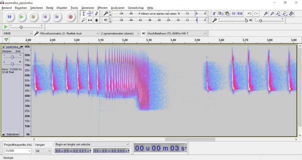

Well I know of course, and in case you guys did not notice how good the serotine looked in Cor's last message, I attached an image that shows the new vs. the old waterfall image.
I played the same wav file for both software versions.
It is a common pip with feeding buzz, nice hockeystick calls.
I played this using and ALC4050 (384kHz samplerate) audio chip, TDA2030 Audio amplifier and cheap ribbon tweeter.
This image shows the huge difference between the new and old visualization. Looks like Cor put some magic bits in the code.....
There are more call shapes on the display because the pauses are not shown, but the shapes look better an much cleaner. Without showing the pauses we have much more calls to look at and they scroll much slower through te screen.

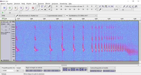

Did anyone already capture a horseshoe?
I do not have them around here so I played some recording.
I you have a good recording of rhinolophus hipposideros (lesser horseshoe) I'd like a copy.

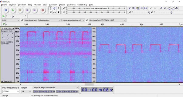

This is an image of the played recording, recorded on the Teensy bat detector.
You can see a lesser and greater horseshoe.
Beacause of the high frequencies you might want change these lines in.
bat_audio.h
266 // highest frequencybin to detect as a batcall
267 signal_HiF_bin= int(120000.0/SR_FFTratio);
For the lesser horseshoe values below 100000 are probably not enough.
In TE you also probably need a division rate of 1/20 (TE-speed) or have good ears on 10Khz. And it seems to help to set TE GAP to about 35. If TE
Heterodyne or auto heterodyne do not need those settings and might sound a bet better.
In TE you wil probably only hear something like a continuous tone if TE gap is set 80. In HT you can hear the pauses between the calls a bit better.

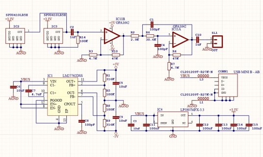

I'm trying to improve the analog amplification of the MEMS
Many test done and not great results ... at least for the audio quality I need.
My Ultramic384k is equipped with a differential amplifier because of the different application fields.
The smaller series of ultramic has a single ended amplification.
The greatest part of application notes and datasheets regarding MEMS amplification report the sensor to be connected to inverting input and this the same as in my Ultramic250k while in this project it is connected to the non inverting input. I don't know which is the best but since the first one has not great result I will try with the second mode.
The main problem is the noise and the frequency response.
The solution is not only to use low noise operational amplifier but all the components and the PCB layout must meet low noise performancies.
In the latest circuit I use LP5907 LDO, this has a very low noise output in the power line: < 6.5 µVRMS.
Just today I found a power management IC that seems to be perfect for all audio application with dual power supply: LM27762. The output noise is 22 µVRMS (related to the output load) but we must consider that the IC has a double integrated switched capacitor converter, the first one double the input voltage and the second brings the doubled voltage to negative level. Two integrated low noise LDO stabilize the outputs.
2-MHz Low-Noise Fixed-Frequency Operation avoids interferences in ultrasonic range (this is very important!!!).
This IC seems to be perfect, the only negative aspect if the small form factor, hard to solder for people with not a great skill with leadless SMD components.
The choise of operational amplifier is not simple since the output inpedance of a MEMS is low and if we want to use a non inverting input then a JFET Op Amp is preferred since the resistor that brings the input to a defined level can be increased with good results on signal.
OPA1642 is low noise, low distortion, jfet Op Amp with Vn at 1 kHz nV/rtHz 5.1
I prefer to avoid an high pass filter, only a decoupling capacitor for DC. Mandatory is the antialiasing filter.
I am designing the new schematic and I will post it soon
Ivano

Attached the preliminary schematic, probably there is still some error.
I am going to produce some prototype so we are still in time for changes.
Iv

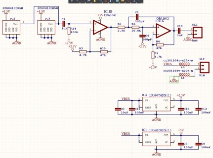

I was thinking that in this way we need to bring the output around 1/2 vdd so perhaps a single supply with the mid reference is the easier solution with a phantom ground at 2.5V since the min supply range is ±2.25 V
Hi Ivano.
I did not read through the LDO datasheet but usually capacitors on the output side of the LDO are larger. Are you sure 100nF is sufficient?
Why the 2v5 regulator and not a voltage divider? Is voltage divider more noisy, or do you do this to consume less current? Just wondering why you decided to do this.
Oh, and what is Vbus? Right now I am powering the detector from a phone powerbank which is about 5volts. I think this should have al least 5.5v input voltage.
Kind regards,
Edwin
Hi Edwin,
yes, I must add some other capacitor, I usually place 10uF and 100nF in parallel
For very low noise circuit all the voltages must be very stable, so a voltage divider (is not supplied with a unity gain Op Amp) is not completely stable even if you place some capacitor. Moreover it uses less current.
Vbus is the input power = VDD.
This circuit requires at least 5.3V because of the 5V LDO. I never used this configuration but I must check it to see the performancies. Surely the first circuit is better but the output swing between 0V so another Op Amp is mandatory to bring the voltage to ADC specifications. The second swing between 2.5V (bypassing C10)
Regards
Ivano
