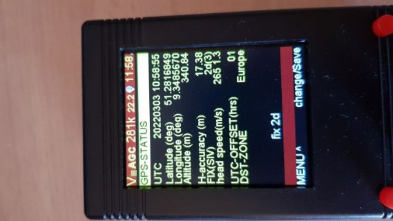

Yes, the blue LED of the GPS is flashing. I use the Baitian BN 220
GPS is not recognised at start-up! I will have another look at the two I2C pins and re-solder them if necessary!

This has nothing to do with the daylight saving correction. The GPS date is not correct in the display!
Kind regards,
Jürgen
Hi Jurgen,
The display of the date is constructed by reading out the datetime information from the GPS and then recalculating that to UNIX-time (seconds since 1st jan 1970) to allow the teensy timers to directly use that info. But in that calculation we also adjust for DST and as Edwin stated this weekend this problem was not there. But we are going to see what goes wrong in the code,
Cor

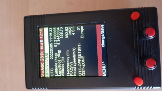

the bugfix works perfect! Here is my picture from today. Unfortunately, the bats don't fly yet because it's still too cold.
At the moment I am using the training files from your website to get to know the device better.
The sensitivity to the Batdetector 3,6 is already phenomenal!

Thank for the information Cor, corrected files are on my website for both Teensy 3.6 and 4.1 based detectors. The Teensy 4.1 files are compiled with PSRAM option and four variants are available although only the GPS variants need to be updated, I generated all four versions.
For bugs and requests.
I do see a 0d FIX many times when SIV indicates several satellites. On the bottom of the GPS_STATUS screens I still see fix 3d. I also had the indicator showing the red droplet with a white x when I still had fix 3d in the bottom screen but I was unable to recreate that. I hope someone else had the same issue and was able to recreate it.
