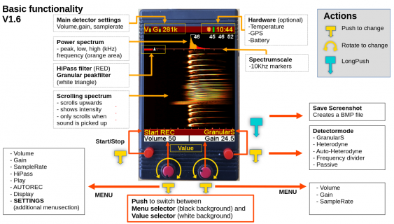

Just an Idea
is it possible to jump directly into the settings by long pressing the L-ENC
and activate the Auto-Recorder by long pressing the R-ENC
Thanks for the superb project.
Works geat.
Just an Idea
Long press R has allready been programmed to save a screenshot to the SDcard. So it would need a special routine to first catch a long L-Enc and then a long R-Enc.
I will consider this in the next update as a request to activate the auto-recorder directly.
cheers

Hi Cor,
As I said, this is just an idea to possibly make it easier to use.
Especially the direct access to the auto-recorder I see as a golden opportunity.
Then you can give the TeensyBat to a friend - he only needs to turn it on, press the button for 3 seconds and put the device down in the garden.
If you meet him during the day you can also hand over with activate Auto-Recorder in DeepSleep mode. Even easier, but not always possible.
regards, Georg
If I am not wrong going to autorecord in the current setup is a matter of rotating the left-encoder to autorecord and press the left-encoder. Thats not a very complicated procedure ...
Cor
I also handed out my detector in deepsleep to a colleague. He only needed to bring it home and place it in a dry spot outdoors. He did find some droppings he was puzzled about, it turned out he has a family of common pips under the rooftiles from time to time. With a big battery you can tecord several nights.
I guess the long press options could be placed on the wishlist of future versions. We all know most whishes do not come true but if there is nothing in its way, it is worth to look at it I guess.

Last year we worked on a clearer visual overview of the functions of the buttons on the Teensybat but never shared that. I have attached the V1_6 version for reference.
