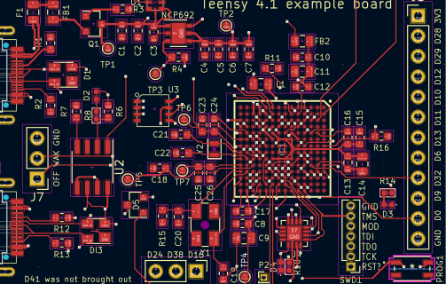

I found this on the forum when I was designing my board on the T4 Bootloader Chip thread:
Silicon is dear these days, and I was able to find availability in the W25Q128, so I have a 16MB flash chip on there. (EDIT: size, duh)
It's good to know that the board variants aren't burned into the MKL chip.
I'll try the fix #1 you mention to verify that this is the issue.
You say
This is a prototype, so I think that my team and I will have to make the custom change on our machines for now.
For future versions that will be released, I will just need to make sure that I get the correct size flash so that the Tympan 'just works' with the Teensyduino. I can't expect folks to make that low level change.
Thanks @defragster!

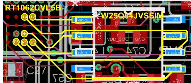

Only 3 flash chips will be supported, W25Q16JV**IM, W25Q64JV**IM, and W25Q128JV**IM. This and so many other design issues still need to be documented. These IMXRT chips have a much more complicated startup process than simpler microcontrollers
You say
but I want a single simple answer!There is no single simple answer,
