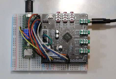

I did not know somebody already asked this question - I just bought one of these for $25, will try to hook it up to Teensy 4.x
It would be great to know if anybody has done this already.

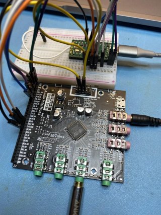

This is a picture of it i just took.

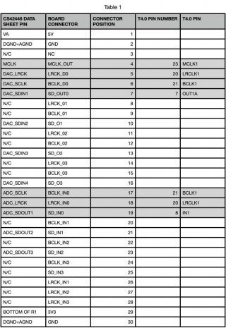

@alfa66 I've experimented with one of those boards from ali express, they work fine with Teensy.
I captured a few details of the connections on my board - it look exactly the same as your board.
I have it running with the 6 ins and 8 out with breadboard wiring (you'd want to tidy up the wiring and keep it short if you're making any sort of permanent installations).
I've dumped the details below - any question just shout out.
Cheers Paul
Main Connector
Master Control Connector
A picture of it connected

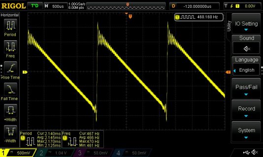

Attached a screenshot of the Waveforms16.ino example, it doesn't look as good as a sawtooth might look; maybe R/C on the board are not optimal.

Waverforms looks good.
A good conversation about band-limited signals is here: https://www.youtube.com/watch?v=h7GFyM2v16U
Check @ time ~6:30
So, either the input waveform is band-limited, or the output is LP filtered very heavily....
Have fun!
alfa66

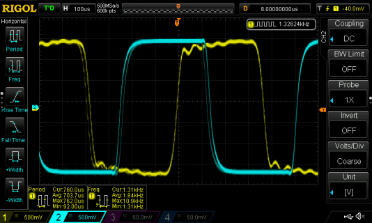

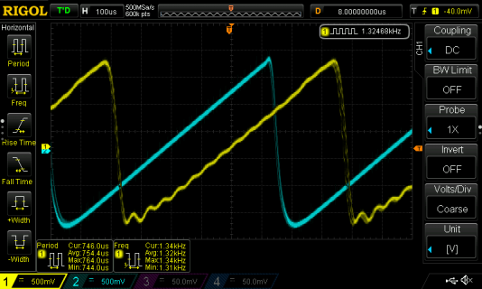

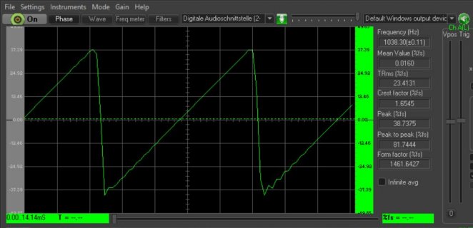

Hello alfa66, thanks for the video, very good!
I made 2 measurements with an external sawtooth (1038Hz)
first a passthrough and input and output measured with the Rigol: yellow is input, cyan is output. And saw those slight vibrations again. The board was connected to a power bank in the passthrough test to avoid interference from the laptop power supply.
I then routed the input to usb audio and measured the usb-audio on the laptop. The input signal looks very good.
Will feed the board with music later in passthrough and connect my CD player. Had the output on the amplifier, which is very quiet with no interference such as hum and crackling. Great little board!
is it possible to set the input gain, preferably per channel?
Cheers, Thomas

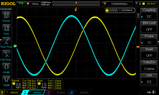

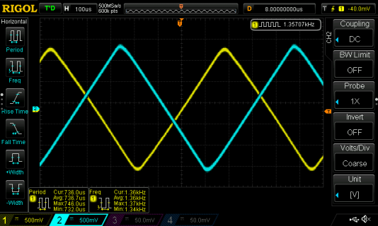

with the changes above, i get these measurements: cyan is input, yellow is output.
the high-frequency interference could be the sample frequency of 44.1 kHz, this needs to be measured more precisely.
the audio passthrough sounds fantastic.
cheers, T

That's almost certainly not high frequency interference, its the digital filtering on the converter I suspect, probably for anti-aliasing. It looks like a minimum phase brickwall filter, although there is a strange end to its impulse response with a slight kink...

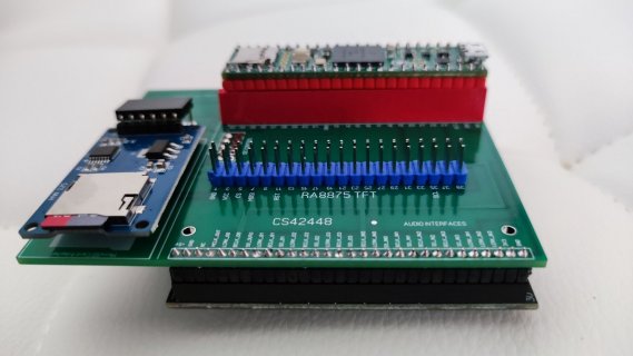

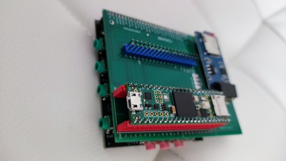

Hello everybody,
i got this board,works like a charm,and i want to rely it with a pcb that have a teensy 4.1,
like a sandwich plugged into the "audio interfaces female pin header" of the CS42448 board.
But the distance separation of the pins is not 2.54,not 1.27,it's like ~1.5 to 1.7.
Does someone know the exact distance between 2 pins?
i'm talking about the pitch,is it really 2.0mm?
Now i did my PCB with teensy 4.1 and a wiring sandwich that put the cs42448 at the bottom side,the pitch that works is 2.0mm
There's a connector on the up side to connect a TFT 7" RA8875,and also and EXT SDCARD reader because the building SDCARD
of teensy card was in conflict with the TFT
Cheers Paul
Main Connector
A test program
