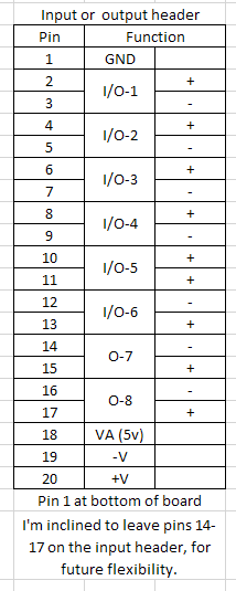

Power would be pinned through the In/Out headers, with pins for 5v VA as well as +/- 12v. Additional power could be supplied through a daughter board, or via an additional header on the main audio board. Possibly buffered VQ as well?
Daughter boards would probably provide pairs or quads of inputs or outputs. Jumpers on the daughter boards would assign channels to pins.
I'd be keen to align the pinouts on the expansion headers if possible, with whatever, you're planning, so that users get more, rather than less flexibility, as I/O modules appear.

I've shifted my thinking a little from single long headers and bat-wing input and output boards - which lacked mechanical stability - to a separate header for each pair of ins or outs. This allows a modular approach and ribbon cable connections between the main board and each module. I'll keep the footprints in place for the 3.5 mm sockets, as they are really useful for testing. Adding V+/V- and buffered VQ (an opamp and some decoupler caps won't take up much space at all!) rounds out the pins - a total of 9 pins between 2 inputs (I1+/-, I2+/-, V+/-, GND, VA, VQ). It could be brought down to 8 if VA & V+ were jumperable options.

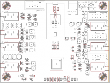

As promised here is a first cut of the schematic and broad layout.
None of the components are optimised at this stage, and the decoupling caps are still sitting in a neat row at the bottom. Most SMD components are 0805 or 1206 to make manual loading for the prototype easier. I'd expect a 20% narrower board with smaller components, optimised layout.
What's driven this iteration:
  • T4 pinouts
  • At least the same basic functions as the original board, same I/O connectors as base
  • Flexibility - additional supply arrangements and headers for input and output expansion boards.
Commentary and suggestions welcome!

Looks good. I have a couple of suggestions.
1,) Use IDC socket footprints for the output headers as well because of the pin orientation with VA/VQ opposite GND. IDC sockets are optional components anyhow, and take up only a little more real-estate than the bare headers.
2.) I question breaking out the AUX port, MCLK is a fast switching signal (22.5 MHz) which might lose integrity quickly over a ribbon cable. I'm not sure there is much use for that extra channel pair either.
3.) Perhaps break out the rest of the Teensy pins by mounting it with a footprint like this breakout board - that would allow including access to an SD card with 4 bit SDIO, and, if not too constrained for space, an SD socket footprint as well. Also perhaps a footprint for some PSRAM or serial Flash like the Audio Shield has. These things are important to better support the Audio library.
4.) It'd be great if at least one side of the board were less than 109mm long, as this is the typical Eurorack rail clearance. Better of course wold be both sides ;-)

When I'm looking at the schematics and compare to T4 pins I wonder if there is an error. It looks like that the MCLK pin is connected to correct T4 pin (D23) but the pins SCLK (BLCK), LRCLK, SDA and SCL should been connected to D21 - D18 in that order meaning they have been shifted to D22 - D19 in schematics.
I would also like to see SD and flash/PSRAM (SOIC8) on the pcb. Also header for UART TX and RX for external MIDI breakout with GND and 3V3 pins, rather in that order, or actually reversed, 3V3 pin 1, then GN, RX and TX, like used on this breakout: https://electricdruid.net/product/midi-inoutthru-pcb/. Then also instead of the single AUX ADC a header for freeDSP connected to I2S2 (all pins, MCLK from I2S1 as I2S2 MCLK is routed to some pad only).

Thanks Mhelin for the commentary,
I'll check the pinouts on the Teensy again. I must admit they are amongst the easiest things to fix - I've been concentrating on the audio ins and outs which are a real headache to route neatly and keep away from digital stuff.
Sadly there's not enough real estate to meet every need. So SD & flash will miss out this time. They are available readily on other stackable boards, so I don't feel too bad about not being able to meet that particular need on this specific board.
You can get to RX/TX directly by stacking a MIDI board on to the Teensy. Same for the other I2S pins to allow freeDSP access (which is a very neat idea).
Neurofun has addressed the 48kHz issue, which is akin to the 24 bit discussion - and well covered already in other posts.
One part of the circuit I'm not yet happy with is the 5V power changeover from VUSB to external. I've simply left it that you shouldn't plug both in a the same time. Not very elegant. I originally included a jumper, as it merely duplicated the "don't plug both in together" instruction. The only other solution I can think of would be a power management chip, but this would be better on the Teensy board than a daughter board.
