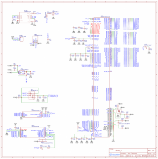

We are trying to build a custom teensy board. Currently we are experiencing the double blinking error, indicating JTAG not responding or improper power startup sequence. We have tried 3 PCBs, and the issue is same (perhaps the issue is with our schematic itself).
The chips MKL, MIMXRT, and W25Q64 are bought from PJRC.
We would greatly appreciate it if anyone could point out any issues with the attached schematics.
Many thanks in advance!
Hello.
First time posting.
The 24MHz crystal (according to the symbol shown) is not connected to XTALO correctly. Connections to GND and XTALO should be swapped (at top of crystal symbol). Don't forget to move the capacitor as well.
The XTAL1 connection is okay.
I haven't reviewed the rest of schematic.
Thanks a lot for the help.

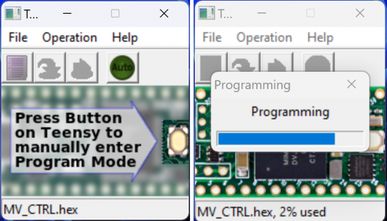

After fixing the crystal connection it seems the errors are gone. However, I am still not able to upload any program.
When I connect the board, the PC gives the sound. When trying to upload with the program button, the chip appears (in Teensy loader) and disappears, and nothing happens. [After pressing the program button, the LED blinks 3 times while PC showing the chip].
You tried to upload a blink sketch for the Teensy2. Try the sketch for Teensy 4.1 (ends in 41).
Thank you for your reply. I also tried the file 'blink_slow_Teensy41.hex', but the issue is same.

The verbose report shows the following:

Can you measure the VDD_SOC_IN voltage? If the last stage of the power up sequence is working, it should be 1.15V or 1.25V.
Maybe also check the voltages on VDD_HIGH_CAP, NVCC_PLL, and VDD_SNVS_CAP.
If the board truly has completed all stages of the power up sequence (see the little javascript buttons on the T4 bootloader page to visualize) then the only other plausible explanation for 2 blinks would be a wiring error between IMXRT1062 and MKL02. But your schematic appears to be correct, at least by a quick looks comparing to the Teensy 4.1 schematic, so if there is a wiring problems between the chips it's likely something subtle. Maybe with showing the layout and photos of the bare and assembled PCBs something wrong might become visible.
But since the wiring appears correct on the schematic, first check that all power supply rails came up to proper voltages. Let's only dive into pictures of the layout and photos of the actual PCB if the power rails all check out.
Another thing to check, probably a long-shot, is whether you have anything driving the IMXRT1062 pins before it starts the power up sequence. Perhaps other devices that power up separately?

Does this mean the 1062 wasn't fuse configured and updated?
Would the 15 Sec Restore complete this? @bhaskar was this tried?

The issue was perhaps improper soldering as I do not have much experience. I removed and resoldered both the MKL and W25Q64 chips, and it now works as expected!
The main mistake in the design was connection of the 24MHz oscillator as already pointed out.

We fixed the issue by simple resoldering the MKL and W25 chips. Apart from that the oscillator connection was wrong.
Now we can flash codes without any issue, and IO ports seem working fine. We will do more testing.
