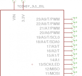

Reversed MOSI/MISO pins in library?
I just a got a batch of boards back that refused to work. Ultimately I think it traces back to MISO/MOSI being reversed in the Teensy_3.1_DIL package of the library "Teensy_3_and_LC_Series_Boards_v1.1".
- published pinouts on this site say MOSI (DIN) is pin 12 on the Teensy 3 series
- Eagle footprint for device "Teensy_3.1_DIL" says MISO is Pin 11
Could someone with a higher knoweldge have a look and see if the library is OK? It's entirely possible I am worng or made some mistake along the way, although breaking traces and reversing the two pins made the boards work!
I'm loving the Teensy BTW, thank you. Thank you also for the library, which saved a lot of time!
D
Pin 11 is DOUT -> MOSI (Master Out Slave In)
PIN 12 is DIN -> MISO (Master In Slave Out)
The Teensy_3.1_DIL package is ok.
edit:
note: this applies only to the Teensy in SPI master mode, in slave mode MOSI/MISO are reversed:
Pin 11 is DOUT -> MISO (Master In Slave Out)
PIN 12 is DIN -> MOSI (Master Out Slave In)
