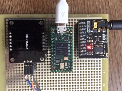

Fast Convolution Filtering with Teensy 4.0 and audio board
DD4WH
To test T4 performance I extracted the fast convolution filtering code from my SDR and tested it with the Teensy 4.0 and the Teensy audio board. Both were connected with flying wires (MCLK with 100ohms series resistor).
 * just a small sketch to play around with audio processing with the Teensy 4
 * FAST CONVOLUTION FILTERING in Stereo
 * uses Teensy 4.0 and the Teensy audio board connected with flying wires
 * Frank DD4WH 2019-08-17
 * in the public domain GNU GPL

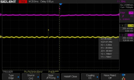

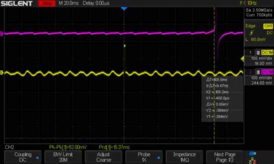

Hi Frank: I loaded your program into my setup and it works. I can set Fhigh at 1000 Hz, and the vocal track coming thru has all the high freqs filtered out. I am assuming that the filter cutoff is "brick-wall" as you say, at such high FIR lengths. I haven't yet hooked up a signal generator to measure the skirt steepness.
However, the latency is definitely not 2.9 ms!
I fed in a short pulse and measured the delay time from input to output. At 8192 it was 107.6 mS, and dropped to 26 mS @ 1024, 20 ms at 512. This is about twice the latency of my library routine which uses 512 tap filter
(1024 FFT)
This is my 'scope capture for the 1024 tap setting- 26.8 ms latency
I can see from the code that your routine only waits til 1 audio block is available, Also at the end, it only sends 1 block at a time. So that looks great. However, I am thinking that the signal, (short pulse in test case) is slowly working its way through the 8 segments (1024/128) and that is what results in the latency.
I may be doing something wrong, but my measurement setup is the same as I used last year to test my fconv. filter library, and it came out at 15 ms, just a few ms more than the 4 block times (I processed 4 blocks at a time). So, I think it is OK
Any thoughts?
cheers

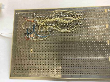

Hi Frank: I noticed that you were running the new filtering routine at 48000 SR where I use 44100. But, I changed my SR to 48000, and everything continued to work with no pops/crackles. I don't know if a new version audio board will work any better- mine is a 2-3 year old model. You did insert a 100 ohm resistor in series with the MCLK lead, right?
Here is what my board looks like from the bottom- so you can see the lead lengths etc.

Hi Frank: I looked over your resources link. The pseudocode you listed is easier to follow than straight C code. Before proceeding, I have to say that my experience is in electronics first, then programming, with advanced math a distant third!
I have noticed a few things:
1) The term latency is defined as the time needed to acquire the required number of samples. In that respect, the 2.9 ms you quote is definitely true at SR of 44100 and 128 s/block. However, when I refer to latency, I do so in terms of what an audiophile or a musician would- i.e. the time delay of a signal from input to output of a given device. That is what I was measuring on the scope capture I gave you.
I have put my measured time delay numbers into an excel spreadsheet and the data defines a straight line with an equation:
latency (ms) = 14.45 + (#of filter taps X 0.0114)
That implies that there would be a fixed 14.45 ms delay in the signal processing even if taps = 0, and 11.4 ms delay for every 1000 taps (just rounding off here- you would be using multiples of 512)
So, I ran the same test on the Teensy audio example "PassThroughStereo". I had earlier mentioned that I thought that this example just configured the SGTL5000 to pass its ADC signal to the DAC directly. You can configure it this way if you want, But,I was wrong- that example actually passes the audio through the audio library without any processing. In this case there is a 6.4 ms delay, or latency as I call it. That looks like 2.9 ms input latency, some other misc. delay in re-setting the DMA controllers, and 2.9 ms latency in the output queue.
So 6.4 ms is "the bottom line"- no filter algorithm will do better than that if its using the Teensy Audio library infrastructure. I pretty sure I'm correct about this, unless I've done something stupid in my scope measurements.
2) That being said, I also confirm your 686 us total execution time for the code in the algorithm (in hardware, using my 'scope). So, where is all the delay coming from? I like to look at it in the time domain.
For the 8192 tap filter, for example, you have 64 discrete blocks forming a circular input buffer, containing 63 "older" signal blocks + the current one. I am thinking that until the block representing the "current" time lines up in that buffer with the centre of the FIR image array, during the convolution, you won't see any appreciable output. I am specifically referring here to the short (2 ms) pulse that I am feeding in. This is shorter than the 128 sample block time of 2.9 ms, and models the "unit impulse" that the DSP textbooks refer to. So, out of 64 blocks, only one will be filled with the pulse height value, all others will be zero. A Low pass FIR image, at least in the time domain, is a high amplitude peak in the centre of the filter image array, with only small spurs on either side. So, you can see my idea that even though the processing time of your routine is only 680 us, the latency (which increases linearly with # of taps) must result from the time it takes the input signal to work its way through to the centre of that 64 block input array. This agrees well with the measurements I took. 32 blocks X 2.9 ms = 92.8 ms. Adding in the 14.5 ms inherent delay that I got from my Excel formula, makes 107.3, which is what I measured on the scope for 8192 tap filter.
3) You must be doing all of the math correctly, or the music signal that I can send in from my iPhone wouldn't be getting through the filter un-modified (with your defaults of LP=5, HP= 20000) . ( I know from hours of fooling around with my library version of the conv. filter, that any little error results in a "trash" signal!!) . Possibly you are choosing the wrong pointer(s) into the input data array, which give a perfect output signal, but with a big delay in the signal itself. If not, then I don't see how those other people you cite, can be achieving lower input-output latency values that they claim.
I'll be looking at this some more, but I don't have the math skills you (and the authors you cite) do, so I may not get anywhere.
Cheers

I managed to fix my crackling noise by using a proper hardware setup on a proper groundplane, that seems to be the key to getting the signals from the T4 to the ADC/DAC and back :). I also used 100Ohm series resistors in the BCLK, LRCLK and MCLK lines to the ADC and a 100Ohms resistor in the MCLK line to the DAC.
Now the T4 runs with the ADC PCM1808 and the DACPCM5102a. I managed to use the ADC with 256ksps sample rate (it is rated for 96ksps), so there is potential for people interested in ultrasound (or in FM radio demodulation, where you need large bandwidth).
I have not managed to investigate further in the partitioned convolution, just used the sketch to push the T4.0 to its limits (processor load AND RAM ;-)). The T4.0 can run a partitioned convolution filter with a maximum of 16256 FIR filter taps at 48ksps sample rate (processor load: 70%, RAM usage: 79%).
 * Real Time PARTITIONED BLOCK CONVOLUTION FILTERING (two channels)
 * uses Teensy 4.0 and external ADC / DAC connected on perf board with ground plane
 *  PCM5102A DAC module
    VCC = Vin
    3.3v = NC
    GND = GND
    FLT = GND
    SCL = 23 / MCLK via series 100 Ohm
    BCK = BCLK (21)
    DIN = TX (7)
    LCK = LRCLK (20)
    FMT = GND
    XMT = 3.3V (HIGH)
    PCM1808 ADC module:
    FMT = GND
    MD1 = GND
    MD0 = GND
    GND = GND
    3.3V = 3.3V --> ADC needs both: 5V AND 3V3
    5V = VIN
    BCK = BCLK (21) via series 100 Ohm
    OUT = RX (8)
    LRC = LRCLK (20) via series 100 Ohm
    SCK = MCLK (23) via series 100 Ohm
    GND = GND
    3.3V = 3.3V

Hi Frank: You are welcome! Some on the forum are really good at math, some at programming. I'm good at circuit design, and I have a 'scope!
Good to see that you solved the crackling problem. I see you used a Vector board. I use these for all of my projects that don't end up on a custom PCB.
I like the Vector 8001 as it has wide GND& VCC planes and 3 pads per hole. I like wirewrap wire for the wiring as it is smaller and easier to solder.
Like you, I haven't further pursued the partitioned convolution. Looks like your interests are in line with high SR and high order filters, and what you have seems to handle that fine. I was more interested in low latency, and I don't know how to accomplish that yet.
I am currently working on a T4 wavetable synthesizer (music). There is a good Teensy Audio Lib object for this, but it only works on a fixed wavetable (voice) in FLASH. I've developed it further to work from SRAM, with an SD card to load the desired voices on demand. Took quite a while to figure out how to do this, but its working nicely now. I see from your code that you are using DMAMEM section to access RAM beyond 512K . Just yesterday KurtE responded to a post of mine, and pointed out this "trick".
It's hard to beat the Teensy forum for tech. issues !!
regards
Thanks Brian,Frank for your incredible work on that.
Frank: I'll be more than happy to see your code as a Teensy audio library filter!!
I am wondering why did you use LRCLK and BCLK resistors for ADC only? I'm resetting up the same thing with T4 (had it with 3.6). Would it make sense to have the resistors on all three LRCLK, BCLK and MCLK for both ADC and DAC?
