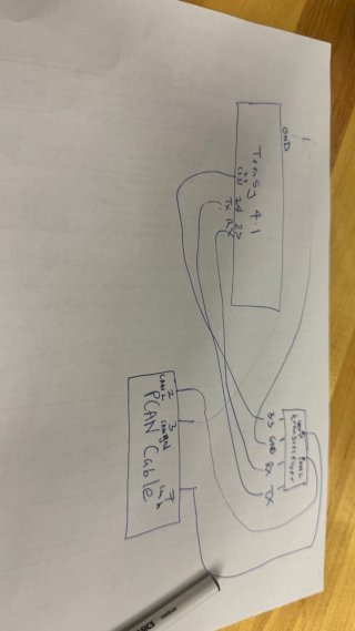

FlexCAN_T4 users and tonton81:
I'm having some difficult with FlexCAN_T4 being able to reliably see CAN messages on the bus when it starts up. When there is traffic on the bus already as the Teensy 4.1 boots up, it sometimes can't receive it, as though the FlexCAN_T4 library didn't start up well. When there is not traffic on the bus, and I power up the Teensy 4.1, then start the can bus traffic simulator, it more reliably begins to receive CAN messages. This is a closed, known can bus with only a few devices and my Teensy 4.1 is a monitoring and logging device, so it wants to receive and process every can bus message, and therefore no filtering is necessary. I am simulating the messages with a Peak Systems USB-CAN device and their PcanView software on my PC, because I don't have access to the actual hardware devices that will be on the monitored can bus. This means that the USB-CAN simulator and my Teensy 4.1 are the only devices on the can bus now. If the Teensy 4.1 board is off, the PcanView software of course shows that the bus has gone error passive but it keeps transmitting indefinitely.
My software follows the example from the FlexCAN_T4 library:

and in function PdbCanSniff I'm extracting the CAN bus id, length, and payload data from the (const CAN_message_t &canMsg). I do some serial.print debugging to show the incoming can bus contents on the serial monitor and flash the Teensy 4.1 board light faster when its receiving can bus messages so I can tell reliably when it starts up whether its getting can bus messages or not.
Has anybody experienced this behavior or have ideas how to chase it ? I need it to start up reliably whether there is already can bus traffic or not.

I'm not very familiar with Peak tools, but in CANalyzer you can have the tool ACK its own tx messages to keep the bus from going into an error state while it is the only device on the bus. If you could do this, it could help narrow down if the problem is starting up on an active bus vs starting up with the transmitting node in the error-passive state.
https://forum.peak-system.com/viewtopic.php?t=7267
If this option isnt supported, could you use another teensy or any device with correct baud rate to ack messages until the problem device comes online (just for testing, of course).
-Mike
msadie, thanks for the idea, I'm looking at that. Turns out my Peak USB/CAN device can't do self ack unless I upgrade the firmware in it, so I'm looking at that and/or putting another teensy 4.1 on the can bus. Will report results so the group can benefit.
I submitted a bug report to the github repo issue reporter. I can't provide an example program at the moment, but has anyone experienced something similar?

As usual when having problems on CAN:
twisted pair cable ?
120 ohms resistors at both ends ?
3.3V transceiver ?
good power supply decoupling on the transceiver ?
Thank you very much for your answers and questions. I will try to answer them.
I increased the 60mhz because there was an error (also on 24mhz), now I have taken it back to 24mhz, it is still there.
Double 120 ohms are included in the system, they may not be twisted, but ifm factory cables, in the box a very short section that is not twisted.
It was never a problem. We also have another system, particle photon 1. The code is the same (of course, the lower layers are not, but it is on the user side). There are 0 errors with 50k messages (everything else is the same, load level, etc.). In the case of Teensy, without the modification I included, 10k is good, 40k is wrong. With repair 50k good ~70 bad. And I only changed the interrupt.
I wrote out the messages in writeTXmailbox. Before calling write(), I wrote out what I would send and what writeTXmailbox would copy to canbus. What is sent is already changed in the writeTXmailbox. Sent (which I read on canbus) and writeTXmailbox are the same. However, write() and writeTXmailbox() do not. That's why I suspect there is something else wrong and not in the canbus network.
sorry, I understand the mesarments, but my translater who helps me, she doesn't know and I did not check it.
please, forgive me the mistakes of the traslation.

My next step is to transmit a message to the canbus for UDS data, I have successfully completed this with a cansniff box.
However I now need to do this with my setup.
I have a Teensy 4.1 with 2x MCP2551 can transceivers. These are setup with a level shifter to ensure no overvoltage on the teensy. At the moment they are just setup to talk to each other before i get into the car integration. I am having an issue where the sent message gets stuck in the transmitting mailbox and never gets sent to the bus or recieved by the other transceiver. This leads me to believe there is no ACK happening for this message. The bus resistance is 60 ohms with 2x 120 ohm terminations on each end.
C++:

The serial output is as below:
CAN1 STATUS
FIFO Disabled
        Mailboxes:
                MB0 code: RX_EMPTY      (Standard Frame)
CAN2 STATUS
FIFO Disabled
        Mailboxes:
                MB0 code: TX_DATA (Transmitting)(Standard Frame)(ID: 0x6F1)(Payload: 12 4 2C 10 0 91 C2 0)
Here is my setup:
