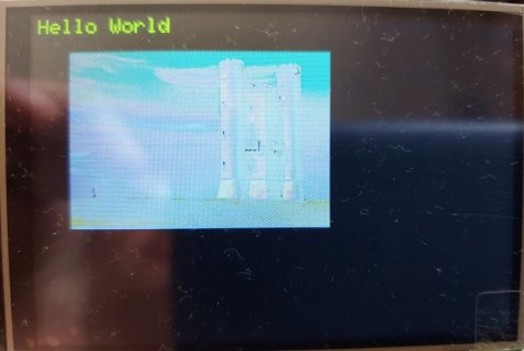

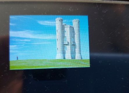

Thank you for your prompt reply! Did you watch my video? The code initially runs smoothly. Only when the display gets warm, with high outside temperatures, does it start to look like in the video. I think it is due to some parameters in the initiation of the display, wrongly configured voltages? You can find the init comands at github in my repository Ili9486 if you want to see it.
So now I had time to take care of the problem. The solution was to adjust the init_commands for Power control 1 (C0h). The standard parameters are obviously not good. I have set both parameters from 0Eh to 17h. Now it runs without flickering.

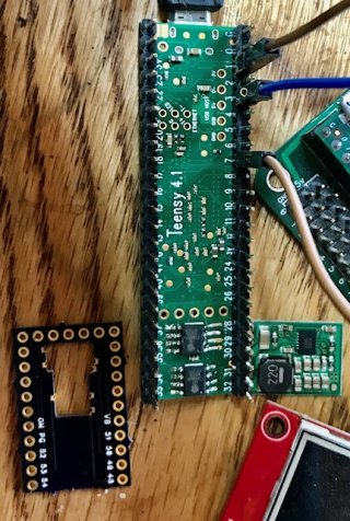

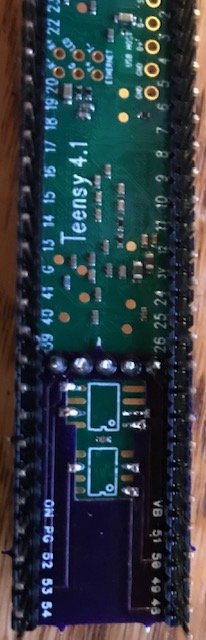

As for the bottom 7 pins, I did a quick and dirty castellated add on board to solder to those pins, plus the 5 internal pins: program... and brought those out to be breadboard compatible...
I built one of them to be able to do testing using those pins.
Here is showing the actual small board with other T4.1 that has chips...
If I were to do more of these, I probably would have made the center ones line on/off with pads cut in half like the others, so that they can solder in castellated as well.
But for my test setup works OK.

I have a Teensy 4.1 and I am using 3.5inch Waveshare LCD (A) display (for RPi) with @sepp89117 ILI9486_t3n library.
https://github.com/sepp89117/ILI9486_RPi-t4
Everything works for me:
tft.setRotation (3);
tft.fillScreen (ILI9486_BLACK);
tft.setTextColor(ILI9486_YELLOW);
tft.setTextSize (2);
tft.println ("Hello World");
The only thing that fails me is to visualize the "picture" with the right colors.
If I try to visualize a picture with "writeRect", it is displayed with wrong colors.
tft.writeRect(32, 33, 256, 174, (uint16_t*)picture);
The colors in the image should be:
Any guide to solve this problem?

Thank you very much @KurtE for all your observations.
The screen that I am using Waveshare LCD (A), when I use it with the RPi and the command "dmesg" shows the ILI9486 controller.
I already did the test with only solid colors and everything is OK, RED is RED, GREEN is GREEN...
I keep analyzing the library code and doing more tests.
I managed to get it to work with LCD (A),
basically there are two changes:
1. Change the speed from 80e (LCD (C) is fast) to 30e (LCDC (A) is slower)
2. The startup sequence (init_commands) for the LCD (A) is a bit different and I used the one from @palmerr23
