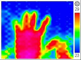

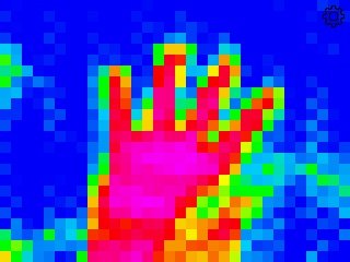

raw display where each pixel is scaled to a 10x10 rectangle
Interpolated image with gradient legend

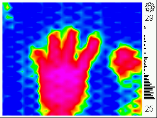

Interpolated image with histogram legend
