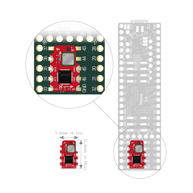

I finally got around to designing and testing a MPU9250+MS5637 add-on for Teensy 3.6. It was a challenge to design a board with a 2 x 5 pattern of pads rather than the 2 x 6 pattern available on the Teensy 3.1/2. I kept the board two layers since I wanted to take advantage of the 0.8-mm-thick pcb option available at OSH Park for easier mounting. I used low-temperature solder paste and a hot air gun to assemble and solder the board to the Teensy 3.6. The board looks like this:

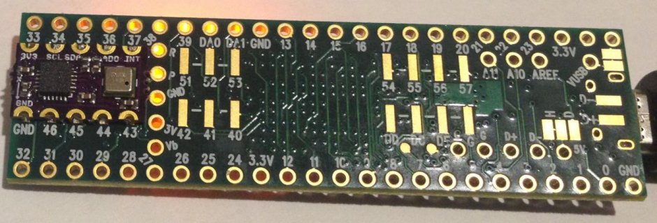

and when mounted onto the Teensy 3.6 it looks like this:
I verified the ADO address pin and the interrupt work as expected. I designed the board to use I2C only even though it would be possible (but challenging on a small 2-layer board like this) to wire it for SPI instead. I2C at 400 kHz is plenty fast for anything I would do with these sensors. A simple sketch configures the sensors, reads the data, performs the Madgwick (or Mahony) sensor fusion and outputs everything to the serial monitor.

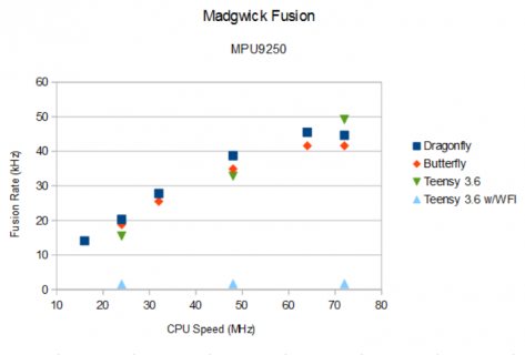

With this change I recover the much faster fusion rates I had measured and reported before. Now we can take another look at fusion rates verses current draw for the above devices:
You can see that the fusion rates and current draw scale approximately linearly with CPU speed for all devices and that the current is highest for the Teensy 3.6 and lowest for the Butterfly STM32L433. Part of the reason for the slightly lower current for Butterfly compared to Dragonfly is the fact that Butterfly does not have a 16 MHz crystal.
In all cases, the fusion rate is way more than it needs to be. Ideally, one would like to run this kind of steepest-descent-like fusion algorithm at a rate ~5 - 10 times that of the data rate in order to reach convergence before the next new data sample arrives. This means for a 200 Hz accel/gyro rate like we are using here a Madgwick rate of no more than 2 kHz is sufficient.
I took advantage of the WFI command available for the Teensy 3.6 and simply invoked it after the loop counter exceeded 10 in the sketch, this pegs the fusion rate at about 10 times the average data rate (the mag is sampled at 100 Hz) and results in a measured fusion rate of 1.7 kHz more or less independent of CPU speed, just about right, while the current draw is significantly reduced. I added the equivalent STM32.sleep(); after ten loop counts and succeeded in significantly reducing the Butterfly current draw (by 33% at 72 MHz!) while maintaining the same ~1.7 kHz Madgwick fusion rate; it is power management methods like this that will be required to get the average usage down below 1 mA.

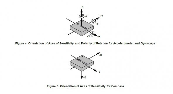

I see you've labelled with the X and Y axes directions for the Accel/Gyro. Maybe you know already, but aware that Invense in their wisdom mounts the magnetometer with different alignment. It has with X + Y swapped and +Z is down (up for Accel/Gyro). See the attachment, from the datasheet page 38 figures 4 & 5.
