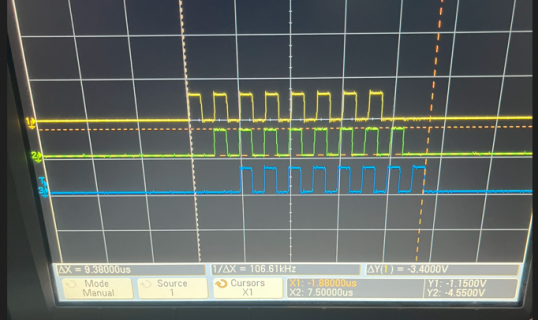

Hi all,
I have 3 separate slave devices that I'm intending to use with the 3 sets of SPI on the Teensy 4.0. Speed is very important here. I'm looking to send data to each slave device at the same time. I've looked into to TeensyTheads.h library and have tested a bit, but haven't got it to work. Is it possible to have three separate sets of SPI transfer data at once? Any help/advice would be greatly appreciated!
The three SPI modules operate independently of each other and separate from the main program once a transaction has been started. It's possible to do something like this:

The transfers will overlap and be simultaneous within a couple of instruction cycles. No need for threads. Either use interrupts or a timer to send data at the desired intervals.
EDIT: My apologies, this is still a sequential send. If anyone knows how to bypass the transfer() "waiting until finished' please chime in. I do this sort of thing all the time with other MCUs. Probably need to write directly to the SPI registers.
The standard SPI functions block for the time taken to send the data since they are also reading the reply.
The actual hardware has a buffer so if the only time critical situations are fairly short writes you could write the data into that buffer directly and then exit and let the hardware handle the transfer. Looking in AppData\Local\Arduino15\packages\teensy\hardware\avr\1.59.0\libraries\SPI\SPI.cpp the function void SPIClass::transfer() (around line 1686 for teensy 4) looks to load data into the buffer and then has a section commented as
// now lets wait for all of the read bytes to be returned...
If you were to create a transfer_WriteOnly function that was identical to the normal transfer function but without the read half then I suspect it will return a lot faster. You would also have to be careful that the chip select line was cleared at the correct time. e.g. if the transfers are all the same size then transfer the first two without waiting for the read, transfer the 3rd waiting for the read and then clear all 3 selects once that finished.
Also looking in that file there are also some DMA based asynchronous transfer functions. I don't know if there is any documentation on those but I suspect if you can get them to work they should do what you need. That would also allow you to perform multiple reads in parallel.

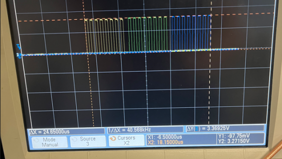

I used your advice and simply removed the parts after the read bytes comment.
C++:
void SPIClass::transfer_writeOnly(const void * buf, void * retbuf, size_t count)
    if (count == 0) return;
    uint8_t *p_write = (uint8_t*)buf;
    uint8_t *p_read = (uint8_t*)retbuf;
    size_t count_read = count;
    // Pass 1 keep it simple and don't try packing 8 bits into 16 yet..
    // Lets clear the reader queue
    port().CR = LPSPI_CR_RRF | LPSPI_CR_MEN;    // clear the queue and make sure still enabled.
    while (count > 0) {
        // Push out the next byte;
        port().TDR = p_write? *p_write++ : _transferWriteFill;
        count--; // how many bytes left to output.
        // Make sure queue is not full before pushing next byte out
        do {
            if ((port().RSR & LPSPI_RSR_RXEMPTY) == 0)  {
                uint8_t b = port().RDR;  // Read any pending RX bytes in
                if (p_read) *p_read++ = b;
                count_read--;
        } while ((port().SR & LPSPI_SR_TDF) == 0) ;
The before and after clock cycles are shown below. Thank you for your help! Now, I want to see if I can go even faster...

Thank you for all this information. I'm kind of a noob and tried to implement your second example in my own code. It's shown below.
C++:
#include <EventResponder.h>
uint32_t fclk_w = 1000000;
unsigned int numbytes = 0;
uint8_t RXdata[512];
const int chipSelectPin = 10;
// clk is 13
// data is 11
// clk1 is 27
// data1 is 26
// clk2 is 37
// data2 is 35
//#if defined(__IMXRT1062__)
//extern "C" uint32_t set_arm_clock(uint32_t frequency);
#ifdef SPI_HAS_TRANSFER_ASYNC
    bool transfer(const void *txBuffer, void *rxBuffer, size_t count,  EventResponderRef  event_responder);
EventResponder event;
EventResponder event1;
EventResponder event2;
int buffer0[100];
int buffer1[100];
int buffer2[100];
int rxdNum[1];
int rxd1Num[1];
int rxd2Num[1];
volatile bool spi_active = false;
volatile bool spi1_active = false;
volatile bool spi2_active = false;
void Event_SPI0_Responder(EventResponderRef event_responder) {
  SPI.endTransaction();
  Serial.println("SPI0 ended");
  spi_active = false;
void Event_SPI1_Responder(EventResponderRef event_responder) {
  SPI1.endTransaction();
  Serial.println("SPI1 ended");
void Event_SPI2_Responder(EventResponderRef event_responder) {
  SPI2.endTransaction();
  Serial.println("SPI2 ended");
  //set_arm_clock(800000000);
  Serial.begin(115200);  //configure serial port to 115200 baud
  while (!Serial) {
    ;  // wait for serial port to connect. Needed for native USB port only
  //Serial.println(F_CPU_ACTUAL);
  pinMode(chipSelectPin, OUTPUT);
  // initialize SPI:
  SPI1.setMOSI(26);
  SPI1.setSCK(27);
  SPI2.setMOSI(35);
  SPI2.setSCK(37);
  SPI.begin();
  event.attachImmediate(&Event_SPI0_Responder);
  for (uint8_t i = 0; i < sizeof(buffer0); i++) buffer0[i] = i;
  SPI1.begin();
  event1.attachImmediate(&Event_SPI1_Responder);
  for (uint8_t i = 0; i < sizeof(buffer1); i++) buffer1[i] = i;
  SPI2.begin();
  event2.attachImmediate(&Event_SPI2_Responder);
  for (uint8_t i = 0; i < sizeof(buffer2); i++) buffer2[i] = i;
  digitalWrite(chipSelectPin, LOW);
#else
  // set_arm_clock(24000000);
  while (!Serial) {
  // initialize SPI:
  SPI.begin();
  if (Serial.available() > 0) {
    Serial.println("spi test started");
    String rxd = Serial.readStringUntil(',');
    String rxd1 = Serial.readStringUntil(',');
    String rxd2 = Serial.readString();
    rxdNum[0] = rxd.toInt();
    rxd1Num[0] = rxd1.toInt();
    rxd2Num[0] = rxd2.toInt();
    digitalWriteFast(chipSelectPin, HIGH);
    spi_active = true;
    SPI.beginTransaction(SPISettings(fclk_w, MSBFIRST, 0));
    SPI.transfer(rxdNum,nullptr,sizeof(buffer0),event);
    spi1_active = true;
    SPI1.beginTransaction(SPISettings(fclk_w,MSBFIRST, 0));
    SPI1.transfer(rxd1Num,nullptr,sizeof(buffer1),event1);
    spi2_active = true;
    SPI2.beginTransaction(SPISettings(fclk_w,MSBFIRST, 0));
    SPI2.transfer(rxd2Num,nullptr,sizeof(buffer2),event2);
    //while(spi_active || spi1_active || spi2_active);
    digitalWriteFast(chipSelectPin, LOW);
    Serial.println(rxd);
    Serial.println(rxd1);
    Serial.print(rxd2);
However, I'm not able to generate any SPI signals (I can't see anything on my scope). I'm not 100% sure what I'm doing wrong. Any help would be appreciated!
Sorry did not have time today to fully diagnose the issue. But I dos see some issues with the code, although
I would think you would still see something.
int buffer0[100];
int buffer1[100];
int buffer2[100];
int rxdNum[1];
int rxd1Num[1];
int rxd2Num[1];
    spi_active = true;
    spi1_active = true;
You pass in rxdNum to be sent and nullptr which is fine it says you don't care about what is returned. But then you say you wish to transfer
sizeof(buffer0) bytes or 100. But you are not using buffer0 at all here. and rxdNum is 1 byte long.
I believe you are using default pins, so you don't need to use the setMOSI and the like.
I would add some more debug outputs, that print out what you are trying to send. As to make sure your code is actually calling off to the SPI.transfer statements.
int buffer0[100];
int buffer1[100];
int buffer2[100];
int rxdNum[1];
int rxd1Num[1];
int rxd2Num[1];
    spi_active = true;
    spi1_active = true;
Wow cool, that essentially gives SPI almost DMA speed but not messing with all the DMA thing
