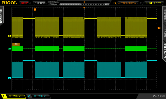

I'm going to be getting data from i2c slave devices that can be hot plugged in and out (bad idea, I know), so I've been playing around with a way to make sendTransmission and sendRequest recover from bus lockups (I was running into them during testing).
In the library commented out the two instances of:
while(*(i2c->S) & I2C_S_BUSY);
Then, in my program, I accessed my i2c device with code similar to this (proof of concept):
     if(Wire.done()){
      if (millis() - last_sample > 50){
        Wire.sendRequest(target,256,I2C_STOP);
        last_sample = millis();
        count = 0;
      //set timeout here
      if (millis() - last_sample > 1000){
        //change i2c pins back to digital IO
        pinMode(19,OUTPUT);
        pinMode(18,INPUT);
        //watch for sda to go high
        //try pulsing the clock a max of 9 times
        while (digitalRead(18) == 0 && count < 10){
          //pulse clock once
          digitalWrite(19,HIGH);
          digitalWrite(19,LOW);
          count++;
        //try to restart wire using initial settings
        Wire.begin(I2C_MASTER, 0x00, I2C_PINS_18_19, I2C_PULLUP_EXT, I2C_RATE_2400);
It seems to work, but I need to clean it up so everything isn't hard-coded, maybe factor out some bits and put it in a copy of the library. And I'm pretty sure this breaks all multi-master support.
I'm thinking that there really should be a delay between the digitalWrite commands proportional to the I2C rate, especially for slower devices, or maybe this delay could be handled by banging out the clock slowly over repeat calls so as not to block.... I'll have to think about it.
Any thoughts?
IIRC the library already has a timeout-&-restart feature to deal with bus lock- ups.
Some I2C hardware is designed to be hot pluggable e.g. Some I2C bus buffers allow hot plugging devices on the bus.
The timeouts in the library seem to only deal with slaves that go silent and disappear, I want to handle slaves that disappear and come back thinking they still need to send some data (and are trying to hold SDA low).
I Suppose I could also detect if something is holding SCL low, but there isn't anything that could be done about it (other than generate an error).
I probably shouldn't be commenting out "while(*(i2c->S) & I2C_S_BUSY)", I could add an adjustable timeout like everything else.
I realized that modifying the library would be a bit out of the scope of my quick little project, so I did what needed externally.
Here is an quick and dirty example that is non-blocking (As long as you stick to the non-blocking functions) and can recover from SDA being left down by a slave trying to send data.
View attachment master_example.ino
The only modification I did to the library (6b) was to comment out "while(*(i2c->S) & I2C_S_BUSY)".
You may need to add in a mechanism to slow down the bit-banging of the recovery clock depending on the devices you are using.
Initially I based my reset off of this: 3.1.16 Bus clear
Page 20: "If the data line (SDA) is stuck LOW, the master should send nine clock pulses. The device that held the bus LOW should release it sometime within those nine clocks. If not, then use the HW reset or cycle power to clear the bus."
That seemed to catch a lot of the problems, but occasionally it would still lock up afterwards with both SDA and SCL high.
Then I found this: Solution 1: Clocking Through the Problem
Page 2: "It is the master’s job to recover the bus and restore control to the main program. When the master detects the SDA line stuck in the low state, it merely needs to send some additional clocks and generate a STOP condition. How many clocks will be needed? The number will vary with the number of bits that remain to be sent by the slave. The maximum would be 9."
OK, so I need to bit bang a STOP condition... K20 Sub-Family Reference Manual
Page 1185: "The master can terminate the communication by generating a STOP signal to free the bus. A STOP signal is defined as a low-to-high transition of SDA while SCL is asserted. The master can generate a STOP signal even if the slave has generated an acknowledgement, at which point the slave must release the bus."
My final code looks like this:

This is an interesting idea. The overall idea seems reasonable, although pulsing single clocks instead of blocks of nine might be better. I don't know if it makes sense to roll this into the main library calls or if it is better served as an example. I could add this technique as a bundled example.
The trouble with incorporating this as a part of the library is that it is specific to a particular setup (single master, immediate call). By making the library call immediately exit if busy, it requires the user code to expect this situation. I'm wondering in particular about background calls where it is used in more of a launch and forget manner. I'll need to think about this some more.
Regarding the STOP I don't know if a bit-bang solution can work. That would require muxing the I2C peripheral off the pins, do the bit-bang, and then muxing it back in (however it's internal state might still think it is in a busy state). I'll try and study this and see if there is a clean way to exit this stuck condition.
While I seem to have it working, my solution doesn't seem to agree with the datasheets... I ended up doing a lot of trial and error until I could get the bus to reliably recover. After I got it working well enough, I set up a little machine with relays to continually connect and disconnect SDA and SCL quickly for a few hours as a stress test. Not very scientific, but it survived, which is good enough for me.
I also had to add a status reset to the start of begin() to prevent some other lockups.
Attached is the scope outputs between two Teensy 3.1s. I was able to get about 700kbit/s half duplex (with no CRC8 errors), with a bit of bus time unused. The master uses about ~8% of the CPU time on a 96mhz Teensy 3.1, but it's difficult to measure with only micros().
