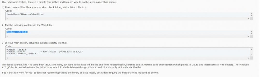

Hmm, This is what I tried, something from an earlier post of yours.
I have used your fine i2c_t3.h library in many other Teensy projects, but can't in this one because the various V53L0X libraries use Wire.h

You can't include both <i2c_t3.h> and <Wire.h>. Include <i2c_t3.h> only.
If other libraries include <Wire.h>, the only way is replacing every Wire.h with i2c_t3.h across every source of the project/library.

Here's a dirty hack that might help you to test in the short-term:
- if you're on a Windows machine, rename the offending "Wire.h" file (to something else, maybe oldWire.h")
- in place of the previous "Wire.h", create a shortcut named "Wire.h" that points to "i2c_t3.h"
- if you're on a linux machine, do a similar thing, creating a soft link instead

At least in the past you needed to define TwoWire also:
typedef i2c_t3 TwoWire;
