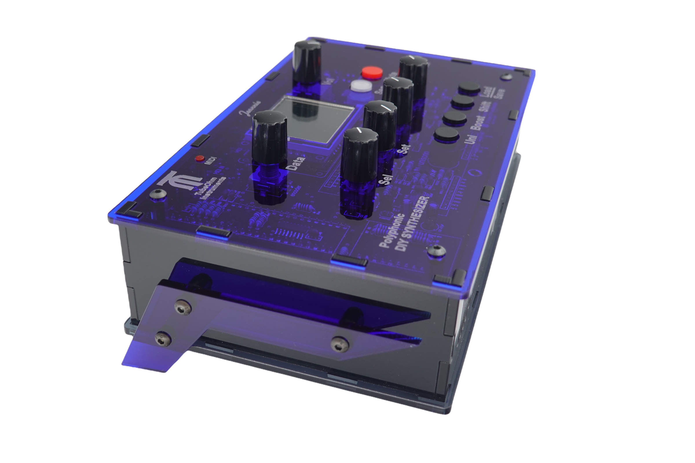

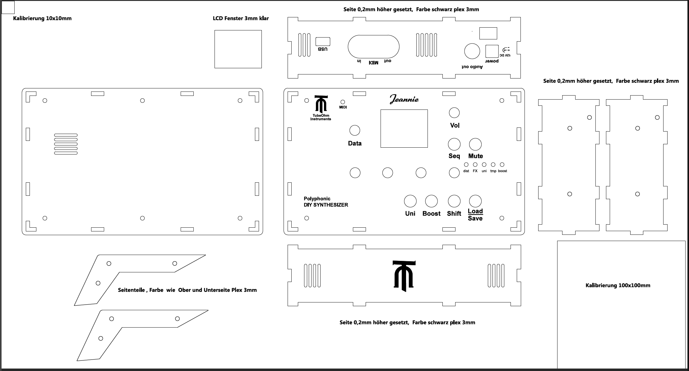

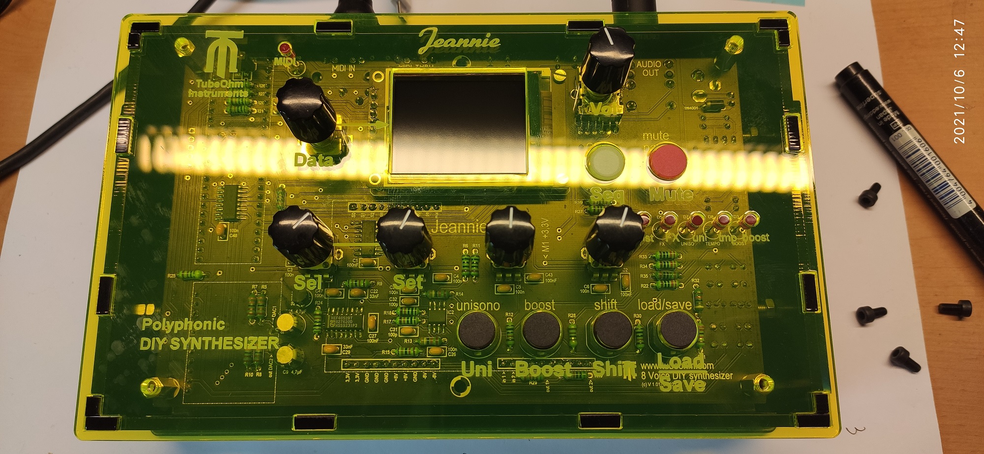

The housing construction is ready and will be ordered in the next few weeks. It becomes a transparent one
and colored housing with support feet (similar to the one in the picture).

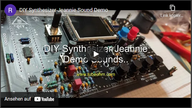

Do the same again on Youtube if it doesn't work on Soundcoud. Everyone has.
In the future I will only upload the sound to Youtube. I am not aware of any other free,
unlimited and free platform for music.

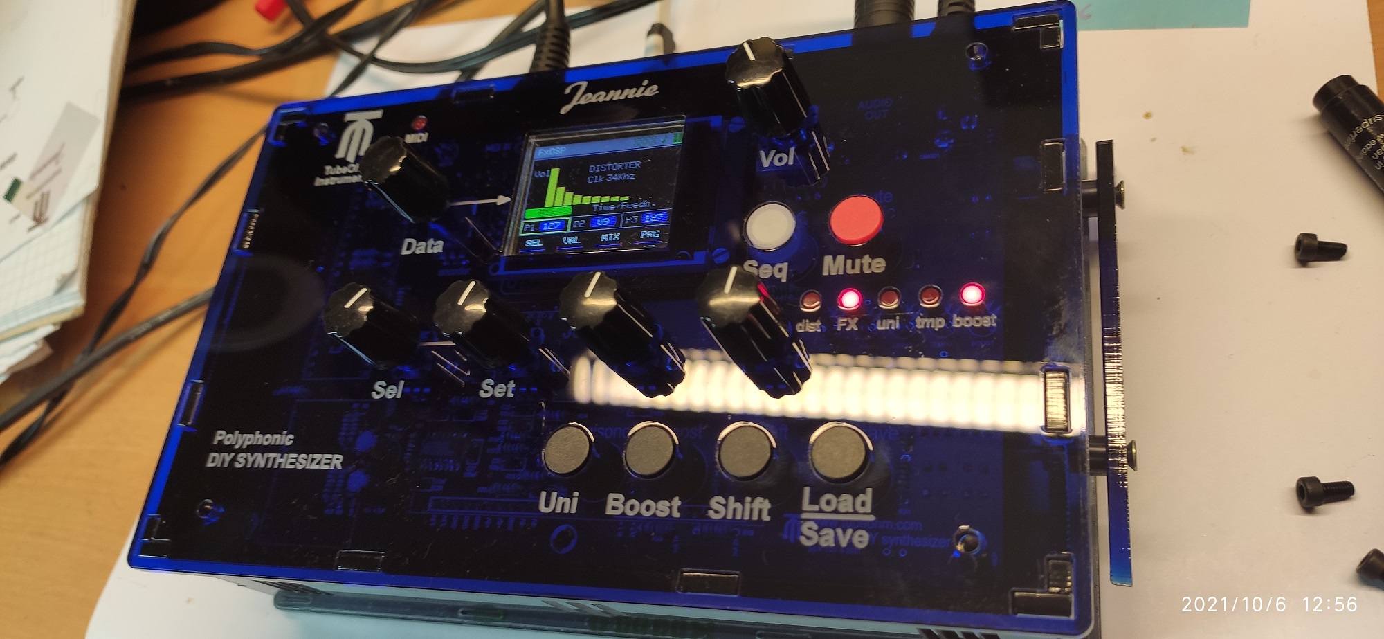

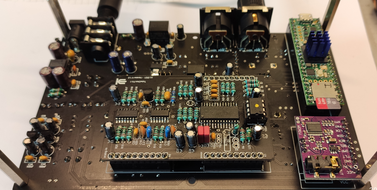

The new Jeannie Panel Board has arrived from China. Andre has now soldering the board and
tested. It all works wonderfully. The DIY manual is also almost ready. Now that's all that's missing
Housing and then we're done.

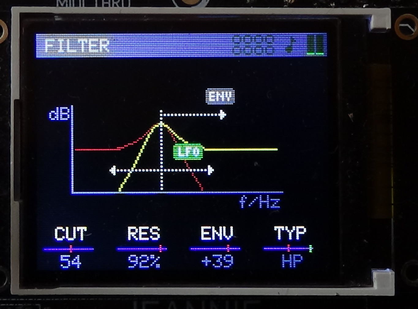

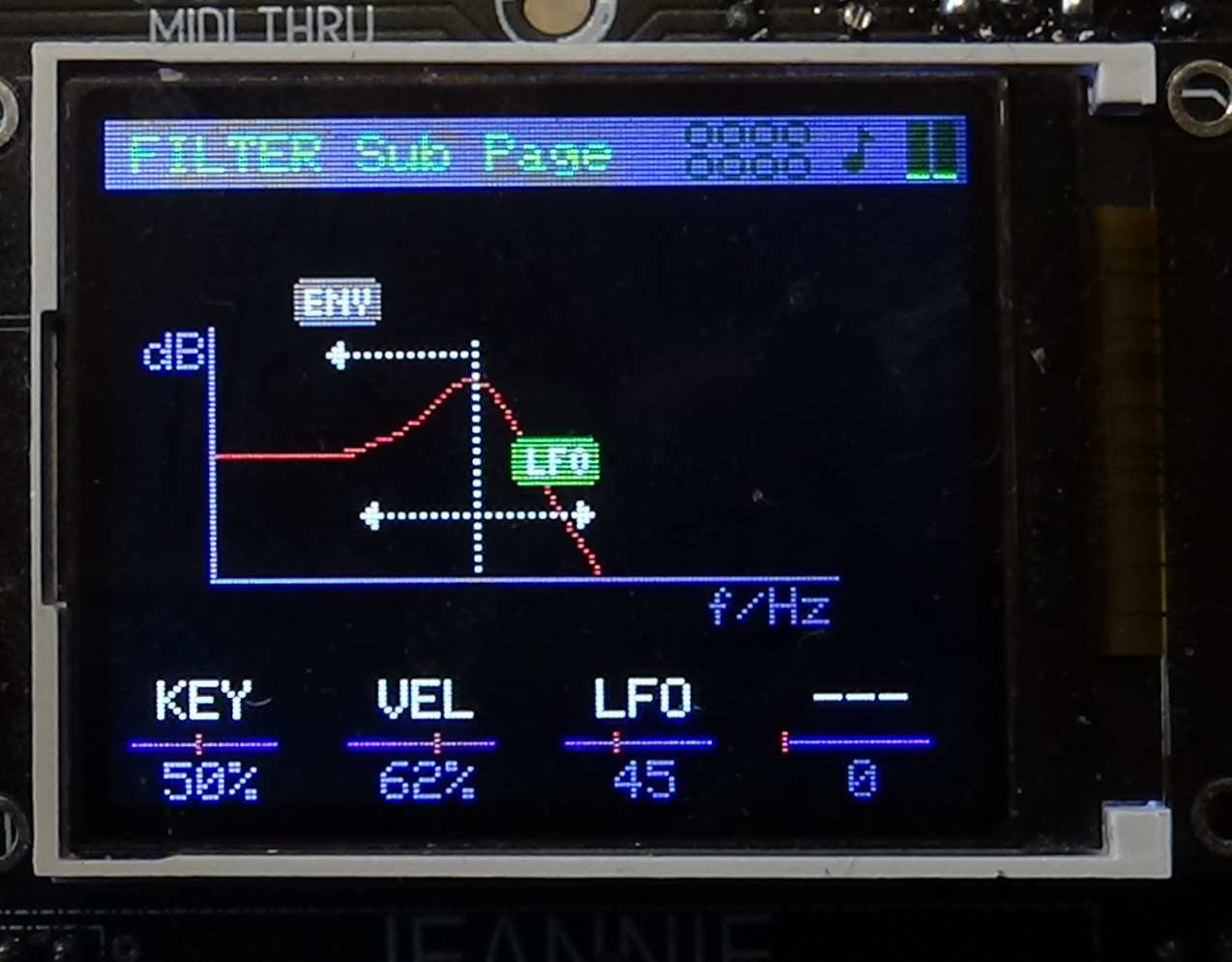

I changed the filter page a bit. Instead of "AMT" I have "ENV" as
Parameter designation selected. The red marker for CUT is now also available.
FilterMix LP / HP (LP red / HP yellow)
A filter submenu can be reached using the Shift key. Then you can
Set the filter velocity, key tracking and LFO modulation strength.

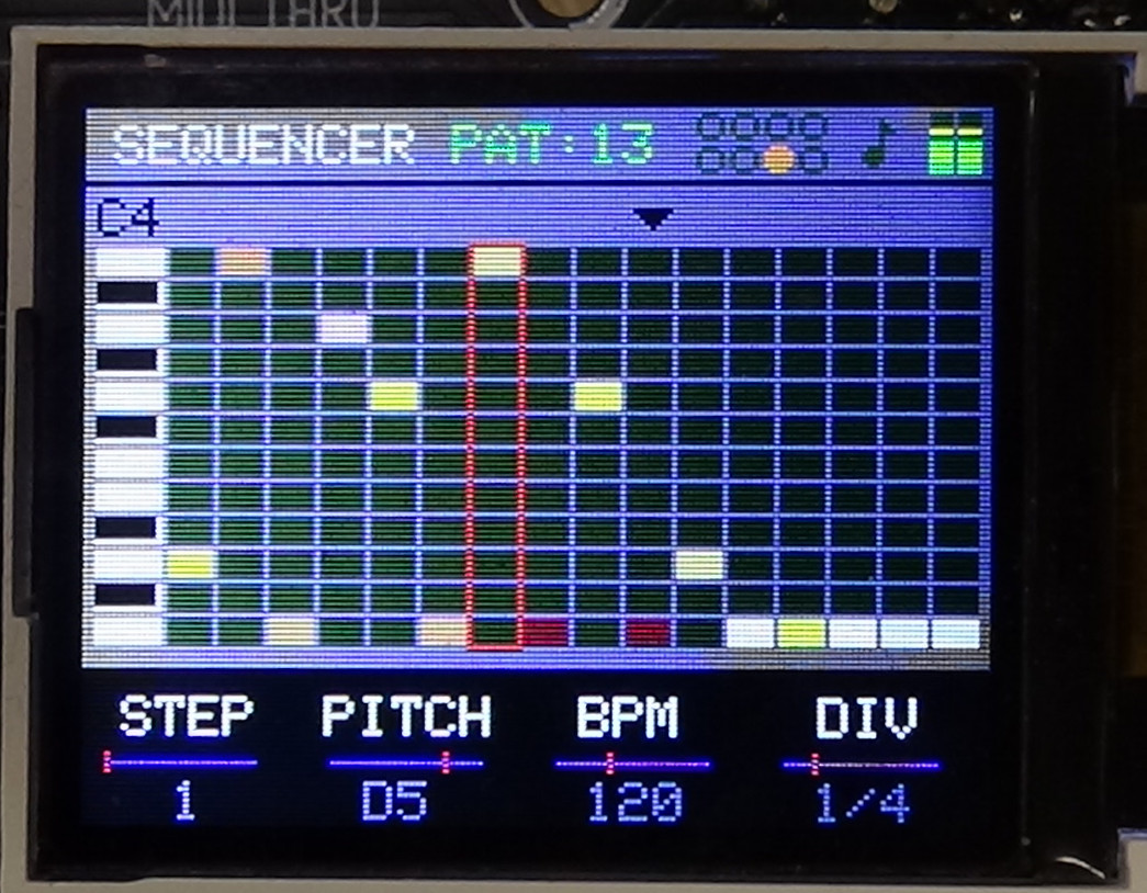

Software changes in the sequencer
The sequencer record function now records velocity values when playing the notes on the keyboard.
The volume of the notes corresponds to a color. The lighter the color, the louder the note.
A poly-mode sequencer is also planned. After all, we have an 8-voice synthesizer.
A maximum of 4 notes are saved in one step at the same time.

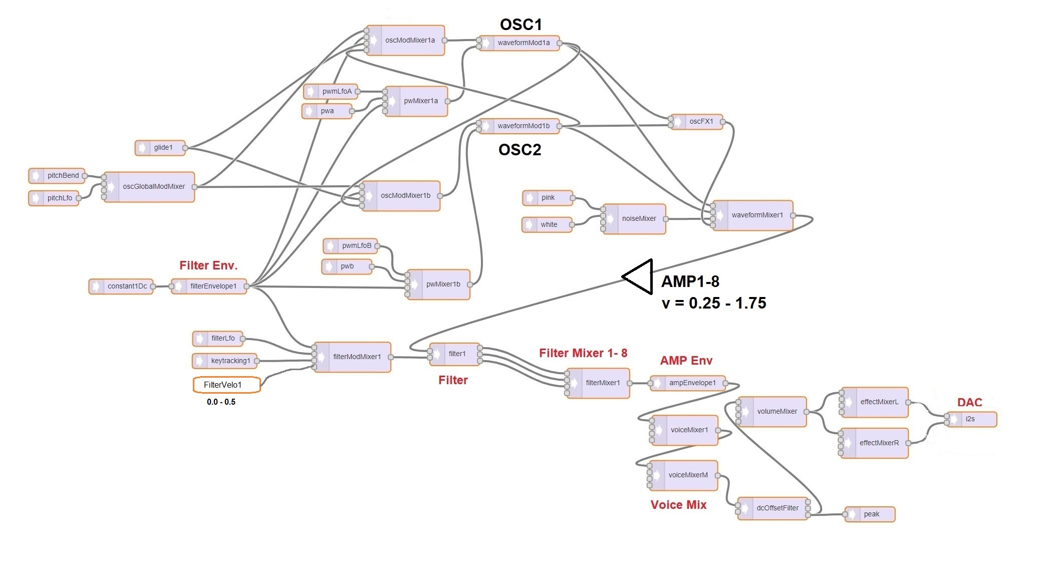

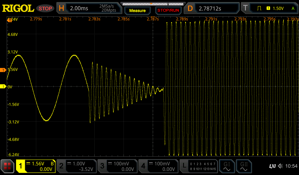

I have a problems with the releaseNoteOn function (5ms) in my polyphonic DIY Synth.
If the releaseNoteOn phase were the new note will be played (see picture).
I'm using Teensy 4.1 and the latest Audio Lib. Release Phase is 4.4sec long.
Play 8 voices is good and Click the 9th note and the following
The sequencer now has a mode function.
In mode: REC, notes are received from a connected midi keyboard.
The pitch of the notes can then be edited with pitch or muted with mute.
In mode: TRP, the sequencer notes can be transposed using a midi keyboard.
In mode: KEY you can play additional notes via a midi keyboard.
