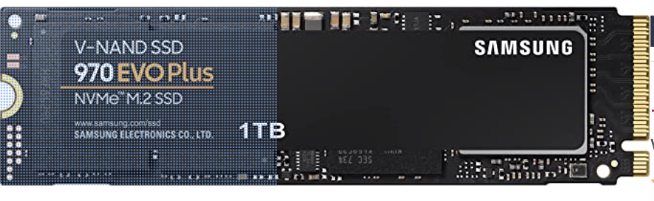

Whatever is going wrong, I'm a bit skeptical to believe it's primarily explainable by the thin size of the PCB. Many millions of M.2 form factor SSDs are made with PCBs that thickness. Most of them are loaded with BGA chips and other advanced parts.
What's different about the red M.2 board? Screenshot 2023-02-15 at 8.23.21 AM.pngScreenshot 2023-02-15 at 8.27.10 AM.jpgScreenshot 2023-02-15 at 8.26.00 AM.jpgScreenshot 2023-02-15 at 8.22.24 AM.jpg
It could be as simple as the FR-4 material used in MicroMod Teensys having lower flexural modulus (basically Young's modulus), meaning smaller force is required to bend the board.
The PCB on my MicroMod Teensy definitely feels much less stiff than e.g. my Kioxia M.2 2230 NVMe drive and my M.2 NGFF modems (mPCIe, 30x51mm). It is too small a sample to be sure, just a single datapoint. I wonder if SparkFun has tested the flexural modulus of their unpopulated boards, and compared the measurements to the manufacturer datasheets and what is generally available on the market?
At the core (pardon the pun), I think whoever has manufactured the PCB material (substrate? what's the term?) used in MicroMod Teensys may have used less glass fiber and more or weaker epoxy in the PCB construction, leading to even small forces being capable of bending the PCB too much, so that the spring pressure from the M.2 connector when the MicroMod is screwed down to the board, is sufficient to deform the PCB to break connections on the BGA pads. I would definitely do an industry standard flexural modulus test, at small deflections (say, matching those seen in MicroMods in practice), so sensitive equipment is needed (and if the modulus varies as a function of deflection, concentrate on the small deflections).
Note that flexural strength, the amount of force needed to deform the board (so much that it no longer springs back when released), is not involved here. Just the stiffness of the PCB material under bending forces.
