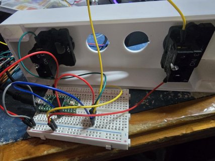

Here is what I have connected. Teensy USB_MIDI is what its set up for.
Teensy 4.0 and not sure how to hook up the buttons. I plugged a push button between pin 0 and pin 1. Nothing happens.

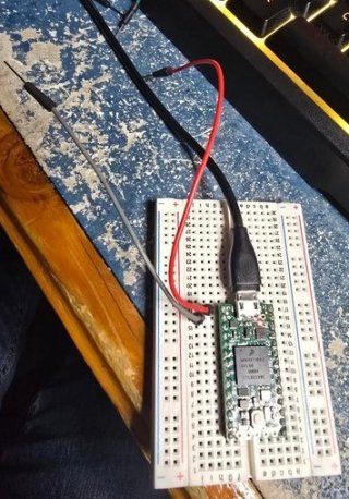

FYI I tried your code on a Teensy 2 connected to Windows 10 and with a piece of wire as a button on Pin 0.
MIDI-Ox on Windows sees the midi messages.
So the code works as advertised. There must be something wrong with how you are detecting the MIDI message.
Pete

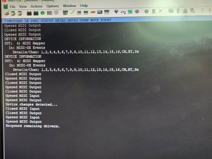

For USB MIDI troubleshooting, have you run something like MIDI-OX (Windows) or "aseqdump" (Linux) which shows ALL MIDI messages your computer receives?
This is important because the MIDI messages that example program transmits may be different from whatever messages are expected by the software you're running on your PC. Much like how you can't see voltage without a multimeter, for troubleshooting whether MIDI is really working you need a program which shows you ALL messages, rather than a program which responds to only some of them and ignores all others.
I got the press button code loaded and when the button is pushed it goes from off to on and stays on. it doesn't turn back off. So Im getting close... midi Ox is for windows. Is there a midi monitor for Mac? I have the Controller attached to wind a
Midi-Ox and this is the message I got. Also Got the buttons to have 8 pressed 7 not pressed.

Looks like your wiring may have some misunderstanding.
Here are 4 specific suggestions:
1: Eliminate this wire to the 3.3V power. Buttons only need to connect between digital pins and GND. Do not use any 3.3V connection, as it is unnecessary and only gives opportunity for things to go very wrong (eg, shorting out the power supply).
2: Every pushbutton connects to GND. Remove these 5 wires, which connect to 2 of the digital pins. Instead, connect all pushbuttons to the GND row on the bottom of your breadboard (where the gray wire is already connected). Check the first photo on this tutorial page for the way breadboard connections are made.
3: Connect the non-GND wire from button #1 to digital pin 0. (or any other digital pin, if you have changed the pin number in the code - but the example program uses pin 0 for the first button)
4: Connect the non-GND wire from button #2 to digital pin 1. (or any other digital pin, if you have changed the pin number in the code - but the example program uses pin 1 for the second button)
Maybe I'm over-thinking things from your photo, but perhaps this wiring may have come from a misunderstanding that 3.3V power is needed for logic high. If so, before you do anything more, please read "Connecting A Pushbutton" on the pushbuttons tutorial page. The critically important concept is about pullup resistors, which provide logic high when the button is normally open. Logic high should NOT come from a direct connection to 3.3V power. For this project, you should connect nothing to that 3.3V power pin!
If you scroll down to "Built In Pullup Resistor", you'll see this suggested wiring and the example code is using the resistors inside the chip, so you don't need to add your own resistors (but using real resistors can give a stronger signal which might help in extremely noisy environments). But understanding the nature of those pullup resistors is important for correctly connecting a normally open mechanical switch.

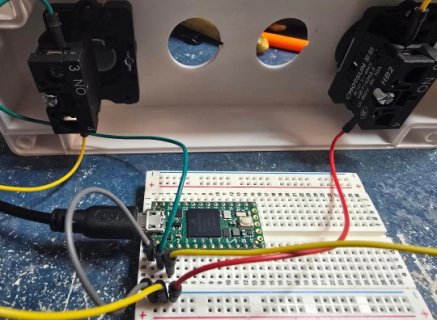

Good morning Gavin and thank you for your response. I have been working on the unit based on the information given, but what I have noticed is there are other components added to the tutorials given. That seems to complicate the basics. Although to many that is basic, but to a newbie like myself, the simplest explanation on the board would be helpful. I did look at the wiring diagram Paul suggested and simplified my wiring. I managed to get the button to trigger on but not off. If my understanding is correct, I believe its because I don't have the 10k resistor in place. I will have those today. Here is a picture of what I have redone today. Once I get this to work properly, then I will deal with the computer recognizing the the board as a midi device. Any help you can give would be greatly appreciated. I really want to learn how to use these boards to the best way possible.
In this latest photo, the button on the left appears to be connected incorrectly. Both of its wires connect to GND. You need to have 1 of its wires connect to GND and the other wire connect to a digital pin.
The button on the right looks good. Its red wire connects to GND, and its yellow wire appears to connect to Teensy digital pin 2.
Please read the tutorial again. It tries to explain the pullup resistor concept.
The main chip has built in pullup resistors, so you can make this work without adding 10K resistors. But the concept is still important to understand. It will only work without the 10K resistors because you are using the resistors that are inside the main processor. The tutorial text tries to explain this concept, so you understand the *reason* it works rather than blindly follow a recipe without knowing why it works. Please, read the tutorial carefully. This information is important to understand.
