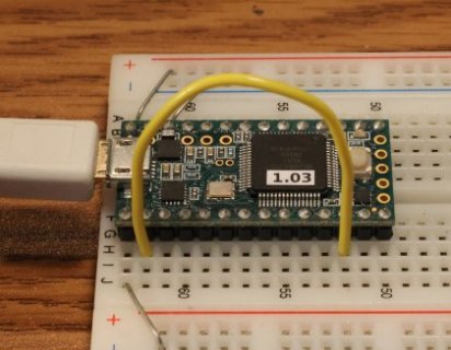

No UART RX, not even when loopback from TX. Teensy 3.2
Hi all!
I have a Teensy 3.2 which I try to use to communicate with my Icom radio over Ci-V at 19200 Baud.
I can transmit and change settings on the radio but even if I loop the TX directly to the RX or to another serial RX I cannot read any serial data.
Do I have to do anything else than just Serial1.begin(19200, SERIAL_8N0); to set up the RX pin as input for data?
I primarily use Serial1 as HW serial port, i.e. connect TX to pin 1 and RX to pin 0. I have also tried a patch between pin 0 and pin 7 and try to read using Serial3 but that don't work either.
I can see with the oscilloscope I have the same waveform at my RX-pin as I have at my TX-pin when sending data over TX manually via the USB interface.
Any suggestion what to try next?

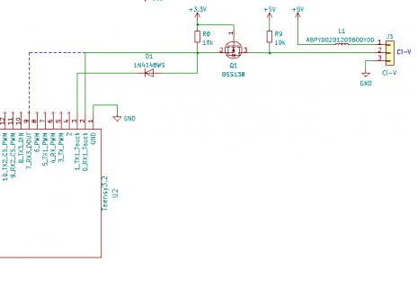

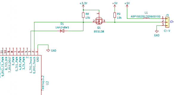

My wireing is as follows. The Icom Ci-V bus is a single wire pulled up open collector bus.
The FET is a level translator of normal kind good for much more than 19200 baud:
The dotted line is my patch for trying to read using Serial3.
My code for initalizing and read/write is as follows:

Looking at the schematic it shows a 'DOT' connection on the Tx and Rx lines going to a single pin on the ICOM end?
The Rx and Tx lines shouldn't be tied together as full duplex on the Teensy side?
Assuming the GND is common to both devices.

Somre reason, my gut does not like your schematic. Looks like when you output something out the TX pin it is trying to go through the diode ... Could be right but feels wrong.

Kurt: The diode to the TX line is to emulate an open collector, i.e. When TX is generating 3.3V nothing goes out of through the diode. The line is however high due to the pull-up resistor. When the TX is low, close to ground, the 3.3V through the pull-up is grounded through the diode and hence the signal is low. It is a kind of wired OR. Open collector is a bus where multiple drivers may pull the line low but only the pull-up can drive the line high.
The only drawbacks are that the low-level on the bus will be whatever the diode has as forward voltage and the rise time is dependant of the pull-up resistor value in combination with the total capacitance of the bus. I'm using an 1N4148 diode to the TX and my problem is not with the TX but the RX.
The FET construction is a well known level converter design. Google "level converter FET" and you will find loads of information.

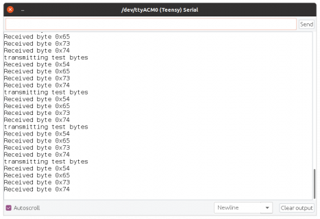

From the tone of your question, I'm getting the impression you might believe Teensy's Serial1 receive code is buggy or otherwise doesn't work as it should. You could pretty easily do a simple test, but for the sake of fully answering your original question I put a Teensy 3.2 on a breadboard with a wire from TX2 (pin 10) to RX1 (pin 0).
Then I wrote this very simple test program which transmits bytes on Serial2 and prints info about anything is receives on Serial1.
  Serial1.begin(19200, SERIAL_8N1);
  Serial2.begin(19200, SERIAL_8N1);
elapsedMillis timeout;
  // show everything Serial1 receives
  int c = Serial1.read();
  if (c != -1) {
    Serial.print("Received byte 0x");
    Serial.println(c, HEX);
  // every second transmit bytes on Serial2
  if (timeout > 1000) {
    Serial.println("transmitting test bytes");
    Serial2.print("Test");
    timeout = 0;
Here is the result I see in the Arduino Serial Monitor when I run it.
Clearly Serial1 is receiving the bytes transmitted by Serial2. You can see the only code needed was Serial1.begin() and Serial1.read().
I ran this test with Arduino 1.8.19 and Teensyduino 1.58-beta3 (latest beta), though 1.57 (latest stable) should also work.

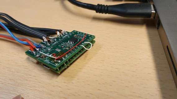

Now it is time for me to admit I'm a complete idiot!
I wrote a simple test program yesterday that only activated Serial3 and soldered a wire between RX and TX and nothing worked. While answering your question I took a photo of my board and while looking at the photo I found what is my issue. Stupid me!
My design has to have a low profile so I soldered connections directly between my main board and the Teensy but kept the actual soldered wires as few as possible to make it as easy as possible to desolder the Teensy after the first prototype... I realized when looking at the image I had not connected the RX from the Teensy to my main board.
I know it was stupid, and I'm really sorry for taking up your time with such a trivial problem.

This is my prototype board with a bunch of patches... The Teensy is mounted under the board to allow me to access the component side of my main board during development.
