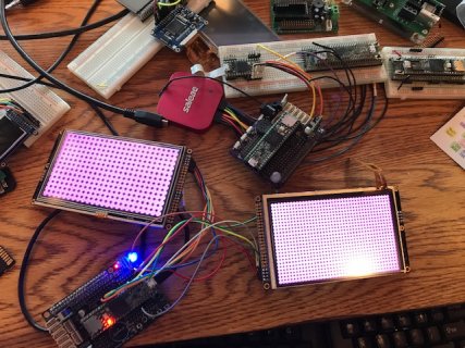

@neurofun @mjs513 - I was also going to suggest, disconnecting everything from that T4, plug it in and hold the program button in for 15+ seconds, and see if the dim LED turns on, hopefully within 30 seconds, if so, release the button, and the LED should get brighter and then it should reprogram the T4 back to the shipping blink program.
And also like I suggested with @mjs513 I would double check the display and make sure it was shipped configured for 5V and 4 wire SPI. Although since it worked on T3.6 I assume so.
And as @sumotoy I believe said on his Wiki, that don't try to run the 7" using USB power... So if all else fails, maybe try rebooting your computer. Maybe the USB was overloaded and shut off... I hit that a few times, where my computer will complain about something overloaded USB...
My 4.3" display works perfectly with T4, without the fastio setup.@neurofun
As a test I just tried my 4.3in display using a 5v Anker power bank as an external power source to the display. Have fastio setup and RST connected. T4 connected directly to the computer. Benchmark sketch worked no issues. I did connect gnd on the display to gnd on the T4 for the test. Something strange is going on.
That's because the RA8875 CS, SDI and SCLK inputs each have a 10k pull up resistor to 3.3V(R1, R3, R3, respectively). So the SCLK pin feeds 3.3V via the pull up resistor to the led.I did not notice that the T4 orange lite came on when power was applied to the display without power to the T4. If I disconnected SCK the orange lite went out. May want to check if this happens on the T3.6 as well.
Oh I'm sure it is fried, on both T4 the fuse is too hot to touch.Did you try and replug the T4 and do a 15s reboot just to make sure its fried?
Sorry to hear that, it is never a good sign!Oh I'm sure it is fried, on both T4 the fuse is too hot to touch.
Again I assume you checked the chip to see if by chance you can see some short that is there, like a solder bridge...
