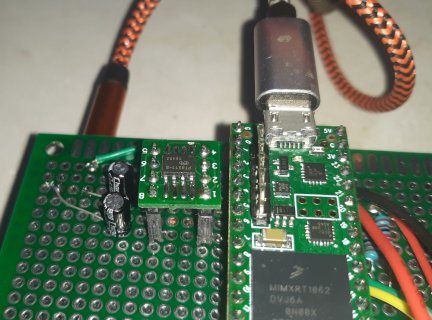

I try to integrate the circuit into a bigger PCB wich comes with some connectors etc for building a synth.
Trying to fit this into a very small case, which is why i try to avoid the audioboard as well.
While the P4 goes into the C14 capacitor at Pauls Design, the Design from the Forum does not - but you're right , this might be an good idea ;)
But this means: P4 connects to P5 on the PT... does this feel right?

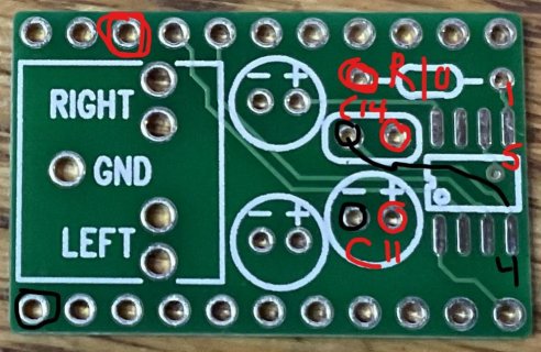

Sorry I don't have the T4 version board, I did have an older kit for t3.x in box of spare stuff...
But I will assume that is same except: what is shown in the product page:
Update: We are now including 2 circuit boards with this PT8211 kit. This new board brings the 3 signals to pins 7, 20, 21 used by Teensy 4.0. If you are using Teensy 3.2, 3.5 or 3.6, solder the parts to the original board, without text between the capacitors. If using Teensy 4.0, solder with this new board which has "T4" printed between the capacitors.
Again if you look at the Schematic with these two scribbled up photos...
Where Red is the +3.3v (and 3.3v after inline resistor ) And black is ground
As far as I can tell they match...
Wow, THANK you so much! On these images its much clearer. :cool:
I try and route it that way for now :D
If it works, i posts the files ;)

Yes, this is the modified pin configuration on the PT8211_2 AudioOutput object that I needed to use in order to stack the PT8211 shield with the SGTL5000 quad shields for hex audio. It worked great, until last night while working with a laser image.
Suddenly, for no apparent reason, there was no output from the PT8211, but the SGTL5000 outputs were fine. Closer troubleshooting this morning revealed that there is no I2S signal on T4.1 pin 2. So, I tried another 'fresh' T4.1. Same deal, even when 'repatching' the working waveforms from the SGTL5000 to either of the PT8211_2 inputs.
I remembered some Arduino updates. So, I reinstalled Teensyduino (w/o uninstalling anything/don't know how). No joy.
Does the audio library only provide an I2S signal to pin #2, if the PT8211_2 is detected? IOW, am I not getting an I2S port 2 signal because of a dead PT8211 shield or is my PT8211 shield dead because there is no I2S signal?
On the other hand, did the audio library change last night to correct the discrepancy between the PT8211_2 pin definitions and the physical PT8211 T4 kit?

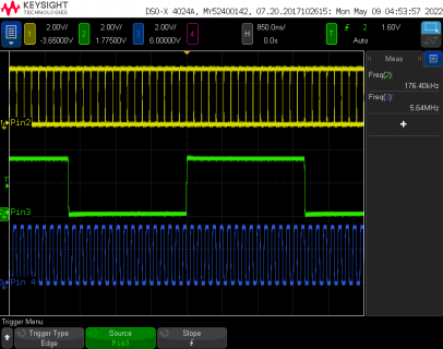

As promised, I copied the code from msg #13 into Arduino and uploaded to Teensy 4.1.
These are the waveforms my scope sees on pins 2, 3, 4.
Pin 2 definitely has a digital audio bitstream. Any chance you might have a cold solder or otherwise physically broken connection between pin 2 on Teensy and the data input on your PT8211?
Thank you, Paul for testing a Teensy 4.1 with the latest 1.57-beta1 Teensyduino.
After you had explained that the Teensy will produce those DIN, FS, & BCK signals, regardless of whether the PT8211 is connected, I mustered the courage to test the same sketch (w/o the SGTL5000 lines of code) on a new unused T4.1, without any shields to avoid damaging it. It doesn't even have header pins soldered on yet, so my scope probes were clipped directly onto the through holes. There was still no signal on pin #2 of the T4.1, but FS & BCK signals wee present on pins #3 & 4..
I'm guessing that you didn't see my update on msg #13. I had hoped to save you the effort of further testing. On the other hand, it is reassuring to know that the new beta still supports this hex audio configuration. So, thank you for that.
These tests seem to prove that my Arduino/Teensyduino installation was corrupted by those updates I had noticed, close to the time of failure. But, it also proves that simply reinstalling Teensyduino (which I had tried) doesn't correct the problem, so I'll try running the installer again as administrator.

I just tested your sketch on my laser projector and it worked fine with no modifications (except to reduce the amplitude to .8) on my Arduino installation. So the problem isn't within your sketch.
Since the DIN signal on pin #2 doesn't depend upon your PT8211 mods, that rules out hardware. I assume that you know there's no signal by testing pin #2 with a scope probe. IOW, the PT8211 can be removed from the equation. Only Arduino's IDE remains.
When I was having this problem, it would mysteriously come and go, often from one older sketch to another. Knock on wood, I haven't had any more issues since deleting the Adafruit Audio library.
TBH, I still believe that the issue is due to a wrong Audio.h. Have you not found it installed in the Library Manager? BTW, the one from Teensyduino won't be listed.
As you can see in the audio design tool, the only patch chords being used are from waveform1 and the PT8211_2_1 object. So, those lines you uncommented shouldn't be there, to begin with.
After battling this for a few days, I feel your frustration. I usually figure it out after walking away rom the keyboard for an hour to decipher the clues.:cool:
