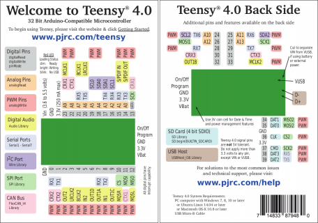

Pinouts:
As per post https://forum.pjrc.com/threads/54711-Teensy-4-0-First-Beta-Test?p=209852&viewfull=1#post209852, the pinout card should list:
  • Pin 0 can also be CS1;
  • Pin 1 can also be MISO1.
  • (pins 26 and 27 are already listed MOSI1 and SCK1 in the pinout card)

Bottom side (smt) and right side (through hole) pads:
          (bottom side view - ref note the VBAT/3V3/GND/PGM end pins are in same order as on T_3.x - [B]With ON/OFF as the far end pin[/B])
   ON/OFF - o    26 - o   o - 25
  Program - o    24 - o   o - 27
      GND - o    32 - o   o - 28
     3.3V - o    30 - o   o - 29
     VBAT - o    31 - o   o - 33

The other thread leading into this with 10 pages of posts … Teensy-4-0-(hypothetical)-pin-assignments
Paul : if you could put links to YOUR versions of the Ref Manuals it would make sure feedback/details come from the 'same page' - though of course some of your early code notes may be from prior RM version. And of course that will also be fun when it comes to 1052 .vs. 1062. Not sure if there is a placeholder post appropriate for that? Maybe post #2 with latest Software
Post #181 Pins :: first round of betas will have the pins in msg #181
I can tell you the first round of betas will have the pins in msg #181, including pins 24-33 brought to pads on the bottom side.
The pinout definitely will change, at least so we have access to the CAN FD pins on the RT1062 chip. The changes are expected to be fairly minor, between 2 to 5 pins altered. If you have any concerned or input about which pins, *NOW* is the time to read the many messages in this thread and start pouring over the info in NXP's RT1050 & RT1060 reference manuals.
