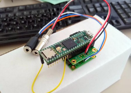

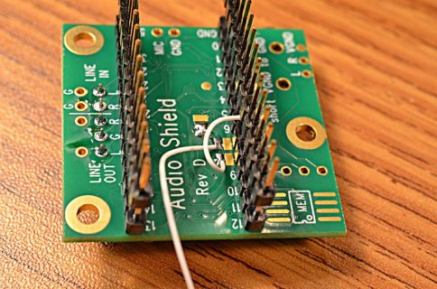

I'm still trying to get my T4.1 (beta) to do 4 channel audio using two of the RevD Teensy Audio Shields. I'm successful in getting audio output of the system, but I can't seem to get audio into the system. Has anyone successfully gotten 4 channels of audio into their T4.x using I2S?

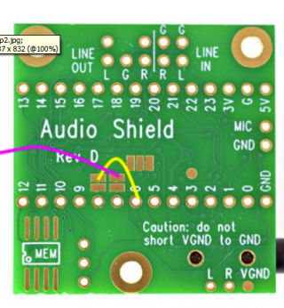

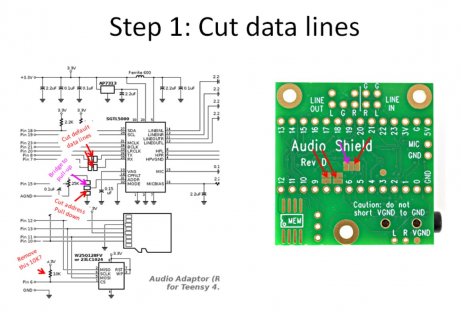

To get Quad audio working with the Teensy Audio boards, one needs to modify the second board. Similar to this post, here are the modifications that I performed:
* Cut the trace between the two pads for the audio board's RX (Pin 7)
* Cut the tracce between the two pads for the audio board's TX (Pin 8)
* Remove the 10K resistor connected to Pin 6
* Add a wire from pin 6 over to the pad that had been connected to pin 8
* Add a wire from pin 32 to the pad that had been connected to pin 7
* Cut the trace between the 3 pads that set the audio shield's address (was LOW)
* Solder-bridge the center pad to the other pad (sets the address to HIGH)
For software, I loaded up the Audio library example sketch PassThruQuad. This sketch is set to route audio that is input (line-in) into one board and send it to the output (headphone) of the other board. This seems like a good test of my setup.
So, my setup is one T4.1 (beta) plus one unmodified audio board (board #1) plus one modified board (board #2). With this setup, I am successful with injecting audio into board #1 and hearing it from board #2. So, the output of my modified board is fine. But, I am not successful with injecting audio into board #2 and hearing it from board #1. So, the input of my modified board is not working.
[By rerouting the connections, I've confirmed that the output of the unmodified board does work. The only thing that doesn't work is the input to the modified board.]
Since user error is always the best answer, I removed my modified board and inserted a different board that I modified. I got the same negative result. While user error is still a possible answer, now I am suspecting the software.
Has anyone successfully gotten quad audio input to work via I2S on their T4.1? What connections did you use? Was there a trick?

Hi Chip,
I sketched out the different connections and it seems like you have all the pin numberings OK. The mods also look OK.
Yes, I would remove the CS pull-up resistor on pin 6 of both audio boards. Not sure whether the audio data on pin 6 likes both pull-ups in parallel.
Did you perhaps put a scope on pin 6 [the input from the 2nd modified audioboard, a.k.a. the yellow wire]? Do you see an active signal there?

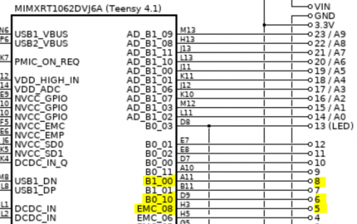

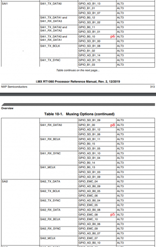

In order to find out whether pin 5 or pin 6 is the correct input pin, I checked the schematic and the immense i.MX RT1060 manual.
Teensy 4.1 schematic [pin numbers & pin names highlighted]:
and then find the corresponding pin names in the manual:
I guess now it comes to how all those pins are multiplexed for InputI2SQuad operation...that's beyond my knowledge.
Paul

According to the source code it defaults to pins 8 and 6.
#elif defined(__IMXRT1062__)
	const int pinoffset = 0; // TODO: make this configurable...
	AudioOutputI2S::config_i2s();
	I2S1_RCR3 = I2S_RCR3_RCE_2CH << pinoffset;
	switch (pinoffset) {
	  case 0:
		CORE_PIN8_CONFIG = 3;
		CORE_PIN6_CONFIG = 3;
		IOMUXC_SAI1_RX_DATA0_SELECT_INPUT = 2; // GPIO_B1_00_ALT3, pg 873
		IOMUXC_SAI1_RX_DATA1_SELECT_INPUT = 1; // GPIO_B0_10_ALT3, pg 873
	  case 1:
		CORE_PIN9_CONFIG = 3;
		IOMUXC_SAI1_RX_DATA2_SELECT_INPUT = 1; // GPIO_B0_11_ALT3, pg 874
	  case 2:
		CORE_PIN32_CONFIG = 3;
		IOMUXC_SAI1_RX_DATA3_SELECT_INPUT = 1; // GPIO_B0_12_ALT3, pg 875
IN2 corresponds to I2S2.
Thanks vjmuzik, it makes sense now.
So could you call pin 7 also IN1A, pin 6 IN1B, pin 9 IN1C and pin 32 IN1D ? [similar to the OUT1A/B/C/D names]
Is this somewhere documented besides the source code?
Paul
I believe Pin 7 is Output only, pin 8 is Input only, but 6,9, and 32 can be either or, the only mention I can remember is somewhere in the beta thread probably.
OK. I came to my assumption when I looked at the description of the AudioInputI2SOct object:
But perhaps it's a bit more complex...
Paul
Hi vjmuzik, you are right, 7 is output only, 8 is input only, 6, 9 and 32 can be either or.
Paul

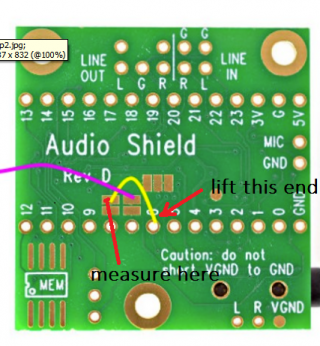

Hi Chip,
The next step I would do is connect an oscilloscope to pin 6 of the Teensy and check for digital data.
If you see data, then you know the modified audio adapter is fine and there is perhaps something with the audio library not correct.
If you see either a low or high level at pin 6, then lift/disconnect the yellow wire from pin 6 and measure on the other end of the wire [on the pad].
If you now see data on the pad then software is pulling pin 6 to a low or high level.

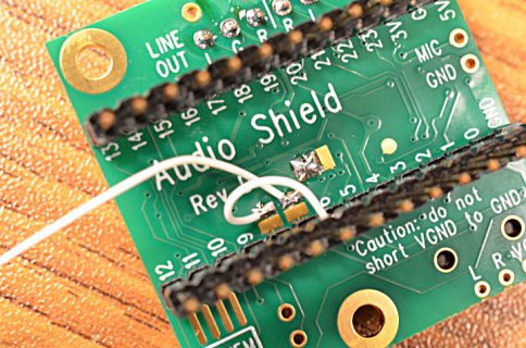

Question: what does this little white wire on pin 3V3 connect to?
Paul
The little white wire runs to the voltage regular on the 4.1 beta boards all of them are like this because of a manufacturing error some of the power and ground pads weren’t connected.

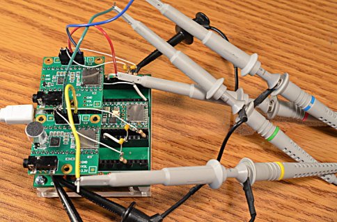

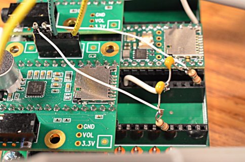

I tested this today. It seems to work fine.
To test, I used 4 PWM pins and with 10K resistors and 0.1 uF capacitors to as low-pass filters, to create 4 distinctive test waveforms. I connected those 4 waveforms to the 4 inputs on 2 audio shields. Then I ran a modified copy (to turn on the PWM) of the PassThroughQuad example.
Here's the hardware setup:
This is what my oscilloscope sees for the 4 outputs:
It seems to be working as intended. You can see the frequencies and duty cycles of each waveform matches the code below. You can also see the first 2 PWM signals appear on outputs 3 & 4, because that pass through example routes the stereo audio from one shield's inputs to the others outputs and vise versa.
This is the exact code I ran on the Teensy 4.1 for this test:
AudioInputI2SQuad        i2s_quad1;      //xy=150,69
AudioOutputI2SQuad       i2s_quad2;      //xy=365,94
AudioConnection          patchCord1(i2s_quad1, 0, i2s_quad2, 2);
AudioConnection          patchCord2(i2s_quad1, 1, i2s_quad2, 3);
AudioConnection          patchCord3(i2s_quad1, 2, i2s_quad2, 0);
AudioConnection          patchCord4(i2s_quad1, 3, i2s_quad2, 1);
AudioControlSGTL5000     sgtl5000_1;     //xy=302,184
AudioControlSGTL5000     sgtl5000_2;     //xy=302,254
  // create 4 test waveforms and distinct frequencies
  analogWriteFrequency(28, 440);
  analogWriteFrequency(33, 530);
  analogWriteFrequency(36, 610);
  analogWriteFrequency(37, 610);
  analogWrite(28, 128);
  analogWrite(33, 128);
  analogWrite(36, 64);
  analogWrite(37, 190);
  AudioMemory(12);
  // Enable the first audio shield, select input, and enable output
  sgtl5000_1.setAddress(LOW);
  sgtl5000_1.enable();
  sgtl5000_1.volume(0.5);
  // Enable the second audio shield, select input, and enable output
  sgtl5000_2.setAddress(HIGH);
  sgtl5000_2.enable();
  sgtl5000_2.inputSelect(AUDIO_INPUT_LINEIN);
  sgtl5000_2.volume(0.5);
Here's a closer look at the PWM output to audio shield input connection.
The whole thing is mounted on a test board that just routes all 48 pins of the Teensy 4.1 to 3 sockets. I plugged the 2 audio shields into the 2 sockets. The first shield is just a regular rev D shield with no modifications.
The 2nd shield has its I2C address jumper changed, and the 2 data pins are cut and routed to pin 6 and 32. Here's come close up photos so you can see exactly what I tested.
