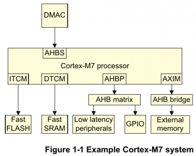

But consider the compiler's point of view. This hardware has 2 different groups of registers which can access the same physical pins. Another set of registers configures each pin, to assign it either the slow GPIO1-4 or to the fast GPIO6-9. The compiler doesn't "know" which pins are assigned to the slow vs fast GPIO. They can be reassigned while the processor is running, so even a very advanced static code analysis (which the compiler does not do) could not reliably determine which registers are proper. Since each pin is dynamically assignable, you can configure the hardware for a scenario where some pins in the GPIO1 group are accessed with GPIO6 and others are accessed by GPIO1. Semantically, accessing either or both sets of GPIO is perfectly legal. That's why you don't get a compile error.
Using slow GPIO might seem silly when fast GPIO is available. Indeed that is why we default all the pins to using the fast GPIO on Teensy 4.0 & 4.1.
But DMA can not access GPIO6-9. FlexIO3 is also inaccessible to DMA, because like the fast GPIO, it's on a different bus which doesn't have DMA access. Fortunately for GPIO, if you need to use DMA to control a pin, you can dynamically change the assignment for that pin back to the slow GPIO. The OctoWS2811 library does this, where timers connected to the crossbar trigger cause DMA which writes to the GPIO1-4 registers to synthesize waveforms. The point is we do actually use the dynamic assignment of pins between GPIO1-4 and GPIO6-9 in special scenarios like this. Those slow-but-DMA-accessible GPIO1-4 registers need to be syntactically valid for this sort of code to work.
Why NXP designed the chip this way involves some guesswork, since they don't usually document how things are designed internally. We do know the earlier 1052 chip which we used for beta testing in the first half of 2019 had only the slow GPIO. I'm imagining NXP heard complaints from large customers (like General Motors size "large") about how slow the GPIO was. NXP probably didn't intend for it to be so slow. Probably nobody really put much thought into the GPIO speed. They get the Cortex-M7 core from ARM, and for reasons unknown configured the AXI bus to run at 1/4 the CPU clock speed. Then there's at least 1, maybe 2 bus bridges between AXI bus and the GPIO peripheral (very likely AXI to AHB to APB... but again, much guesswork here). All this stuff is designed with standard buses have handshakes that add wait states if needed. My guess is engineers just put stuff on buses and compiled the verilog or whatever HDL they use.
In the 1062 chip, NXP added GPIO6-9. The (almost certainly) connected it to the M7's AHBP bus.
This diagram is from ARM's documentation (google for DDI0489B). Inside the 1062, we know that almost everything is connected to the AXI bus. By default we divvy up the RAM1 bank (512K) into ITCM and most variables into DTCM so code runs as fast as possible. The RAM2 bank and almost all peripherals are accessed over AXI, which is slower. As far as I know, GPIO6-9 and FlexIO3 are the only things connected to the fast AHBP bus.
The AHBS bus is only for DMA to be able to access variables and code in ITCM and DTCM. Why ARM didn't also give it the ability to access peripherals over AHBP is a mystery to me. But that's the way they designed Cortex-M7.
How NXP designed the GPIO connections is also a matter of guesswork. But we do know they were added between 1052 and 1062. 1052 had only the slow GPIO. From the timing of those 2 chip releases, it's probably reasonable to assume they didn't do any major new design in such a short time frame. My guess is they created 2-input instances of the pin muxes as a quick solution to avoid much change elsewhere in the already-proven 1052 design. It probably would have made more sense to just expand the number of inputs on the normal pin muxes and assign GPIO1 to the normal ALT5 channel and put GPIO6 on another channel of that normal pin mux. But that's not what they did. Instead we get both GPIO1 or GPIO6 selected by the ALT5 pin mux, and they there's a 2nd not-as-well-documented mux which physically connects the actual pin to either GPIO1 or GPIO6.
When GPIO1 doesn't have access to the pin (which is the way Teensyduino's startup code configures the hardware), the result of accessing GPIO1 is the same as if the pin mux assigned the pin to one of the other peripherals. You can still use GPIO1 or GPIO6 to try to access the pin, but reading always gives 0 and writing has no effect, because the pin mux is routing the actual pin to something else like a serial port, I2C, SPI, etc.
So that's why you can still access GPIO1-4 with "success". Well, at least with the caveat of quite a lot of guesswork about how NXP designed the chip.

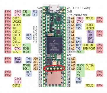

Hello.
Because I needed to minimize bit manipulation for fast operation, pins I have selected as ADC inputs are from GPIO6 and GPIO7 groups. I'm using 2x14bit ADC now (so 28pins used).
Unfortunately now I need to use SPI interface also, and pins for SPI and SPI1 shown in teensy 4.1 pinout card have been already used as ADC inputs.
Am I now left with Software SPI, or can I still assign any pins for hardware SPI?

Are you using either the micro-SD card or the psram/flash memory pads underneath the Teensy 4.1?
If you aren't using the micro-SD card, you could use something like this to bring out the SD pins:
And the two sets of solder pads underneath the Teensy use FlexSPI. I don't know if that would work for your purposes.

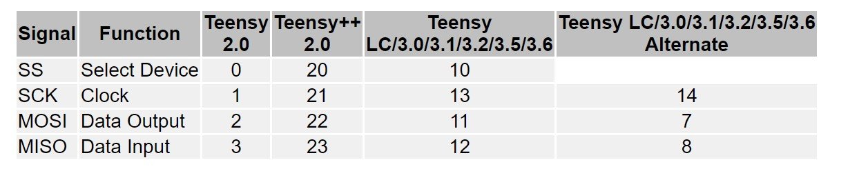

I think SD card in teensy 4.1 is not SPI driven. Could you explain your ideas a little bit more?
There is this table, but there is no reference to teensy 4.0 and 4.1 here.

Sure, in the Teensy 4.0 the micro SD pins are listed as:
  • Pad 34 (MISO2)
  • Pad 35 (MOSI2)
  • Ground
  • Pad 36 (CS2)
  • 3.3 volt
  • Pad 37 (SCK2)
  • Pad 38
  • Pad 39
In Teensy 4.1, the micro SD card pins got renamed to 42-47, but the layout should be the same, since in both cases it is what micro SD card readers use.

In other words: what pins can be assigned to:
SPI.setMOSI(pin)
SPI.setMISO(pin)
SPI.setSCK(pin)
The Teensy 4.1 does NOT have alternate pins for the SPI buses, except for using SPI1.SetMISO(1) instead of using pin 39.

As far as I know, the only alternates are pin 0 or pin 38 being the preferred CS1 pin, and pin 1 or pin 39 being the MISO1 pin. So, the answer is no, with the outer row pins you've used, there is no hardware SPI.
Those pins are the same as the T4 pins that are on the outside of board... And almost identical to the pins on T3.6/T3.5 at those exact positions.
That is On/Off, Program, GND 3.3V and VBat... The difference to T3.6/3.5 is the ON/OFF pad replaced the Reset pad.
As mentioned there are very few alternate SPI pins. As also probably mentioned there are more than one SPI...

It looks like I can use GPIO6 for parallel output. I noticed that one of the pins, 1.5, is grounded. What happens if I turn on this bit?
Since the Teensy is marketed as being an Arduino-type device, I was hoping to find some less overwhelming documentation for doing common tasks.
