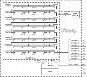

Under the hood, the FlexIO is a collection of shifters and timers. In the Teensy 4 version, they have 8 shifters and 8 timers. The numbers are actually reported in the PARAM register (page 2914). One caviat here: the docs only describe 4 shifters in the registers section (and only 4 shifters are exposed as defines in the Teensy core header files), while the textual description correctly talks about 8 shifters. You will need to add a couple extra #defines if you want to access the shifters 4-7. As usual, all the configuration is done through a number of memory mapped registers. The table with the list of them is on page 2912.
The shifters are 32 bit registers, that can, well, shift the data. When shifting the data, the input appears on the top bits, and everything already in the shifter shifts right, and the lowest bits are output by the shifter (nice diagram on page 2885). So if you configure the shifter to the receive mode it will shift in the incoming data to the top bits. If you set it up to the transmit mode, it will spit out the low bits. The cool feature here is the data can be sourced or spit out to either the output pins, but also to a neighboring shifter. This allows to create a chain of shifters, one outputting to the next, and only the last one actually driving the pins.
Why would you do something like that? For buffering. This way you can buffer the incoming/outgoing data and the CPU only has to take care of it every now and then, instead of every time new piece of data appears (as it was the case with the DMA) - so exactly what we wanted. You might however wonder what happens with the data between the point in time when the shifters are already full, but before the CPU picks the data up (or between the point when all the previously data is shifted out and new data is provided by the CPU). There's actually one more, crucial element there: shifter buffer. Every now and then (it's for you to decide!) the data is moved from the shifter to the shifter buffer (in case of receiving the data; or from the shifter buffer to the shifter in case of transmitting) and the CPU gets notified (in a form of interrupt request, DMA request, or you can also manually check the status bit in a register). The new data can be fetched from the shifter buffer, while the shifters continue their job and receive more data. After the data is read from the shifter buffer, the notification is automatically cleared and the shifters can put the new data there when it's ready.
In short:
- data comes from the external pins into the shifter
- every some number of shifts it gets transferred to the shifter buffer and the CPU gets notified
- the CPU reads the data from the shifter buffer
The shifter buffers are available as SHIFTBUFa registers. They are continuous memory, which is useful when filling them, and they also come in a bunch of versions with swapped individual bits, nibbles, bytes. Pages 2929+ describe all the variations.
All of the shifters can shift in/out one bit at a time from/to the external pins. This doesn't really mean that you can only implement serial protocols - anything parallel just needs the data to be transposed first and transmitted through some number of pins at the same time. And additionally shifters 0 and 4 can shift the data OUT to multiple pins at a time, and shifters 3 and 7 can shift data IN from multiple pins at a time. For example, if the shifter is set out for parallel output of 4 bits, instead of shifting by 1 bit, it's shifted by 4, and the lowest 4 bits are put on the output pins. As usual, there are caveats - the pins used for parallel input/output must be continuous - so if you want 8 bit parallel output, you need 8 consecutive FlexIO pins. To save you trouble of looking it up: out of the three FlexIO modules, only the third one (FlexIO3) has more than 4 consecutive pins exposed in Teensy (it actually has 20 - FlexIO3:0 - FlexIO3:19). The problem is that FlexIO3 is nerfed, and cannot generate DMA requests, that makes it more a pain in a butt to use (because you either have to busy wait, polling the status and filling/reading from the shifter buffers as necessary or you have to use interrupts for that, but at any decent data rates, you're pretty much just sit in the interrupt handler - so you might just as well to the busy polling). FlexIO2 has 2 strides of 4 consecutive pins (0-3, 16-19). FlexIO1 has stride od 4 consecutive pins (4-8) but they are just as good as 4, because FlexIO can only do parallel outputs in power-of-two counts. Important thing to note is that even though only certain shifters support parallel transfer to/from the pins, ALL of them support parallel transfer from/to neighboring shifters. So you can set up shifter 0 to shift the data out 4 bits at a time to the pins, shifter 1 to shift 4 bits at a time to shifter 0, shifter 2 to shifter 1 and so, creating a long chain of shifters, effectively getting an output queue 8 x 32 bits = 32 bytes in length. The number of bits shifted by each shifter is controlled by PWIDTH field in the shifter configuration register SHIFTCFGa, page 2927.
There are two more pieces to the puzzle: when to shift and when to transfer from the shifter to the shifter buffer (or from the shifter buffer to the shifter, when transmitting out). Both of these tasks are controlled by the internal timers. There are 8 timers, and each shifter can pick which timer they use. Each timer has a corresponding counter and an output. The counter is decremented based on some signal - either the FlexIO clock, pin input or by an external trigger. When the counter is zero and it decrements again, the timer output is toggled. And the shifter clock can be either that timer output, or alternatively the pin or external trigger input (TIMDEC setting in TIMCFGa register, page 2934). Each shifter can pick to shift on positive or negative edge of that shifter clock signal (TIMPOL setting in the shifter control register SHIFTCTLa on page 2925).
To make it a bit more convoluted, there are three different modes for decrementing the timer's counter, and they, together with the decrement logic define when the data is moved between the shifter and its corresponding shifter buffer. In the simplest, 16-bit mode, whenever the counter is at zero and decrements, the timer toggles the output and the data is moved from shifter to buffer (or vice versa). In the 8-bit mode, the counter is divided into two 8 bit parts. Whenever the lower half gets to zero and decrements, the timer output toggles, the higher half decrements and the lower half is reloaded. When the higher half gets to zero, the data is transferred between the shifter and the buffer. The third mode is the PWM mode, where again, the counter is divided into two 8-bit parts. The lower eight bits control decrement when the timer output is high, and when the value gets to zero, the timer output toggles to low and the high 8 bits start decrementing. When they reach zero, the output toggles again and the data is copied between the shifter and the buffer. Technically the timer output is available as an output from the FlexIO module (section 50.2.6.1 on page 2895) but it doesn't seem it's available as an input to any of the XBARs, so I'm not sure how useful this is. The timer output can be however routed back to FlexIO, as a *trigger* for another timer.
And to make it more flexible/confusing, timers also get yet *another* independent input - a trigger. A trigger can be used as the clocking signal for the timer, but more interestingly to enable or disable given timer. The TIMCTLa register (page 2932) lets us to pick an internal trigger or an external one (TRGSRC field). The internal ones are pin inputs, shifter status flags (indicating if the data has been loaded from/to the shifter from the corresponding buffer) or other timer outputs. External triggers can be hooked up through the XBAR. Selecting the trigger is done with TRGSEL field, and the logic is funky to say the least - see page 2933. For the external trigger you simply select the index (corresponding to the FLEXIOa_TRIGGER_INb outputs from the XBAR - see page 72). Then, the timer configuration register TIMCFGa allows us to set when to enable or disable the given timer with TIMDIS and TIMENA fields (page 2936). This allows to implement really useful functionality, where the entire send/receive process is only performed when some signal is high or low (something like ENABLE/DATA_VALID/whatever).
The above describes only the most basic functionality of the shifters - the transmit and receive mode. They can also run in other modes - for instance you can define a small state machine, flipping between different shifters based on the inputs, but for now, we can ignore that - if you need, all the derails are described on pages 2886 and on. Then there's also some extra functionality for inserting extra start and stop bits, resetting the timers on different occasions and some other more exotic stuff. The pretty unusual bit (in a good sense, this doesn't really happen too often in this documentation...) is the 50.4 section starting on page 2896 - that goes over the configuration for a number of popular protocols, including UART, SPI, I2C and some others. It's a good start when you want to look for some examples.
