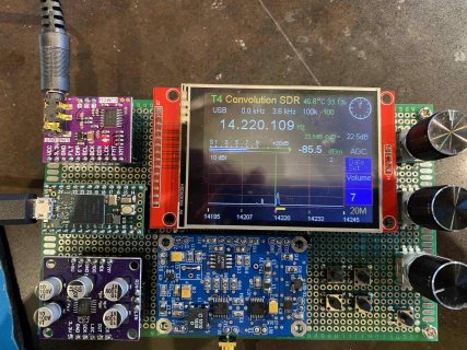

Frank,
I want to thank you for the convolution SDR project. It challenged my hardware and software skills and I just got it working today. We use SDR technology at my company using fast multi-core processors and I wanted to see what could be done with the new M4 processors like the Teensy 4.0. I got the code to compile fine albeit with a handful of warnings. All the modes I have checked so far work great. Have you thought about using one of the UHF tuners like the RT820T which have a single ended IF
73's
Hi Jim, your SDR setup looks quite familiar to me ;-). Great that it works and that you find it useful. BTW, the current version does not make full use of the T4 power, it already works great with the T3.6 @ 180MHz ;-). [OK, using synchronous AM demodulation at 256kHz sample rate is only possible with the T4 :)]
Which frontend do you use? Is it Joris PCB? If yes, where did you get it? I would be very interested in information on that.
I have not thought about using UHF tuner chips, but maybe you can advance on that? I have no experience in UHF and the tuners used in those cheap SDR USB dongles.
All the best 73s,
Frank DD4WH

Frank,
The frontend is the one from Joris that Rob Engberts (PA0RWE) sells. With the large 0805 parts it was pretty simple to build and worked first time.
I started a project to use the Rafael R820T tuner chip (the same as in many SDR dongles and the Airspy mini) as a UHF front end but did not finish it. Eric Brombaugh published a nice breakout board for the R820T that you can get on Oshpark.
http://ebrombaugh.studionebula.com/radio/r820t2_breakout/index.html
I intended to add a 5351 local oscillator like the Airspy uses and combine it with the NXP IMXRT MCU (like on Teensy 4.0) to build a multi-channel 900 MHz demodulator. With the proper filter settings it possibly could be used with your design but since its a single IF output you would have to sample at 2x or 4x to yield I/Q data in software. The on board ADC on the IMXRT appears to be fast enough to do this.
