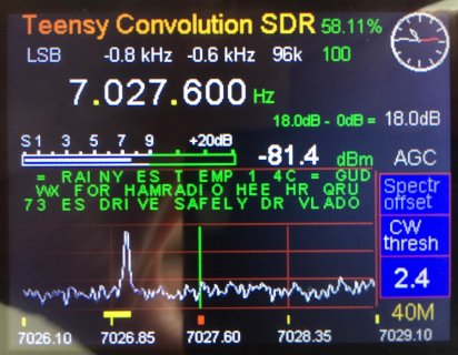

Thanks again for pointing me to the bugs! Now the software compiles for Teensy 3.6 (latest version is on github).
I have also tested the fixed version on my T3.6-based SDR and it plays fine.
For Teensy 3.6, compile with uncommented
and choose Teensy 3.6 180MHz in the Arduino compile optionsCode:#define HARDWARE_DD4WH
For Teensy 4.0, compile with uncommented
and choose Teensy 4.0 in the Arduino compile options.Code:#define HARDWARE_DD4WH_T4
For Teensy 4.0, you will find a menu entry where you can choose the CPU frequency you want. Beware to have a good heatsink installed when going over 600MHz.
I have been able to run the T4 Convolution SDR at 948MHz for hours. Every CPU frequency above 948MHz causes the radio to crash (although not necessarily immediately . . .). But 948MHz is really fast enough for everything you would dream for in this radio.
Have fun with the Teensy Convolution SDR,
Frank DD4WH
