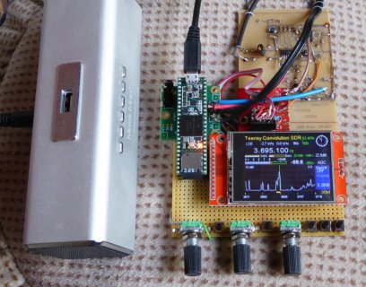

Good news:
Now the next step (living display, control of the SI5351) is done!
Thank you very much, Frank, for your hints. (Inside the 10300 lines I wasn't able to find the comment after line 1734.)
Now it's time to mount and solder the 5 remaining buttons, and the I / Q input. (Before I do so, I will test my QSD with a PC program, HDSDR.)
Thanks a lot, also for the literature notes!
73, Wolfgang
More good news:
Now the receiver is running. In the moment I cannot hear anything, but the spectrum seems to be correct, and the right audio output connection I hope to find soon.
Very glad about this nice receiver!
Because of using a touch screen my next goal is to make it work.
Now my receiver works, very well!
Connected to my 80m dipole, I can hear ham radio stations in good audio quality, better as with my IC706.
A mistake from me: false LSB/USB assignment .Changed I / Q connectors -> all ok.
The lack of attenuator and LPF was no problem until now.
Thank you, Frank, for the new informations (Wiki "Menu")!
Wolfgang
