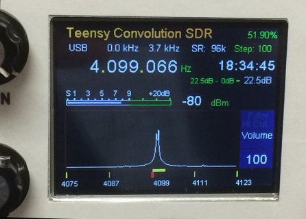

Hey, happiness is having things work! I finished the SDR control box to the point of being able to plug a soft-rock into the back and running Frank's Convolution SDR. It works, and I am receiving stations!
I will post more on the control box in a bit, probably on a separate thread. This is about the DD4WH radio.
Frank, thanks for the effort in getting this project going. It is a really interesting implementation and demonstrates the capability of the Teensy for some heavy duty DSP.
I have a question about levels. At this time am using headphones on the Audio Adaptor. The audio levels are too low. I measured the output of the SoftRock as 30 mV p-p (11 mV rms) on each of the I and Q outputs with -60 dBm input (0.22 mV rms). This was at a 4.1 MHz. This is a voltage gain of about 50. When I turn the Volume to 100, I see about 220 mV p-p at the 8-Ohm headphone. This is adequate, but for lower input signal levels it is challenging. A screen:
Is there a variable or another menu setting for software gain towards the audio output point?
Needless to say, I generally have lots of menus to explore! As an experimental SDR platform, this is great!
Also, for others, here are a couple of hints on getting started the first time. In the setup(), search for "EEPROM_LOAD();" and until an EEPROM save has been done through the menus, this needs to be commented out. Also, you need to have an SD card in the Teensy, even if you are not using the feature.
Bob W7PUA
That screen is with the input at -80 dBm (not -60). Interestingly, it shows exactly -80!! The audio level on the headphone outputs was down around 20 mV p-p.
Hi Bob,
that looks/sounds great! Congratulations!
I am a bit puzzled about the gain, I will try to list my gain distribution here:
antenna -> optional attenuator (0 to -31dB) -> bandpass filters (-3dB) -> QSD & opamps (+36dB) -> Teensy audio board (up to 22.5dB of codec analog gain) --> codec ADC -> software processing -> Teensy audio board codec DAC -> Teensy audio board headphone amp
So, there is not much analog gain involved (36dB + 22.5dB + xdB headphone amp). I am not sure how much gain a Softrock has? But I remember having read reports about low gains in Softrock SDRs, maybe changing gain in the opamps after the QSD helps!? However, if I did the math correctly, voltage gain of 50 is 17dB compared to 36dB? But I am not sure whether my gain figure is voltage gain or power gain . . . (I have to learn a little more)
As you can see on the screen, the analog gain in the codec is displayed (in your picture: 22.5dB - 0db; the latter (0dB) is the attenuation by the optional digital step attenuator). So your machine seems to have the analog gain set to 22.5dB (in the software this gain is automatically controlled by some kind of improvized analog gain AGC I set up, but it can also be manually controlled by the setting "RF gain" in Menu2 !). "Volume" in Menu2 controls the digital gain of the codec before the final headphone amp. I do not remember exactly, but you should be able to control for more digital gain easily by applying a multiplication factor in the software.
voltage to dB: 20log(U) so it should be 34 dB,
power to dB: 10log(P).
Thanks Walter!
so, gains should be comparable, which makes it even more puzzling, why the output is so low.
BTW: Bob, are you using the Teensy audio board or another codec?
All the best,
Frank
Thanks Frank. I am using the stock Teensy Audio Adaptor, with Line Inputs.
The input level needs to be enough to cover the ADC noise. When I listen with no antenna connected to the SoftRock, I hear noise, but it is weak---not enough to listen to a station at that level. The S-meter shows -112 dBm. When I remove the inputs to the Codec, the S-meter shows -129 dBm and I cannot hear the noise in the headphones. When I tune in a AM broadcast station about 20 km away, using a reasonable antenna it shows -72 dBm and is fine for listening in the headphones with the Volume at 90.
So, I conclude that things are working as planned, but I need to add a gain variable just before converting from floating point to fixed. I will try that and report back.
Frank, I bet you have some voltage gain in the audio amplifier driving your speaker?
Thanks, Bob
I added a software gain factor to your existing scaling

          CONVERT TO INTEGER AND PLAY AUDIO
with #define PUA_AUDIO_GAIN 4
showing reasonable results. That may not be the best value, but it can be played with. Once setup, it probably doesn't need to be changed, so the #define is simple and adequate. Onward... Bob
Hi Bob,
nice and simple workaround which does not affect processor load! (because the scaling is done anyway to account for the decimation/interpolation factor)
Concerning the audio amp:
- yes, I use a cheap PAM8403 module from ebay for the stereo speakers
- however, for the headphone output I use the original output jack of the Teensy audio board to plug in my headphones, so this does not introduce extra gain
Headphones could also be very different, I use standard headphones with 32ohms, but sometimes use studio headphones with 80ohms, that makes a large difference in perceived volume.
73 Frank
I have modified the HardRock to use the Si5351 (Adafruit board) and to have a broadband transformer input. Using x1, x3 and x5 LO multiples, I have received from 10's of kHz to 144 MHz with this. But, this happened because I had a SoftRock sitting here. Unless you just want to play with boards and solder, it is easier to just to go the Elektor route.
Frank, I looked at my headphones, and all they say on them is "Radio Shack." Nothing about models or impedance is on them. So just for fun and education, I measured their impedance:
They would seem to be what they call 40-Ohm headphones (the simple model is 35 Ohms resistive in series with 95 uH). I have no idea how efficient they are. Doesn't make any difference, anyway, as we have enough drive now.
The impedance was measured using my Audio Vector Network Analyzer which is T3.6 based. It is out for publication in QEX now, and will generally be made available as soon as they get it printed.
Bob
I am pursuing the RF filtering to make my Convolution SDR work better. I looked at various options that would (greatly) reduce the x3 RF mixing from signals above the pass band. The candidate that looked good was a 5-pole elliptic using 2 inductors and5 capacitors. Frank, is that the sort of thing you are using? I would also add something in the way of a high pass filter that would remove the AM broadcast band, for frequencies where this could be a problem. I was contemplating doing a OSH Park board that might have one or two of these filters, along with a bypass relay. Is there such a PCB around, already?
A related question. Frank, would going to a serial control of some sort for the filters have appeal? Elecraft amongst probably others uses some simple 2-wire serial bus, along with minimal PICs to control boards like the filters. Following the Elecraft lead, the board might have 2 filters with latching relays and a 12F series 8-pin PIC to latch the relays. When the relays are set, the PIC goes to sleep and the whole board draws microamps and produces no interference. But, it is a change from the parallel lines you are using. Each board could have a different address either using I2C or something in that spirit, and there would be no practical limit to the number of filters.
Or maybe there is a better way??
73, Bob W7PUA
