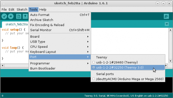

OK, nice to know. Anyway I've made all my changes over the upstream Arduino IDE code without reusing your code yet. Well, except for copying hardware/teensy over and tweaking the upload commands. Once my changes work correctly (I hate Java) I'll go over your IDE modifications and cherry-pick those that apply.
This is what it looks like for now:

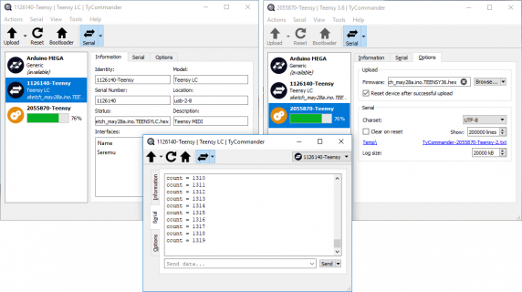

Meanwhile, I've updated TyQt to version 0.5.5 with support for single-instance (à la Teensy Loader) and minimal interface mode.
This is a great tool for managing multiple Teensy devices; nice work! It correctly sees my T2.0, T3.0 and T3.1 devices and can reset them, but it labels my (beta) Teensy LC just as "Teensy" with a serial number (444430). For options just (none), that is no upload, no reset. Is that because my LC is a beta device?

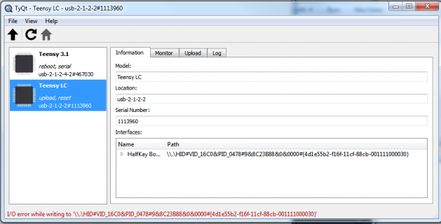

I pulled the exe's and I got this error with reset - on the recognized LC:

I would have been surprised if it worked at first, the assumption that the bootloader protocol is the same as in 3.1 and 3.0 may be wrong then. Maybe Windows rejects the HID report because it's the wrong size. A quick look into the reference manual for the mkl26z64 tells me the sector size is still 1MB, I guess the bootloader does nothing weird here.
Just like last time, here is a small DLL to help me find out the truth about it :) Try to reset the Teensy LC and send me everything that appears in the log tab.

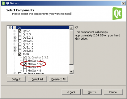

I think the easiest way to configure Qt Creator with the correct compiler is to use the one they provide. Remove mingw-w64, reinstall Qt using the Qt installer and on the components page, enable Tools > MinGW 4.9.1 (unchecked by default).

First line from 3.1 then were about 25 lines of the same following:
report length: 1089
I/O error while writing to '\\.\HID#VID_16C0&PID_0478#9&8C23B88&0&0000#{4d1e55b2-f16f-11cf-88cb-001111000030}'
Components? > Tools / Options
I should go to my other machine - that is the one I did the cleaner install on - I never fixed this one it seems.
Okay, so the output report length is correct. Something else is going on but I don't have time to investigate now. Unless Paul can tell me what changed exactly (if anything did at all, it could also be a bug lurking in my code), I'll wait for my own Teensy LC (within 1 to 3 weeks, I live in France) to fix this.
That 'report length: 1089' was from the Teensy3.1 I hit first!
The other text 'I/O error...' is unchanged from what was on the earlier screen shot
Thnx for the Qt screen shot. I will repair.

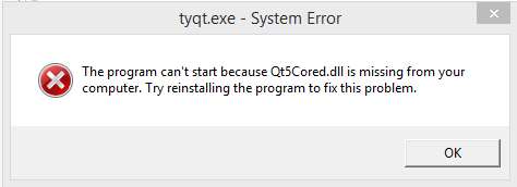

Interesting, thanks for the report. I had a virtual machine running 8.1 but there were lots of problems (with Windows Update, I think), so I dropped it with the intention of doing a clean install later (which I never did). I'll have to reinstall it tomorrow to run some tests on it.
Yes, this is the Qt problem. If you launch it from the IDE, it should be OK because Qt Creator puts the directory with these DLLs in PATH variable. Otherwise you should copy them to the build directory from C:\Qt\5.4\mingw491_32\lib: you need icudt53.dll, icuin53.dll, icuuc53.dll, libgcc_s_dw2-1.dll, libstdc++-6.dll, libwinpthread-1.dll, Qt5Cored.dll, Qt5Guid.dll, Qt5Networkd.dll, Qt5Widgetsd.dll (take the ones without the d suffix if you build in release mode).
