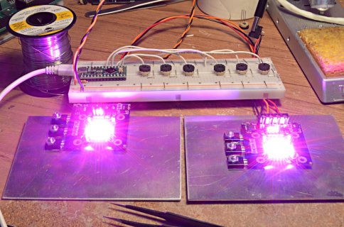

Yes, 3.1 has far more, but LC is pretty useful. Here's a couple serial-controlled 10 watt RGB LEDs, where I needed a quick way to send data at a particular baud rate.
I guess even a regular 8 bit Arduino could do this, well, at least one with an unused serial port. Still, the LC is pretty handy for such things. ;)
