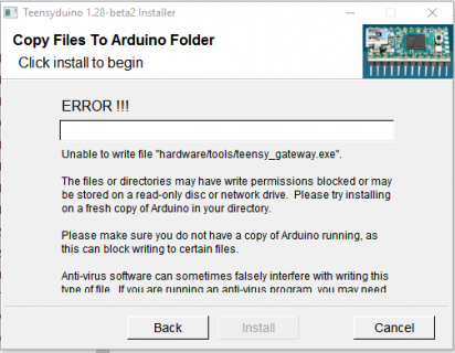

I found I had two copies of this active in Taskmanager! Install completed after I STOPPED <edit:not started> them.
What's the gateway do ?
