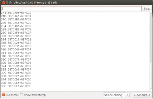

I haven't tested this with 1.43 yet, but it appears that teensy 3.2 hardware with the teensyduino 1.42 and arduino 1.8.5 has a USB buffering issue.

Feed this with serial data from:
#!/usr/bin/perl
use warnings;
use strict;
for(my $x = 0 ; $x < 8*1024*1024 ; $x+=1)
        print pack("V", $x);
After a few megabytes it gets an failure when the previous 64 bytes are replayed:

With 1.6.8 and an ancient teensyduino this error never occurs. What's interesting is only that 64 byte block is in error; the stream re-synchronizes afterwards.
Just to confirm, I run this and did manage to reproduce the error. Will investigate soon...
The regression definitely started with version 1.36.
1.36 didn't change anything significant in the USB serial code, but we did jump from gcc 4.8 to 5.4.
The other thing I've discovered is the bug only happens (using 1.43-beta2) with -O2 optimization, which is "Faster" in Tools > Optimize. With -O1, -O3, -Os or -Og, the bug doesn't happen.
I've tracked it down to usb_dev.c. Putting a pragma at the top to force that file compiled with different optimization "solves" the problem. But I've put hours into trying to compile individual functions with different optimize attributes, with very little success learning which function is responsible. When almost any of the functions use -O2, the bug happens.
I'm not ready to conclude this is a bona-fide compiler bug. It may be some very subtle bug in the code which just hasn't mattered.
At this point, I'm still undecided on what best thing to do for a 1.43 release. Maybe just put a pragma in the file? Or maybe change the default optimization to -O3, just in case this really is a subtle compiler bug with -O2?
I briefly confirmed it happens on 3.6, but otherwise I've done all my testing on 3.2.
