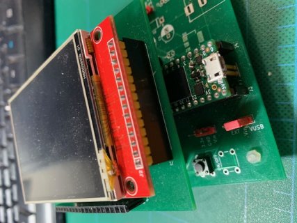

@KurtE - thanks - 1st pic with new phone![]()
Running sketch with no heatsink on one of my breakout boards. Just ran it at 816 and getting pretty much the same temp as you about 58 degC.
[ATTACH]17848._xfImport[/ATTACH]
T:\tCode\T4\T4-TEMPMON_buddabrot\T4-TEMPMON_buddabrot.ino Oct 8 2019 11:04:49
>>> Reason for 'reset': 1 IPP_RESET_B :: done Reason
F_CPU==960000000 F_BUS==240000000 FreeMem(); 4293328836
begin ...
in setup @L#72 stack var addr: 0x2006FFE4
TEMPMON driver example.
F_CPU=960000000 deg C=45
The chip initial temperature is 45.36 @ms= 2731
44.73 @ms= 3171
