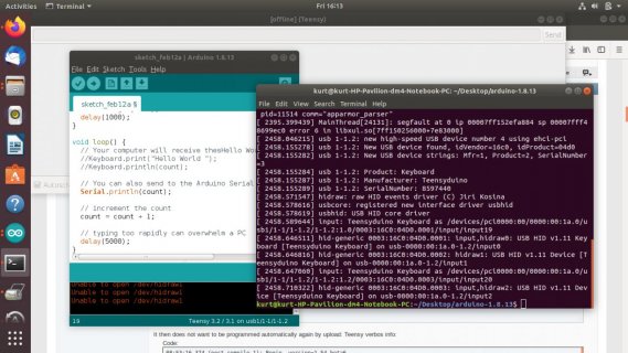

This 'padding' is interesting note about the 32KB blocking for ITCM : .text.itcm.padding 8548 24220
[ 58.300446] usb 1-1: new high-speed USB device number 2 using ehci-pci
[COLOR=#ff0000][ 58.659302] usb 1-1: config 1 has an invalid interface number: 3 but max is 2[/COLOR]
[COLOR=#ff0000][ 58.659305] usb 1-1: config 1 has no interface number 0[/COLOR]
[ 58.673878] usb 1-1: New USB device found, idVendor=16c0, idProduct=0476
[ 58.673881] usb 1-1: New USB device strings: Mfr=1, Product=2, SerialNumber=3
[ 58.673883] usb 1-1: Product: Teensy MTP Disk/Serial
[ 58.673884] usb 1-1: Manufacturer: Teensyduino
[ 58.673885] usb 1-1: SerialNumber: 7820070
[ 58.690544] cdc_acm 1-1:1.1: ttyACM0: USB ACM device
[ 58.693345] usbcore: registered new interface driver cdc_acm
[ 58.693346] cdc_acm: USB Abstract Control Model driver for USB modems and ISDN adapters
[COLOR=#000000][ 98.089536] usb 1-1: USB disconnect, device number 2[/COLOR]
[ 98.130423] cdc_acm 1-1:1.1: failed to set dtr/rts
int count = 0;
while (!Serial && millis() < 5000) ;
// Your computer will receive thesHello World 0e characters from a USB keyboard.
//Keyboard.print("Hello World ");
//Keyboard.println(count);
// You can also send to the Arduino Serial Monitor
Serial.println(count);
// increment the count
count = count + 1;
// typing too rapidly can overwhelm a PC
delay(5000);
08:53:16.374 (post_compile 1): Begin, version=1.54-beta6
08:53:16.660 (loader): Teensy Loader 1.54-beta6, begin program
08:53:16.688 (loader): File "Simple.pde.hex". 18768 bytes, 0% used
08:53:16.689 (loader): Listening for remote control on port 3149
08:53:16.689 (loader): initialized, showing main window
08:53:16.775 (loader): remote connection 9 opened
08:53:16.775 (post_compile 1): Sending command: comment: Teensyduino 1.54-beta6 - LINUX64 (teensy_post_compile)
08:53:16.775 (loader): remote cmd from 9: "comment: Teensyduino 1.54-beta6 - LINUX64 (teensy_post_compile)"
08:53:16.775 (loader): remote cmd from 9: "status"
08:53:16.835 (post_compile 1): Status: 1, 0, 0, 0, 0, 0, /tmp/arduino_build_803802/, Simple.pde.hex
08:53:16.835 (post_compile 1): Sending command: auto:on
08:53:16.835 (loader): remote cmd from 9: "auto:on"
08:53:16.835 (post_compile 1): Disconnect
08:53:16.846 (loader): remote connection 9 closed
08:53:16.852 (post_compile 2): Begin, version=1.54-beta6
08:53:16.852 (loader): remote connection 9 opened
08:53:16.852 (post_compile 2): Sending command: comment: Teensyduino 1.54-beta6 - LINUX64 (teensy_post_compile)
08:53:16.852 (loader): remote cmd from 9: "comment: Teensyduino 1.54-beta6 - LINUX64 (teensy_post_compile)"
08:53:16.853 (loader): remote cmd from 9: "status"
08:53:16.916 (post_compile 2): Status: 1, 1, 0, 0, 0, 0, /tmp/arduino_build_803802/, Simple.pde.hex
08:53:16.916 (post_compile 2): Disconnect
08:53:16.926 (post_compile 3): Running teensy_reboot: /home/kurt/Desktop/arduino-1.8.13/hardware/teensy/../tools/teensy_reboot
08:53:16.926 (loader): remote connection 9 closed
08:53:16.926 (loader): remote connection 9 opened
08:53:16.927 (loader): remote connection 9 closed
08:53:16.927 (reboot 4): Begin, version=1.54-beta6
08:53:16.927 (reboot 4): location = /sys/devices/pci0000:00/0000:00:1a.0/usb1/1-1/1-1.4/1-1.4.1
08:53:16.927 (reboot 4): portlabel = /dev/hidraw6 Keyboard
08:53:16.927 (reboot 4): Only location /sys/devices/pci0000:00/0000:00:1a.0/usb1/1-1/1-1.4/1-1.4.1 will be tried
08:53:16.927 (reboot 4): portprotocol = Teensy
08:53:16.999 (loader): remote connection 9 opened
08:53:17.002 (reboot 4): add device: subsys=usb, type=usb_device, location=/sys/devices/pci0000:00/0000:00:1a.0/usb1/1-1/1-1.4/1-1.4.1
08:53:17.002 (reboot 4): devnode=/dev/bus/usb/001/022, subsystem=usb, ifacenum=-1
08:53:17.002 (reboot 4): add child: subsys=usb, type=usb_interface, location=/sys/devices/pci0000:00/0000:00:1a.0/usb1/1-1/1-1.4/1-1.4.1/1-1.4.1:1.0
08:53:17.002 (reboot 4): parent location=/sys/devices/pci0000:00/0000:00:1a.0/usb1/1-1/1-1.4/1-1.4.1
08:53:17.002 (reboot 4): model=37 (Teensy 4.1)
08:53:17.003 (reboot 4): add child: subsys=hid, type=(null), location=/sys/devices/pci0000:00/0000:00:1a.0/usb1/1-1/1-1.4/1-1.4.1/1-1.4.1:1.0/0003:16C0:04D0.001F
08:53:17.003 (reboot 4): parent location=/sys/devices/pci0000:00/0000:00:1a.0/usb1/1-1/1-1.4/1-1.4.1
08:53:17.003 (reboot 4): add child: subsys=hidraw, type=(null), location=/sys/devices/pci0000:00/0000:00:1a.0/usb1/1-1/1-1.4/1-1.4.1/1-1.4.1:1.0/0003:16C0:04D0.001F/hidraw/hidraw3
08:53:17.003 (reboot 4): add child: subsys=usb, type=usb_interface, location=/sys/devices/pci0000:00/0000:00:1a.0/usb1/1-1/1-1.4/1-1.4.1/1-1.4.1:1.1
08:53:17.003 (reboot 4): add child: subsys=hid, type=(null), location=/sys/devices/pci0000:00/0000:00:1a.0/usb1/1-1/1-1.4/1-1.4.1/1-1.4.1:1.1/0003:16C0:04D0.0020
08:53:17.004 (reboot 4): add child: subsys=hidraw, type=(null), location=/sys/devices/pci0000:00/0000:00:1a.0/usb1/1-1/1-1.4/1-1.4.1/1-1.4.1:1.1/0003:16C0:04D0.0020/hidraw/hidraw6
08:53:17.004 (reboot 4): parent location=/sys/devices/pci0000:00/0000:00:1a.0/usb1/1-1/1-1.4/1-1.4.1
08:53:17.004 (reboot 4): devnode=/dev/hidraw6, subsystem=hidraw, ifacenum=1
08:53:17.004 (reboot 4): add child: subsys=usb, type=usb_interface, location=/sys/devices/pci0000:00/0000:00:1a.0/usb1/1-1/1-1.4/1-1.4.1/1-1.4.1:1.2
08:53:17.004 (reboot 4): add child: subsys=hid, type=(null), location=/sys/devices/pci0000:00/0000:00:1a.0/usb1/1-1/1-1.4/1-1.4.1/1-1.4.1:1.2/0003:16C0:04D0.0021
08:53:17.005 (reboot 4): add child: subsys=hidraw, type=(null), location=/sys/devices/pci0000:00/0000:00:1a.0/usb1/1-1/1-1.4/1-1.4.1/1-1.4.1:1.2/0003:16C0:04D0.0021/hidraw/hidraw7
08:53:17.005 (reboot 4): parent location=/sys/devices/pci0000:00/0000:00:1a.0/usb1/1-1/1-1.4/1-1.4.1
08:53:17.020 (reboot 4): found Teensy Loader, version 1.54
08:53:17.020 (reboot 4): Sending command: show:arduino_attempt_reboot
08:53:17.049 (loader): remote cmd from 9: "show:arduino_attempt_reboot"
08:53:17.049 (loader): got request to show arduino rebooting message
08:53:17.052 (reboot 4): Sending command: comment: Teensyduino 1.54-beta6 - LINUX64 (teensy_reboot)
08:53:17.053 (loader): remote cmd from 9: "comment: Teensyduino 1.54-beta6 - LINUX64 (teensy_reboot)"
08:53:17.053 (loader): remote cmd from 9: "status"
08:53:17.115 (reboot 4): Status: 1, 1, 0, 0, 0, 0, /tmp/arduino_build_803802/, Simple.pde.hex
08:53:17.115 (reboot 4): hid_send_feature, opened /dev/hidraw6
08:53:17.115 (reboot 4): error sending reboot command to /dev/hidraw6
08:53:17.115 (loader): remote cmd from 9: "status"
08:53:17.213 (reboot 4): Status: 1, 1, 0, 0, 0, 0, /tmp/arduino_build_803802/, Simple.pde.hex
08:53:17.213 (reboot 4): status read, retry 0
08:53:17.313 (loader): remote cmd from 9: "status"
08:53:17.375 (reboot 4): Status: 1, 1, 0, 0, 0, 0, /tmp/arduino_build_803802/, Simple.pde.hex
08:53:17.375 (reboot 4): status read, retry 1
08:53:17.501 (loader): remote cmd from 9: "status"
08:53:17.554 (reboot 4): Status: 1, 1, 0, 0, 0, 0, /tmp/arduino_build_803802/, Simple.pde.hex
08:53:17.554 (reboot 4): status read, retry 2
08:53:17.654 (loader): remote cmd from 9: "status"
08:53:17.716 (reboot 4): Status: 1, 1, 0, 0, 0, 0, /tmp/arduino_build_803802/, Simple.pde.hex
08:53:17.716 (reboot 4): status read, retry 3
08:53:17.817 (loader): remote cmd from 9: "status"
08:53:17.877 (reboot 4): Status: 1, 1, 0, 0, 0, 0, /tmp/arduino_build_803802/, Simple.pde.hex
08:53:17.877 (reboot 4): status read, retry 4
08:53:18.028 (loader): remote cmd from 9: "status"
08:53:18.084 (reboot 4): Status: 1, 1, 0, 0, 0, 0, /tmp/arduino_build_803802/, Simple.pde.hex
08:53:18.084 (reboot 4): status read, retry 5
08:53:18.184 (loader): remote cmd from 9: "status"
08:53:18.244 (reboot 4): Status: 1, 1, 0, 0, 0, 0, /tmp/arduino_build_803802/, Simple.pde.hex
08:53:18.244 (reboot 4): status read, retry 6
08:53:18.345 (loader): remote cmd from 9: "status"
08:53:18.409 (reboot 4): Status: 1, 1, 0, 0, 0, 0, /tmp/arduino_build_803802/, Simple.pde.hex
08:53:18.409 (reboot 4): status read, retry 7
08:53:18.558 (loader): remote cmd from 9: "status"
08:53:18.612 (reboot 4): Status: 1, 1, 0, 0, 0, 0, /tmp/arduino_build_803802/, Simple.pde.hex
08:53:18.612 (reboot 4): status read, retry 8
08:53:18.712 (loader): remote cmd from 9: "status"
08:53:18.775 (reboot 4): Status: 1, 1, 0, 0, 0, 0, /tmp/arduino_build_803802/, Simple.pde.hex
08:53:18.775 (reboot 4): status read, retry 9
08:53:18.875 (loader): remote cmd from 9: "status"
08:53:18.938 (reboot 4): Status: 1, 1, 0, 0, 0, 0, /tmp/arduino_build_803802/, Simple.pde.hex
08:53:18.938 (reboot 4): status read, retry 10
08:53:19.088 (loader): remote cmd from 9: "status"
08:53:19.143 (reboot 4): Status: 1, 1, 0, 0, 0, 0, /tmp/arduino_build_803802/, Simple.pde.hex
08:53:19.143 (reboot 4): status read, retry 11
08:53:19.243 (loader): remote cmd from 9: "status"
08:53:19.306 (reboot 4): Status: 1, 1, 0, 0, 0, 0, /tmp/arduino_build_803802/, Simple.pde.hex
08:53:19.306 (reboot 4): status read, retry 12
08:53:19.406 (loader): remote cmd from 9: "status"
08:53:19.470 (reboot 4): Status: 1, 1, 0, 0, 0, 0, /tmp/arduino_build_803802/, Simple.pde.hex
08:53:19.470 (reboot 4): status read, retry 13
08:53:19.622 (loader): remote cmd from 9: "status"
08:53:19.677 (reboot 4): Status: 1, 1, 0, 0, 0, 0, /tmp/arduino_build_803802/, Simple.pde.hex
08:53:19.677 (reboot 4): status read, retry 14

wondering has anyone had any luck with Ubuntu 20.04 with USB Types that include SEREMU to have the Arduino Terminal Monitor?
I don't know. The only Ubuntu 20 issue on my radar is the problem you found with ARM64 on Raspberry Pi. Are there threads where people have reported problems on normal x86 Ubuntu 20?
I'm still on Ubuntu 18 here, but considering updating to 20 soon. Maybe it's time....
Hm I thought I try the Teensy LC audio again.. something seems to be broken with the current code from Beta6.
Maybe? First off you might try running a simple keyboard test (I commented out the outputs to keyboard ...) and see if it work there...
