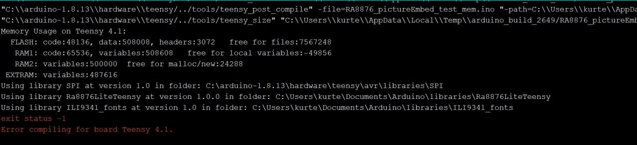

I have an RA8876... test sketch that did a picture embed. That compiled fine with PROGMEM defined, but if as I have now, commented that out, it errors out the build.
I did the compute for free stack space using int32_t and return -1 from program if it is <= 0
Note: I printed out the value using %d so it shows the minus number.
Wondering if I should do the same for Free for files and free for malloc as well?

Decided to go ahead and check the other two regions as well and error out.
Also print out message... Feel free to change anything :D

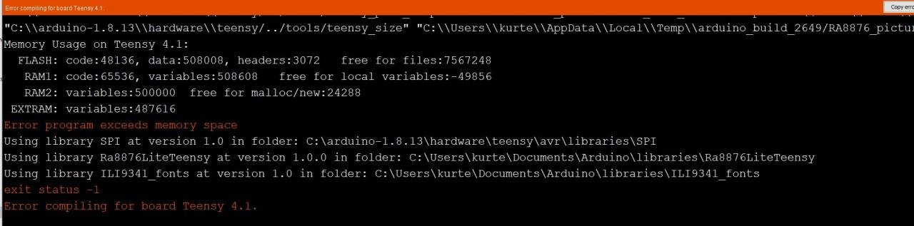

When there is an error to result in a '-1' exit - the text "teensy_size: " should NOT be printed on the Error line so it gets proper color coding.
Did PR to have ERRORS get highlighted in console:
		char *prefix = "teensy_size: ";
		if ((free_flash < 0) || (free_for_local <= 0) || (free_for_malloc < 0)) {
			retval = -1;
			prefix = "";
Would be better to highlight just the error line - but that is more change with selective prefix.

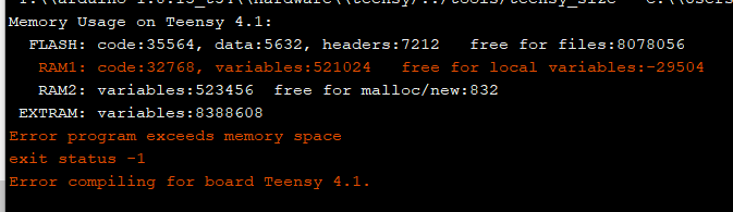

When I abuse the buf's to:
EXTMEM char buf[8 * 1024 * 1024];
DMAMEM char bufX[495 * 1024];
char bufY[495 * 1024];
Memory Usage on Teensy 4.1:
  FLASH: code:35564, data:5632, headers:7212   free for files:8078056
   RAM1: code:32768, variables:521024   free for local variables:-29504
   RAM2: variables:523456  free for malloc/new:832
 EXTRAM: variables:8388608
Error program exceeds memory space
exit status -1
Error compiling for board Teensy 4.1.
Above says I have 832 bytes free in RAM2, adding 832 shows ZERO free.
This result when going to :: DMAMEM char bufX[495 * 1024 + 833];
