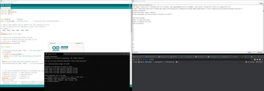

Ok, it seems there is a bug somewhere.
I tried the standard Ethernet Webserver demo and it works with both versions, but the moment I ask to load the file from the SD card it works with TeensyDuino 1.53 but not with 1.54.
I prepared this basic sketch based on the Ethernet Webserver demo but modified it to load a file from the SD card and a file.htm that needs to be placed in the SD card to be read.
I loaded the files here: https://github.com/lorenzofattori/TeensySDbug
If you take this .ino file and compile it with Arduino 1.8.13 with Teensyduino 1.53, then take the file.htm and copy on an SD card and stick it in Teensy 3.6, the webpage loads correctly (see https://github.com/lorenzofattori/TeensySDbug/blob/main/153-webserver-Loading.png?raw=true)
If you do the same with Arduino 1.8.15 with Teensyduino 1.54, the webpage does not load (see https://github.com/lorenzofattori/TeensySDbug/blob/main/154-webserver-notLoading.png?raw=true )
Some Info:
- I am using Teensy 3.6 with the configuration seen in the screenshots
- I am using the WIZ850io Ethernet module, please note in the code I'm using different CS and SCK pins due to my hardware PCB, adjust them as necessary for your board.
- I am using a direct connection between my PC and the WIZ module, with IP address of the Teensy set to 2.0.0.100, you can change this to meet your needs.
- I am using a 2GB SanDisk card in the built-in SD connector of Teensy 3.6
- I am using Windows 10 with Arduino Portable (so I can easily switch and upgrade between versions)
- The page does NOT load when using Arduino 1.8.15 with Teensyduino 1.54
- The page does load when using Arduino 1.8.13 with Teensyduino 1.53
I hope this information is enough for you to try and see if you can find out if it's a user error or what.
If you need any extra info please let me know.
Thank you in advance!

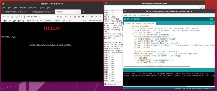

I ran your program here. I could not get it to work on either Arduino 1.8.13 + Teensyduino 1.53 or Arduino 1.8.15 + Teensyduino 1.54.
The main problem is the "while (client.connected()) {" loop. The browser doesn't disconnect, and it doesn't recognize the response as complete, so it just sits forever waiting.
Just adding a "break" at the end of transmitting the data makes it work on both versions.
I also changed the file read & write to this, which can confirm the data really is being read from the SD card if you uncomment 2 lines:
            while (webFile.available()) {
              int n = webFile.read();
              //Serial.print(".");
              //Serial.println((char)n);
              client.write(n); // send web page to client
Here is a screenshot of it working with Arduino 1.8.15 + Teensyduino 1.54.

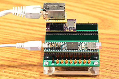

I did have to change the IP number, and I commented out "SPI.setSCK(14);" since I tested with a WIZ820 adapter and Wiz850io ethernet module.
Here's a photo of the hardware I used for this test.

I see the contents of file.htm printing to the serial monitor in your screenshot, so I'm pretty sure the SD library is correctly reading that file.
Which browser are you using? What version? I could start up Windows 10 here and give it another quick try...
