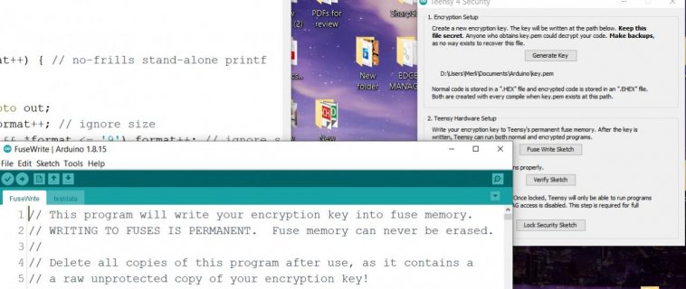

To access the new features for Lockable Teensy, in Arduino click Tools > Teensy 4 Security. It will open this new window.
While I haven't written any proper documentation yet, hopefully the info on this window can explain how it's meant to work.
Standard Teensy 4.0 made after June 2021 can also run encrypted programs, but the final secure lock mode can't be set. Running encrypted programs that way is akin to locking your door but leaving the window open. Still, might be worth trying. Anyone can open this window, create their own key.pem file, and get .EHEX files created.
At this moment 5 people have beta test Lockable Teensy 4.0 boards. If things go well over the next few weeks, we'll probably open up the Lockable Teensy beta hardware to more people.
