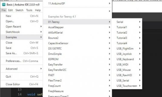

2) Teensy Specific Examples: I opened up an issue awhile ago on this: https://github.com/arduino/arduino-ide/issues/869
The Arduino way to do this would be to add Library: example _Teensy to the install,
and then have either dummy header file or dummy header file under src and library properties and add the examples under this. This is how for example ESP32 does it, like wise others like OpenCM, OpenCR,
Although I don't see them there for the Arduino installed boards, like SAM, SAMD...
Note: I hacked it up with this beta, but not showing up yet, as the menu is probably cached... Will try workaround mentioned
in comment in a different issue: https://github.com/arduino/arduino-ide/issues/1030
Of deleting the cache directory
Here is a version that I have put into my install of RC8... Beta4...
I have the directory: C:\Users\kurte\AppData\Local\Arduino15\packages\teensy\hardware\avr\1.57.0-beta4\libraries\01.Teensy
And so it shows up now like:
Note: I renamed all of the .pde files to .ino in this zip file
  • 01.Teensy.zip

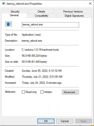

Can you check if it has a valid digital signature (as far as your version of Windows believes)?
I don't have a Windows machine set up right now, but as I recall the process goes something like right click on the EXE file and select properties. Then in the window, look for a signature tab. Inside that tab should be info about the signature and which algorithm it uses. It should be SHA256 (the signature on the main installer EXE should have both SHA256 and SHA1). It should also have timestamp info about when it was signed (the timestamp is a crpyographically signed verification of the time). There should also be a button to get more info about the certificate. Somewhere it should say who issued the cert (ought to say Sectigo or Commodo - the companies Microsoft trusts) and in that info the cert should say PJRC is the author. In there should also be info about how long until we have to pay again for them to rubber stamp reissue the cert... I believe it's not until early 2014. But the crypto timestamp stuff is supposed to allow Windows to keep trusting the signature even after PJRC's cert expires.
I checked all this stuff a few days ago on Windows 10. But I don't have a Windows 11 machine.

Digital signatures:
So far on my machine it does not look like teensy_secure has one?
But others do:
Teensy.exe - yes
teensy_gateway - yes
teensy_ports - yes
teensy_post_compile - yes
teensy_reboot - yes
teensy_restart - yes
teensy_secure - NO
teensy_serialmon - yes
teensy_size - yes

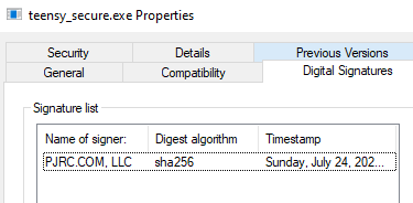

Can you drop a copy here and I can see if MalwareBytes approves of it now?
I've rebuilt the Windows installer. The new build should be identical, except teensy_secure.exe is now signed (sha256 only). The installer from Wednesday was 91871992 bytes. Today's copy is 91873016 bytes.
I didn't rework the IDE 2.0 package. To play with teensy_secure.exe on IDE2, just install into a copy of Arduino 1.8.19, then grab teensy_secure.exe from C:\Program Files (x86)\Arduino\hareware\tools. (or whereever your 1.8.19 is located if not the default place)

Put the teensy_secure.exe in a scanned directory, confirmed it is signed, MalwareBytes approved of it:
However, when executing it then triggers on its real time operation testing?
So, so back to blocking scan of that %appdata% teensy-tools folder :(
> IDE 1.8.19 in an unzipped folder "D:\T_Drive\arduino-1.8.19\hardware\tools" does not trigger the quarantine, and that folder is not on an exclude from scan exception.
It seems the RansomeWare programs were found abusing %appdata% so it gets special protection/attention.
